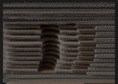

This is the sort of thing that at least some of my walls are made of ... although i am going off a quick glance when a spark was making a vertical hole to thread a cable through some 12+ months ago
So photo is not of your wall ? Very unhelpful .

A photo of your wall with a hole in it would be more helpful .

5) i don't want to make a hole as i had it decorated once the spark had finished but it's the same as the pic. Why would a pic in situ show anything different?
