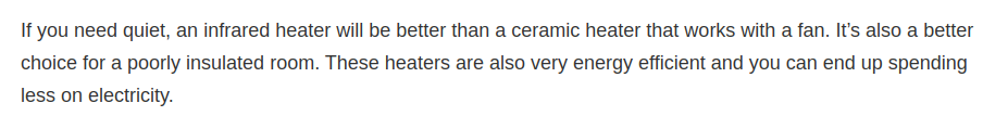

Plus it's not just Good Housekeeping. i've just found a number of other saying similar, e.g.
Please note the citation: "also very energy efficient and you can end up spending less on lecy".

Is Good Housekeeping completely independent, or are they supported by advertising, is the first question you need to be asking.
As has been pointed out to you, they are not, and cannot possibly be more energy efficient and it is very unfair, to compare them to ceramic heaters, which are yet another scam. The one valid point, is that IR is more useful in a poorly insulated space, but only providing you place yourself in the IR beam. Move out of the beam, and you may find it cold.
