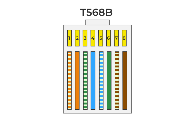

I assume you have the correct wiring instructions

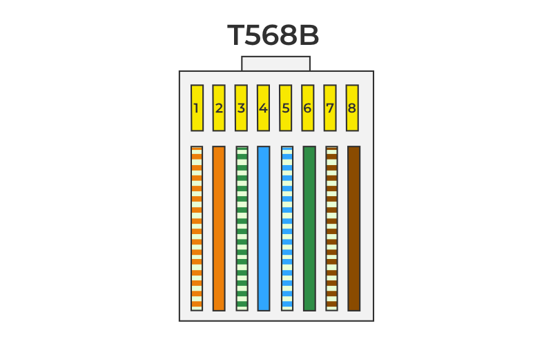

I assume you have the correct wiring instructionsView attachment 358037
I assume you didn't try to strip the wires and you cut them all to the same length

Yes I followed the same diagram, that's not to say it didn't take numerous attempts to get it to work. Stripped outer sleeve, uncoiled the 8 cables but kept them in pairs then proceeded to rearrange to the configuration shown. I cut the ends square parralel and fed them into the connector. Crimped and cut excess off with the crimper tool, which I must say at £12 is carp, but what can I expect...

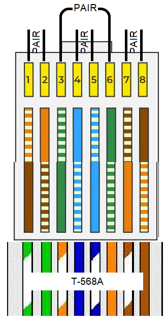

You said you followed the T568B wiring to a tee, but just wanted to make sure which way round the plug was- you should have the gold contacts facing you.. upload a clear picture of your plug so we can see the wire colours through the plastic?
It won't matter if the termination was done with the plug inverted, as long as both were done the same, there's not enough difference between the orage and brown pair to make a difference, I've seen many many cables wired like the middle part where all I've done is flip that part of the drawing and for completeness, at the bottom I show T-568A which would also not have made a difference as long as both ends are the same:
