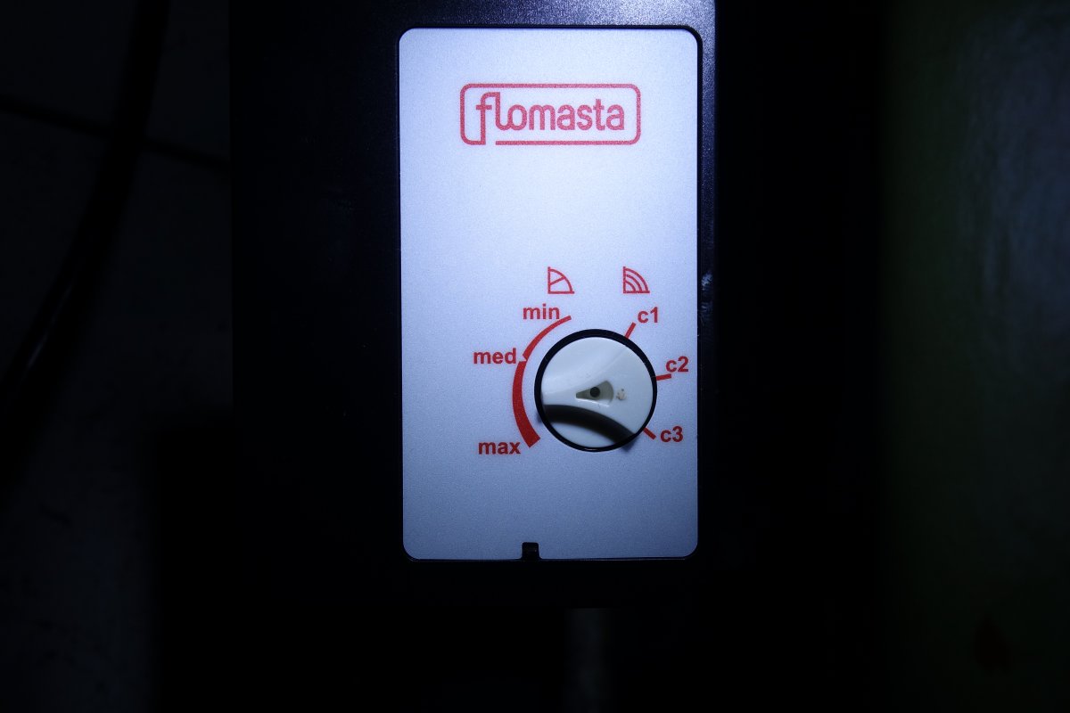

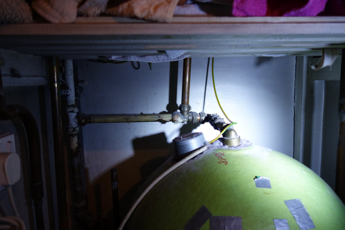

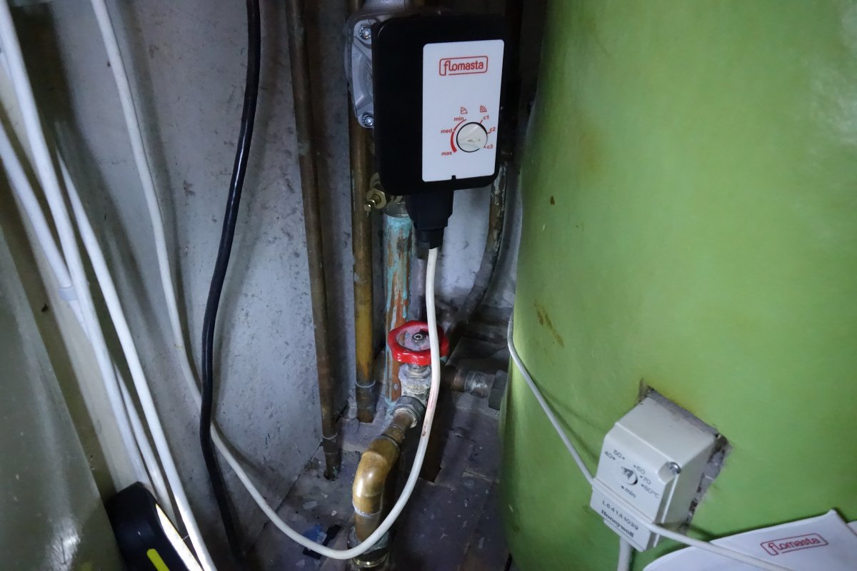

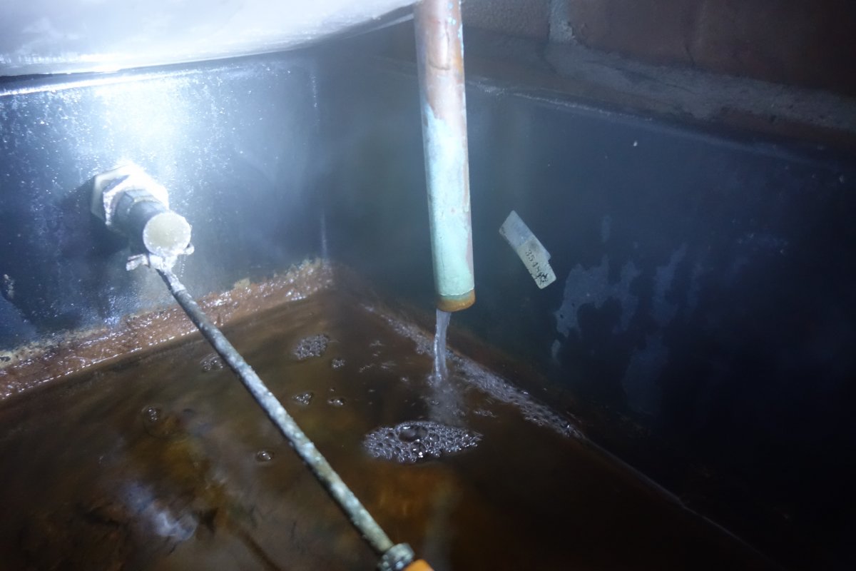

For those new to the saga, a plumber fitted a new pump to my system in August and (probably) since then, hot water has been circulating through the feed and expansion tank at a fast rate (one pint a minute). Magnet tests show iron deposits in some of the pipes, and the designated feed pipe at the boiler being cooler than the return pipe (i.e the pipe with the Fennox filter) suggests the pump had been fitted the wrong way round. On advice received here I turned the pump down to between low and medium, sufficient to stop the drainage into the feed and expansion tank.
The plumber who fitted the pump in August called this morning. He is insistent he fitted the pump the right way round, and says it will only fit one way (the right way). I showed him the tests I had done with the magnet and the designated feed pipe being cool compared with the return pipe. He thought the cause was sludge in the system. He opened the Fennox filter and showed me it was seriously caked with sediment. That sediment had accumulated in the four months since the last service. He put some powerful cleaner into the system and drained it (hose attached to an outlet by the hall radiator). He advised me to phone the firm this afternoon to arrange for the radiators to be individually removed and flushed (this was done about five years ago). He said the alternative was replacing all the radiators (which were in the house when I bought it in 1987) but he thought they looked solid and don't leak, so we agreed replacing them would be overkill....at least until we've tried flushing. He reset the pump speed to medium.
This all sounds like a good plan, but....I've just switched on the boiler and found hot water is draining into the feed and expansion tank even faster than before. I've measured it at 2 pints every 3 minutes. I would value opinions on this. Is this a consequence of the clean he has just performed....guessing wildly here...could it be the cleaner has dislodged sediment which has settled somewhere else, causing another (and perhaps worse) blockage? Or is it normal for this draining into the feed and expansion tank to occur immediately after a clean? And should I leave everything as is until the plumber returns to do the complete system flush, or should I immediately turn the pump speed down again to stop this draining?

We have told you what the problem is and what needs to be done.
Also that the fault will have caused a lot of sludge in the system.
You should make a formal complaint to the firm, ask them to correct the pump and to power flush that system all at no cost to you.

You don't need any other explanation other than that the pump is fitted the wrong way round!

Those who contributed to this thread might be interested to know its resolution. The second plumber/installer has just left. It took him ten seconds to determine that the first plumber, as Tony and others diagnosed, had in fact installed the pump the wrong way. All he did today was feel the pipes above and below the pump and twiddle the speed knob and listen for the back pumping, and pronounced judgment instantly. All fixed now (without charge of course) and the house is heating up again. I think the first plumber is likely to be on the end of a rollicking, not so much for doing the job wrong, but for insisting he'd done it right after a second visit. I'm told the system ought to be cleaned out but it's not so clogged as to need immediate action, and can be left till spring. It looks like I have every right to demand these people do that gratis but at the moment I'm feeling inclined to cut my losses and look for a new plumbing firm...preferably a one man company so I know I'll be getting a man who's proved himself. I've got a few months to think about it. Once again, thanks to Tony and other contributors for accurate diagnosis and teaching me some of the mysteries of hot water systems :cool:
