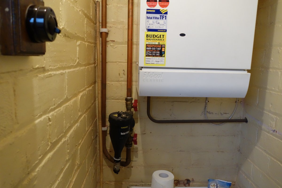

Hi Tony, the boiler is an Ideal Classic FF250, top and bottom pictured below. Is it possible to tell me from these pics which pipe should be hotter than which other pipe?
Pipe on right is flow, and should be hotter than return on left.
Like the light switch!
It's definitely the other round! With the boiler audibly going, I can keep my hand comfortably on the right hand pipe but the left hand pipe is scorching hot. What does this mean?
I like the light switch too, though it probably should have been replaced at the last rewire.
Means that the pump is fitted backwards!

Thanks very much for this Tony! It was quite a young person who did the job. I'm glad I delayed phoning now. I'll call the plumber tomorrow...I won't mention the deposits in the pipes until they've corrected their installation of the pump.
