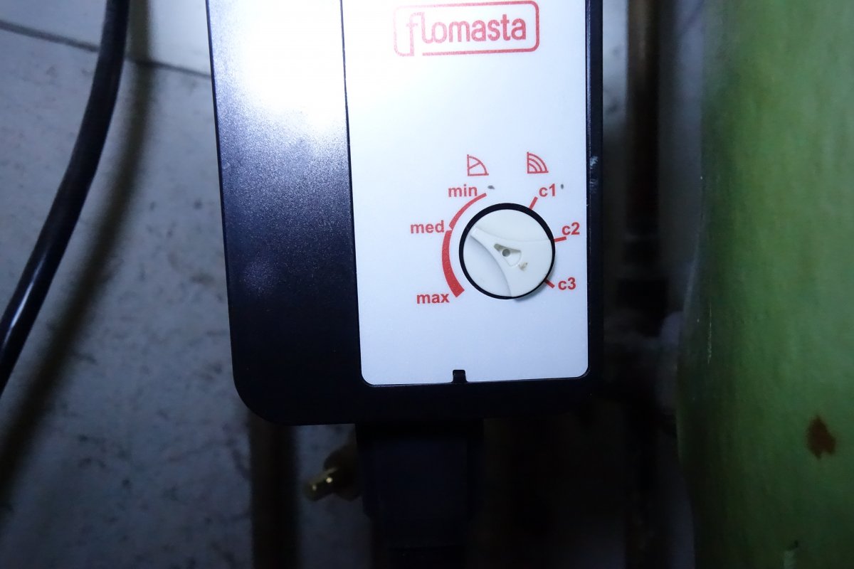

Thanks Steelmasons....and I've just found something else on the internet; one of the manifestations of the pump being set too fast is air build up in the radiators. Last week I noticed one of the downstairs radiators was tepid and when I bled it it was hissing air for about five minutes, so there was more air than water in it. If someone could look the photo of the pump above and comment on the speed the installer has set it to I would be grateful. I am not touching it without advice :D

try the pump on "med" and see if that helps.

JohnD this is looking positive! I turned the pump setting to medium and although there is still hot water draining into the expansion the rate is far less....not much more than a trickle...I'll keep an eye on it and find the magnet tomorrow...think I know where it is. Answer to your question is no, I can not do simple plumbing :cool: so will certainly get someone in if required.

Turn the pump speed down more until it stops pumping over.

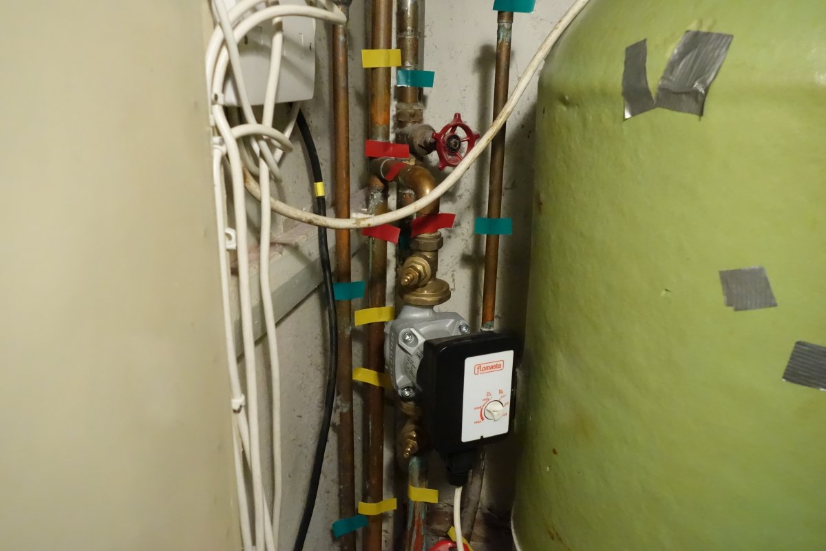

I've followed the advice of JohnD and others and done some investigations with a magnet. It seems to bear out the suspicion that there is a blockage in the system caused by iron deposits, which will require the services of a plumber. I'll describe what I did. I would be grateful if someone could read and confirm it does look like a blockage. It's a longish post but with pictures to relieve the tedium...
First, I put the heating on for an hour and felt the radiators. This was with the pump turned down to the medium setting. Even though the boiler is on maximum, radiators are warm (better than tepid) rather than hot; I am guessing this is the result of the lower pump setting. However, of the two main downstairs radiators one was barely even tepid. Neither of these radiators had any air in them.
Next, I nudged the pump speed down to a level where the pumping over ceased. This was just below the medium setting, as photo.

Next, the airing cupboard. Here, there were pipes where the magnet stuck. In the following photos I have used colour coded sticky tape:
Green tape: magnet didn't stick at all.
Yellow tape: magnet stuck but not strongly.
Red tape: magnet stuck strongly.

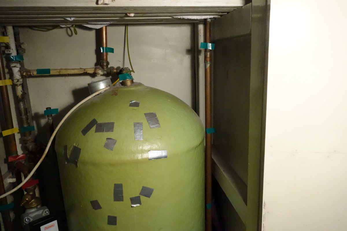

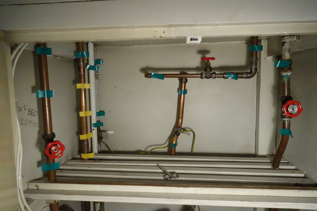

First, the top of the airing cupboard:
- all OK apart from that pipe on the left, which runs down to the pump (via a T-junction).
Next, the right hand side of the airing cupboard (ignore the left hand side of the photo): all OK here:
But looking at the left hand of the boiler, where the pump is, in the next two photos:
-there is lots of red and yellow tape, especially round the pump, also the pipe that goes into the bottom of the cylinder, and the piping around a box marked 'Honeywell Sundial diverter valve' that leads into the middle of the cylinder.
That's it. Looks to me like I have a number of separate blockages. Can someone please confirm :cool:
