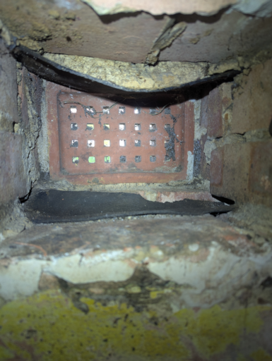

Hiya, I was doing some work in my kitchen and behind a cabinet was the air brick below.
(small semi detached cavity wall house from 40s/50s)
Q1) in the pic below, the cavity surrounding the air brick appears to have been intentionally closed on all sides - forming a sort of air tunnel into the kitchen -
I assume this was done to ventilate the room?
This property used to have a gas fire and back boiler downstairs.
Q2) this air tunnel is, I assume, creating a good bridge between inner and outer skins, increasing moisture in the inner skin etc...
Should I get rid of tunnel, separating the inner and outer skins of brick work? (My gut feeling is yes, I was wondering if I had overlooked something)
Q3) is it normal for the cavity to be full of rubble?
Will
Sorry I should have answered no to question 2 as woody has. It should not be constructed of absorbent materials so cannot bridge the cavity with moisture. Plus in your case you apear to have cavity wall insuation so unless you had a hose pipe directed straight at it then no moisture is likely to get in it. As far as blocking it up then you may start to get condensation mould behind the cupboards if you restrict the airflow. If it isn't causing a problem then leave well alone
Open vented fires, and air burning appliances, needed some ventilation back in the day. If that need has been done away with, so can the vents. I blocked most of mine up, on both the inner, and outer leaf, years ago - they can be very wasteful of heat.
Sometimes, and if it builds up, it can cause damp issues. Best cleared out, which usually involves removing three bricks in a triangle, of the outside wall, to get access, the dig and scrap the rubble out, at regular intervals along the wall.
Thanks every body,
I deleted the thermal bridge and removed as much rubble as a I could
