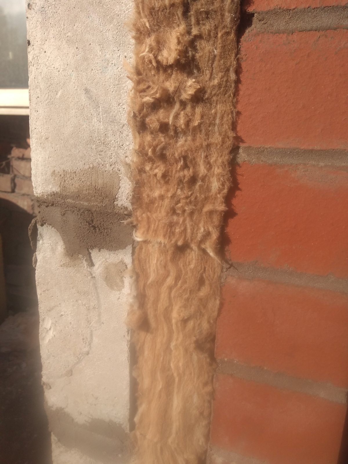

So you should not build the outer skin of bwk all the way
up to lintel level before building up the inn
er leaf of blockwork
Nonsense. We build up to lintel bearing and its all we have ever done.
Twin skin blockwork can be a bit less obedient, so you need to tread a little more carefully.
You don't follow NHBC Standards then - quote from NHBC re external cavity wall construction - 'The difference in heights between the two leaves of a cavity wall under construction can be up to 6 block courses ', just saying.
It depends if they are sensible or beneficial. Some of the Robust Details stuff overlaps B'regs so I use what ever method gives the best results. But generally speaking I follow Building Reg's as laid out by Architects/designers etc and enforced by BC.
Fair enough ( a courteous response)(y)
