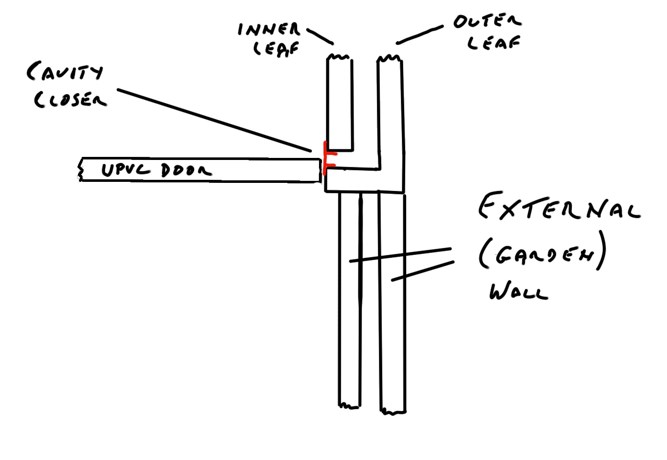

Hi Guys,
I tried to explain this but figured a picture was better. Is this the right way to do this?
Why have you got a cavity garden wall?
Because its above an existing cavity wall on the garage thus its actually a parapet wall and the inner leaf will form the side of a flat roof.
Use Expansion joint between garden wall leaves and outer leaf. Dont try and tie or mortar in
