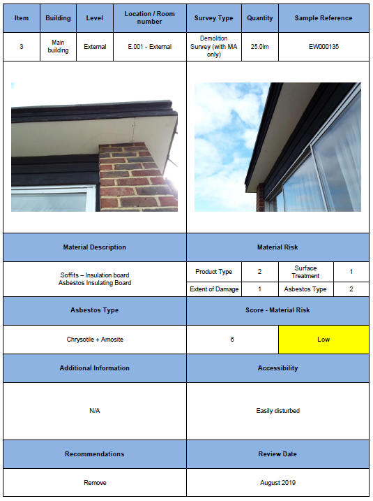

WHOA THERE! Asbestos Insulation Board? That changes everything. That is a licensed job and needs the full space suit malarkey.
Very unusual to have insulation board on the soffits though. It is usually used internally where there is a fire protection issue such as a ceiling to an integral garage.

This is the section of the report with photo.
Just goes to show you can never assume anything. Good job you had it tested.
