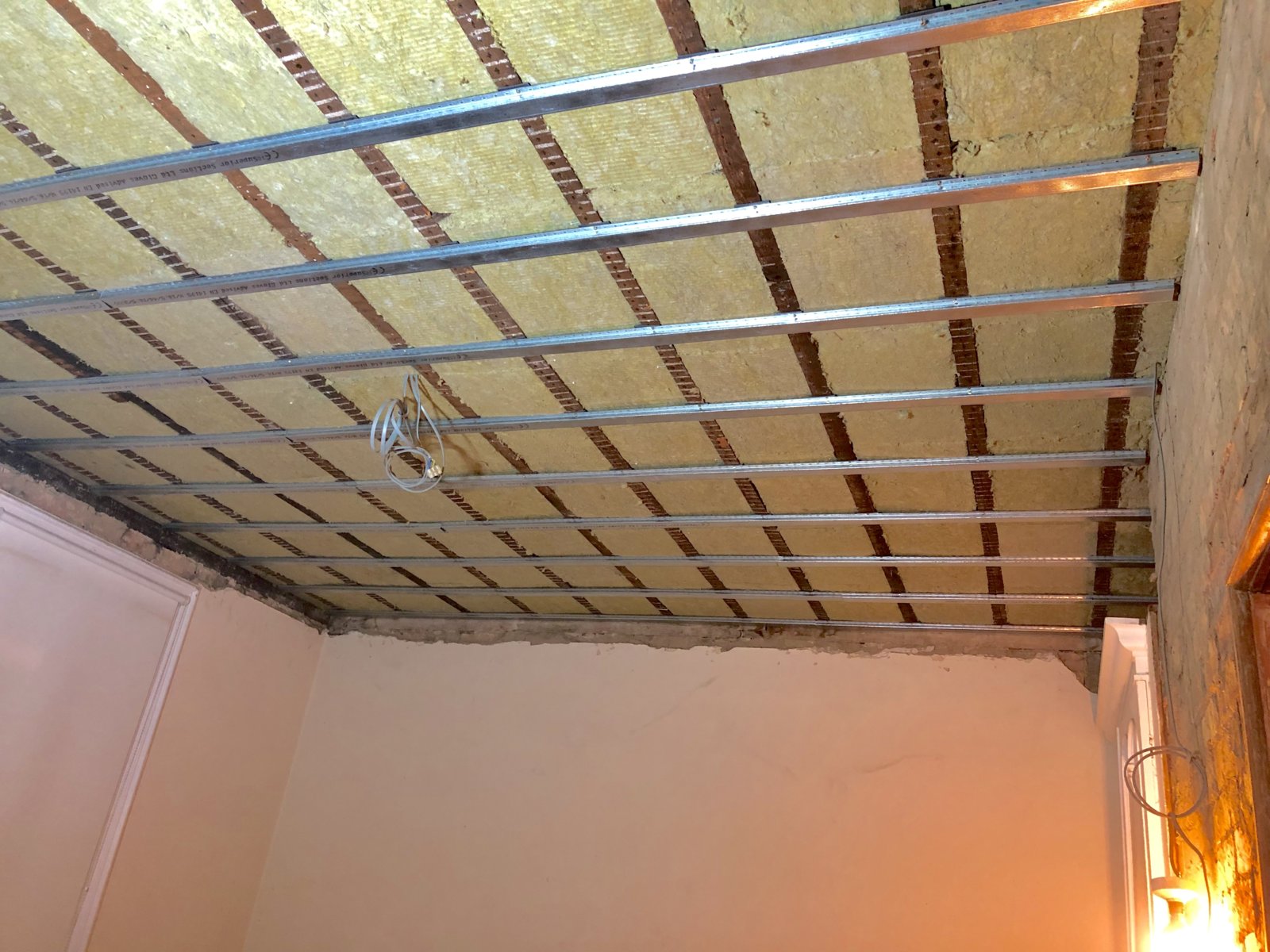

Quick progress update (progress being slow due to only being able to work in the evenings!)

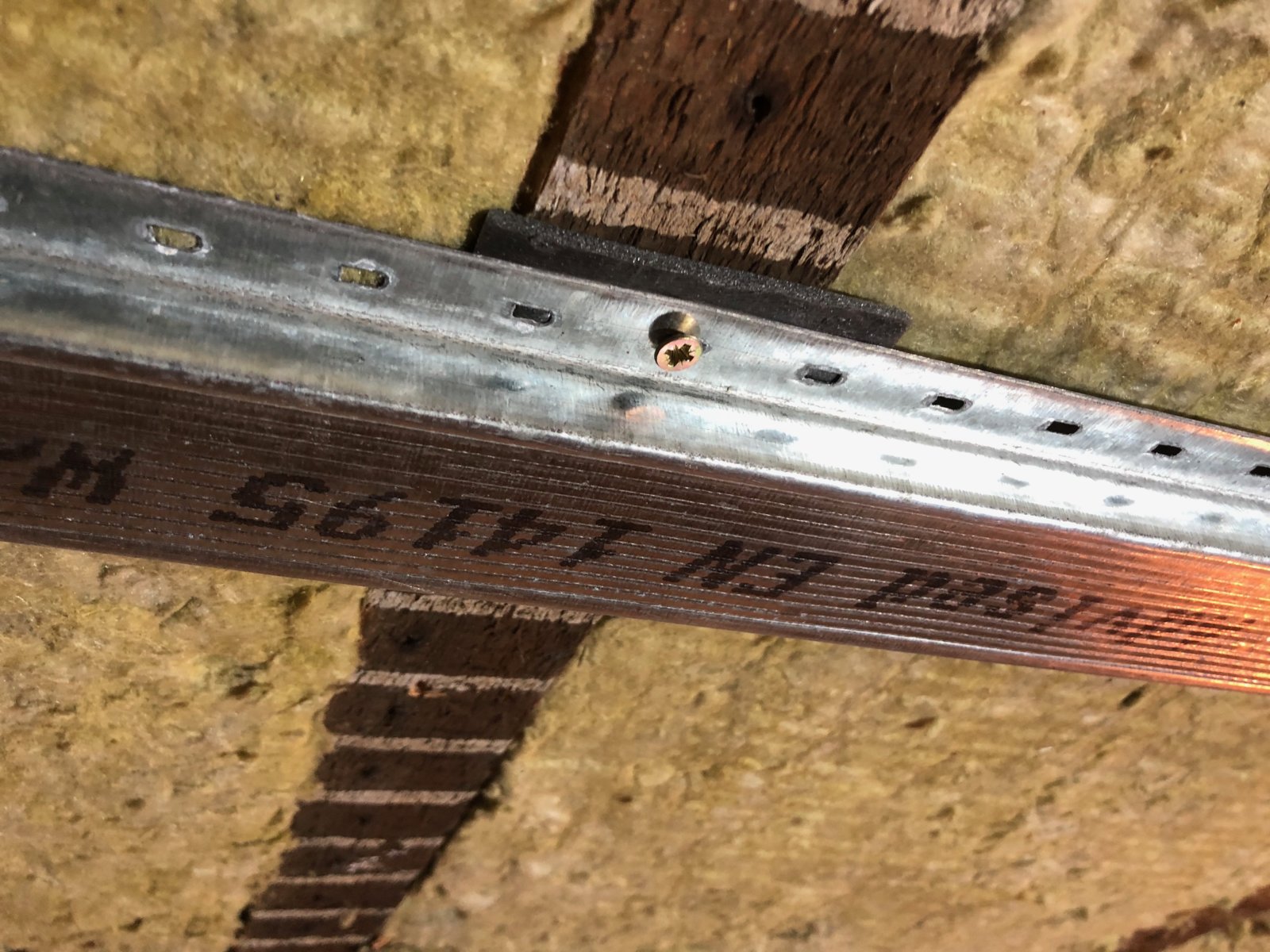

I started the resilient bar install after the 100mm of RW3 insulation between the ceiling joists. I opted for the acoustic foam between the bar & bottom of the joist. Luckily the foam is self adhesive but it still takes a bit of time to mark the bar with the joist positions and stick the foam on before screwing up the bar.
As mentioned by another poster, the resulting extra impact noise reduction might be minimal but every little helps. Even though there is a screw directly into the joist, the foam will hopefully have a damping effect and reduce it vs directly touching the bottom of the joist.
Even though the plasterboard isn't on yet, the room is already noticeably warmer & certainly can't hear as much airborne noise!
Next job is to sort out plasterboard, current plan is either 12.5mm+15mm Soundbloc at a combined 23.2 kg/m2 or the same thickness in Knauf Soundshield which combined is slightly more mass at 25.8 kg/m2. I'll probably ditch the mass loaded vinyl between plasterboard sheets having done the acoustic foam now.

I have done a similar project (looks almost the same with your picture) in my relevantly low ceiling bedroom to insulate from the above flat's living room. After, attaching the resilient bars:
I also added isolation tape under along each resilient bar:
https://www.insulationshop.co/50mm_acoustic_isolating_strip.html

If you could go for double plasterboard with a rubber sheet sandwiched between that would be better. If you could cross-fit the two plasterboard layers with the rubber mat overlapping the joints, that would be even better.
PS: later on, when they did some renovation on the flat above, I asked them to install an airborne and impact soundproof rubber underlay under their new carpet and share the cost. The results were amazing!! Never had a noise problem even in the complete silence of the night...My only concern is the load on the ceiling joists since lot of weight was added on both sides...that is why i did not go for double acoustic plasterboard...
