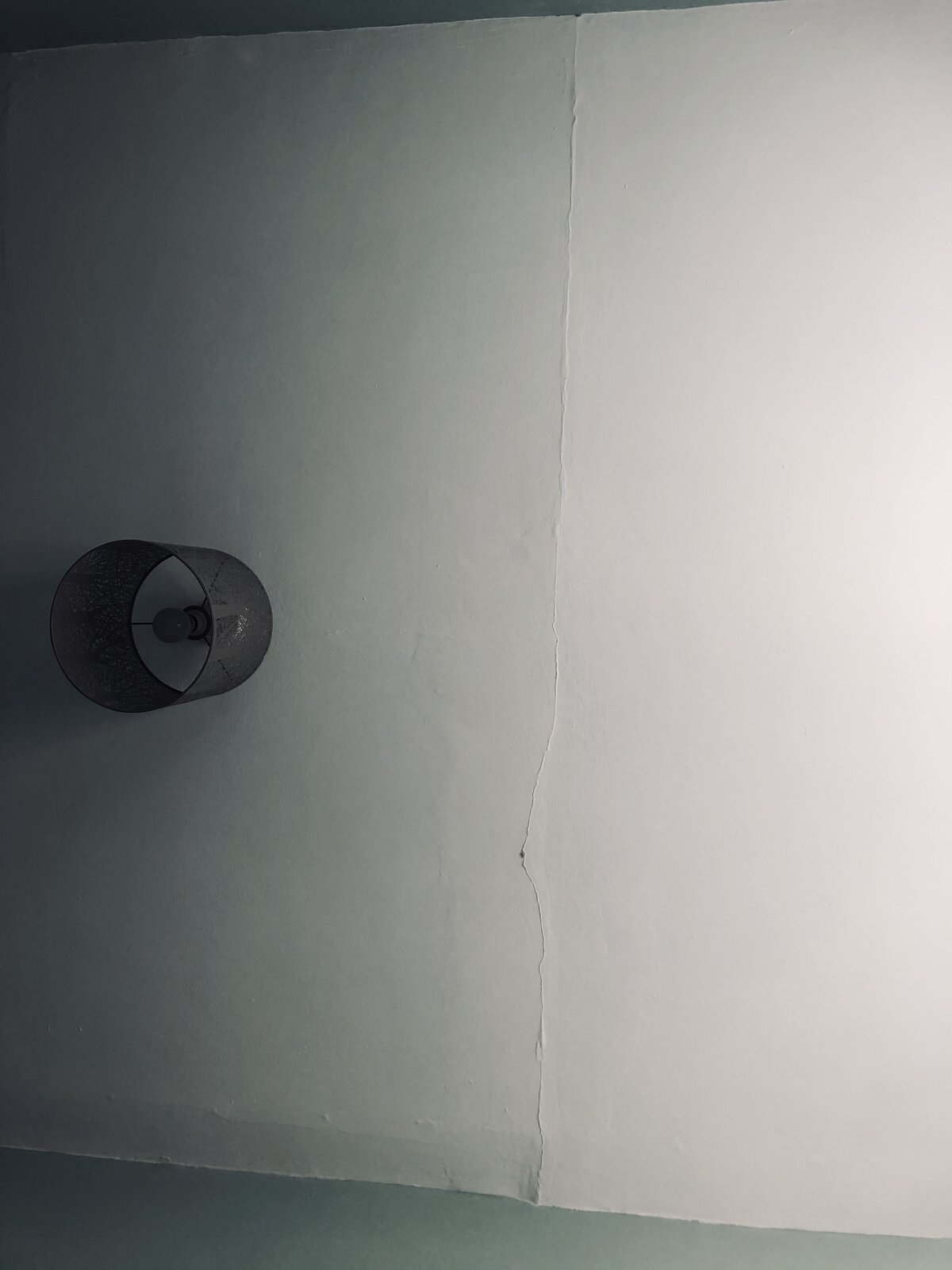

Hi
Does anyone know what may be causing and how I can remedy the ceiling crack in a bedroom? In case helpful, It’s a flat roof
Jaynay, good evening.
Nice straight line, it is a joint between two plasterboard ceiling boards.
Remedy? apply a skim of plaster to the entire ceiling?
Or,
Apply a thick lining paper, not as good as above but will "mask" the worst effects of the crack.
Or, carefully rake / cut out the crack with a Stanley knife or similar, take your time and re-fill the joint.
