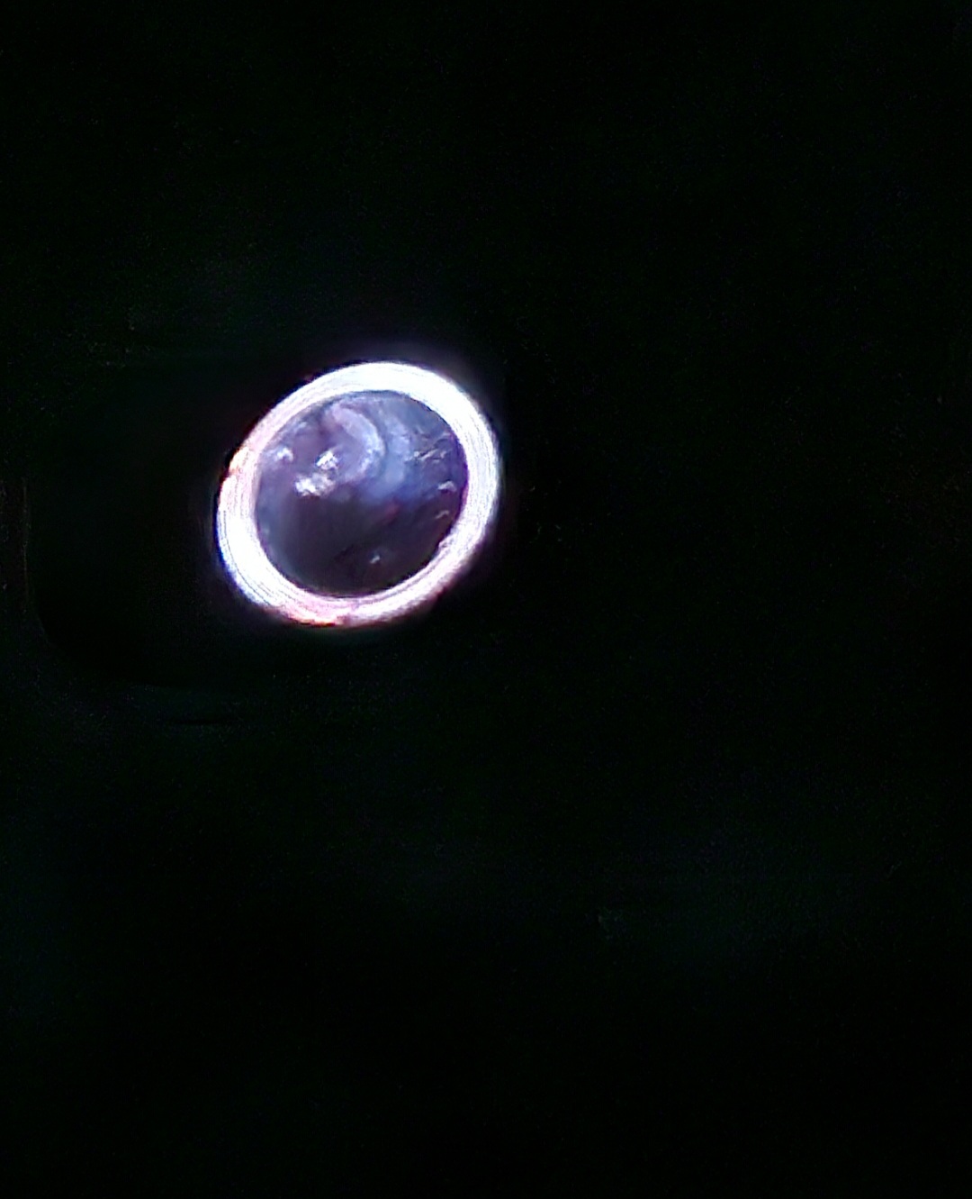

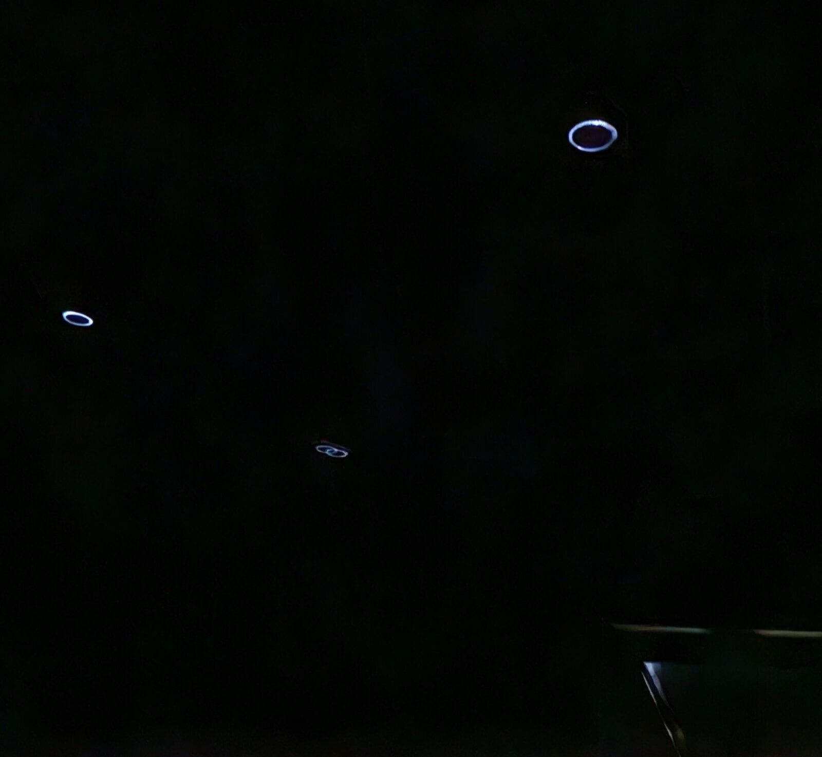

Hello.
The bulbs are 20 years old, so I thought they would be the old halogen types.
I've added a photo of how the bulbs shone this morning in darkness.
Only 3 lit up this time out of the 4 and were not as bright as they can often be.
I can check a couple of hours later and they aren't shining at all, then check again a few hours later and they'll be even brighter than before.
Bearing in mind the lights will never come on fully.

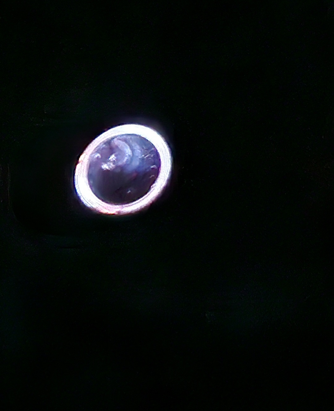

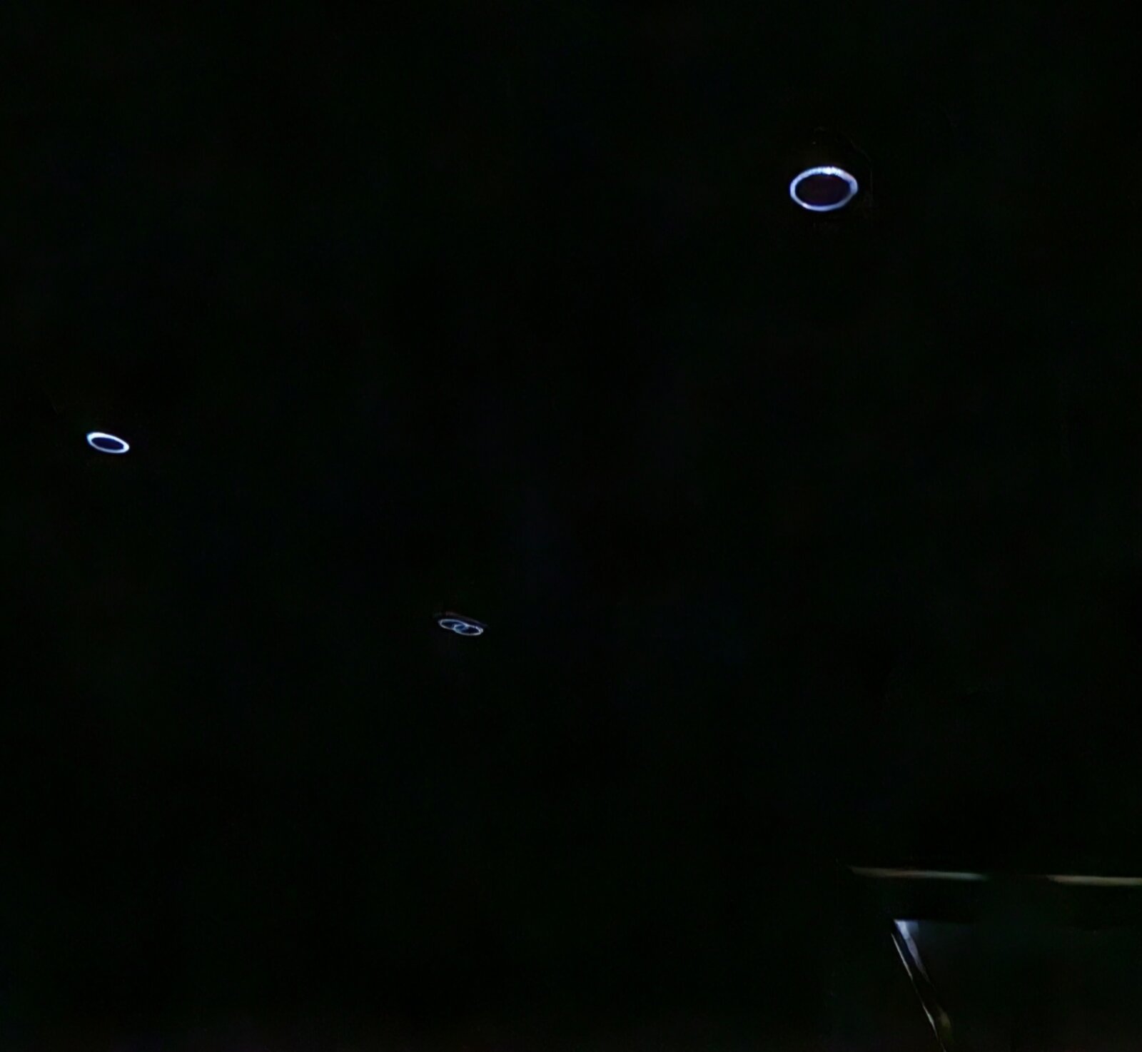

If the lights are not on the lighting circuit, then they could perhaps be on the upstair ring main. You could try turning that off, and if that doesn't work, turn the entire house supply off - but, flameport makes a good point above, might it be daylight leaking through? Are they equally bright, after dark?
It's daylight leaking through from behind.
Just as it's doing at the corner of the window blind.
Since the "Blue Glow" is coming from the glass "edges"
(and not from the centre where the filament is)
this seems very likely.

Hello. I'm not sure.
There seemed to be light in the inner bulb part too.
To be honest I am wondering how so much daylight could be coming in without being accompanied by rainwater.
