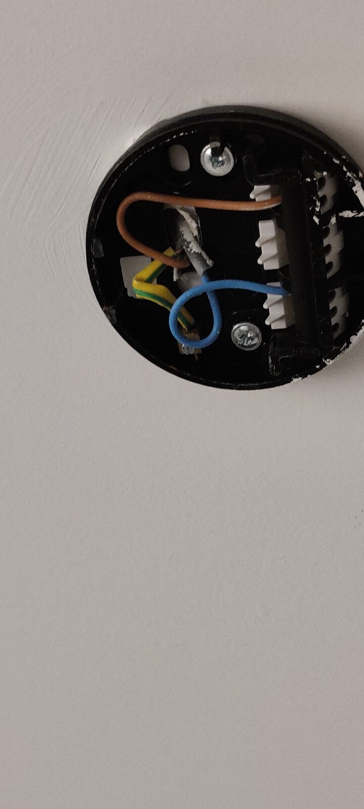

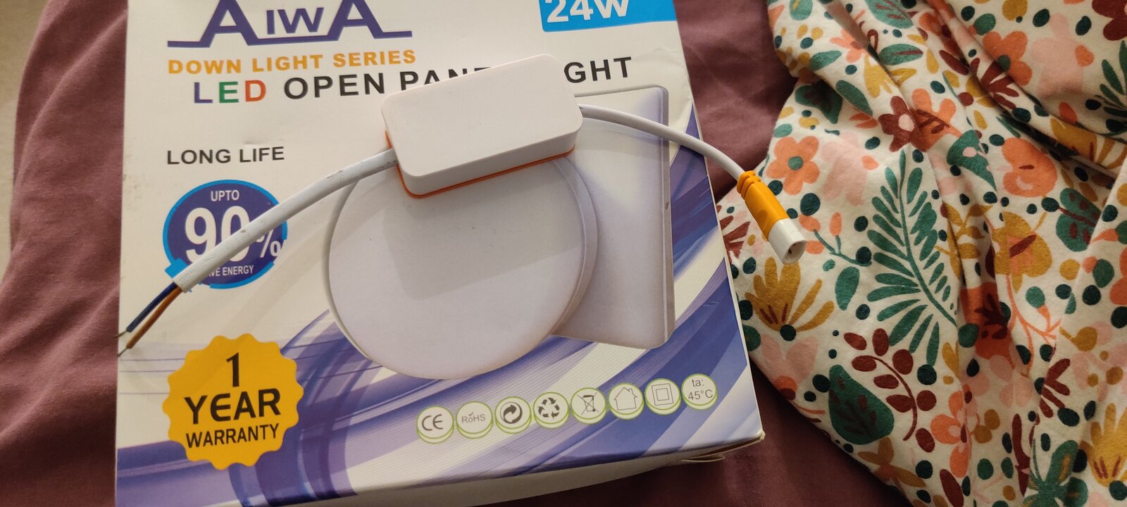

Hi, I have bought an LED ceiling light. Noted that it has no connection space for Earthing? Although it says on the box that it is shock proof and vibration proof and also has a DC connector I guess. The earth connection is available though, do I need to do anything with that ? A little help is appreciated. Thanks

Just connect brown to brown and blue to blue. Tighten screw in earth connector if it is loose.
