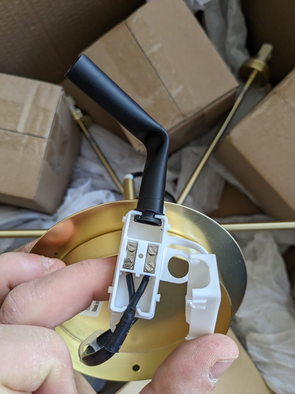

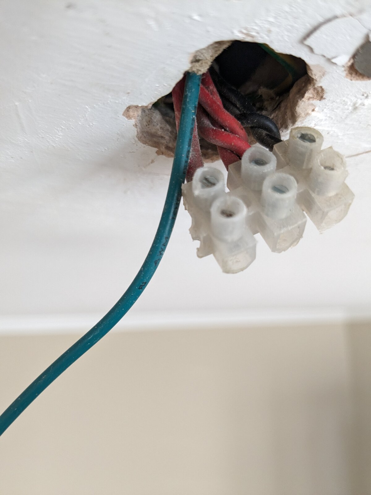

I'm fitting a ceiling light. Having removed the old one, there are two red wires and a black one coming into a box, then an earth.
The light i am fitting only has a brown and blue connections (but no wire). It says it doesn't need an earth.
The previous light fitting had a brown and blue wire coming off it, connected to one of the reds and the black. With the earth hooped around the light fitting itself.
How do I make the two work together?
I am thinking...
- terminate the earth with a bit of connector box
- get some extra wire, and connect the ceiling box into the connections on the light in the same configuration as the old light
Any advice really appreciated!

Fitting a suitable junction box ,that can sit above the ceiling , to house the wiring connections, and run from that a two core flex to the light fitting would be one option.

I'm talking about the wires coming from the ceiling and the light I have. There is just one light.
So, I think you've answered that. Run a two core flex from the box.
But what do I do with the earth wire?
The earth conductor would be terminated in its own terminal within a suitable junction box , along with the other conductors in their respective terminals, Your pic is not of a junction box by the way, that is just a terminal block which can NOT be just shoved up into the ceiling.
If the junction box is not accessible it must be a maintenance free junction box .
