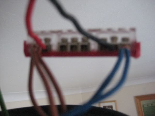

I've just returned home to find my living room ceiling light had fallen to the floor. I have re connected the wires as I though they go back but the light does not work.
Below is a picture of how the light is currently wired up.
Can anyone tell me what I have done wrong!
Does the live have to go to one of the three middle terminals labelled loop?
Any help gratefully received
Thank you
Never heard of a ceiling rose falling down, but can't tell anything from the pic. Zoom out so we can see where they go to
Could'nt believe it when I walked in the room either, its been up two years.
Theres 3 blue, 3 brown and a earth cable coming from the light
From the ceiling there is a red, black and earth.
The 3 brown cables from the light go to a positive terminal, next to this is the red cable from the ceiling.
The 3 blue cables from the light go to a negative terminal, next to this is the black cable from the ceiling.
This leaves 3 unused terminal blocks labblled loop
are ytou sure the filaments on the lamps are ok?
there may be a joint in the ceiling on the red /black cable and something may have loosened there
The filaments on the lamps are ok.
I have wired another lamp as above but that does not work aswell.
