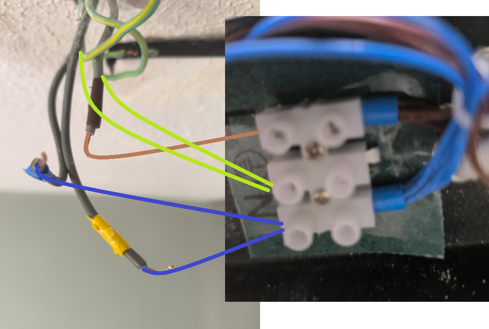

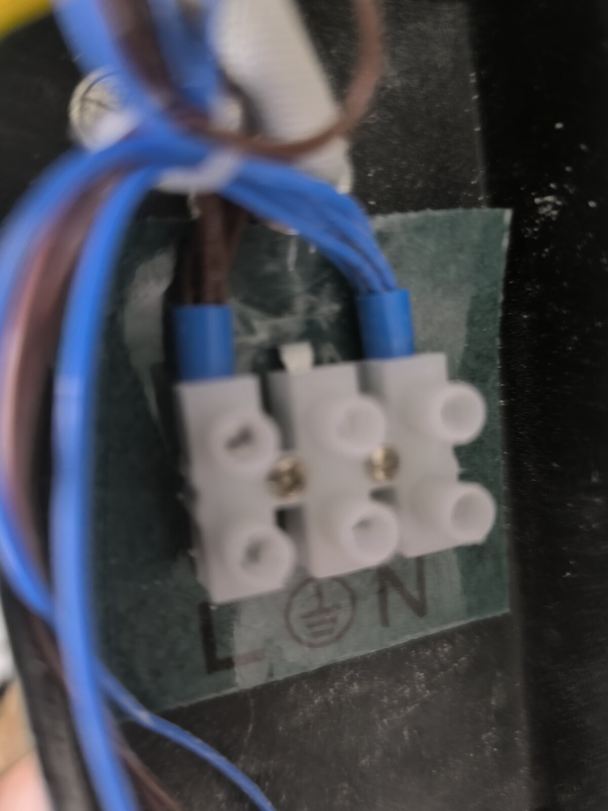

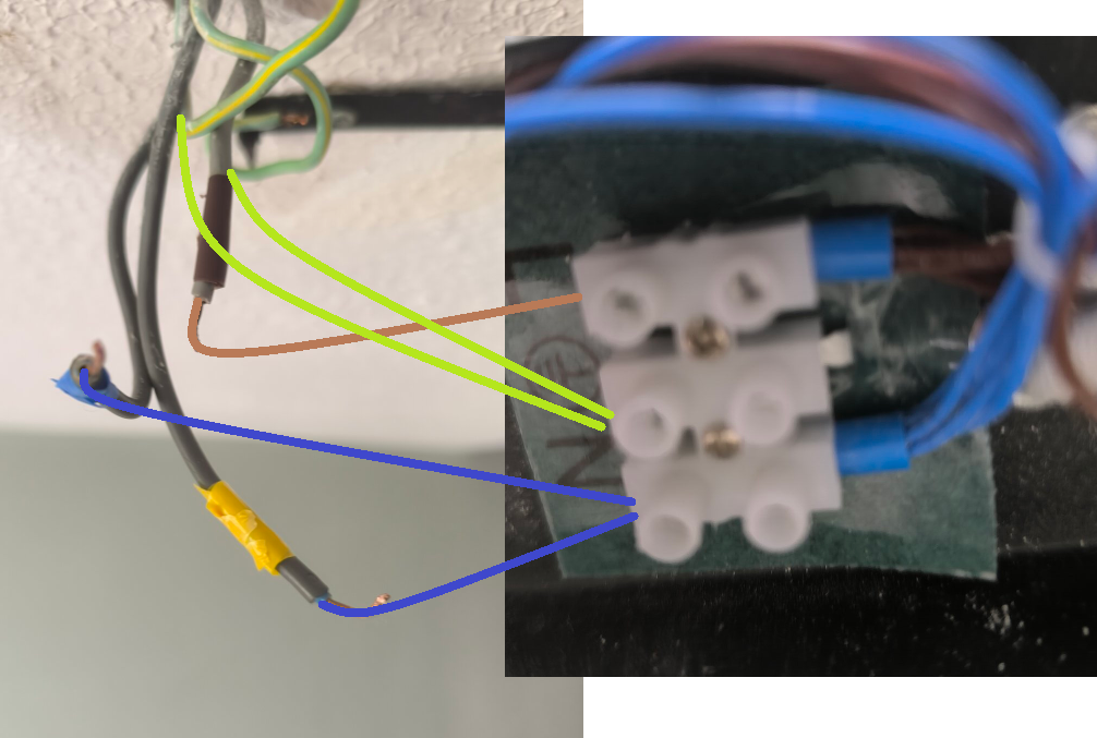

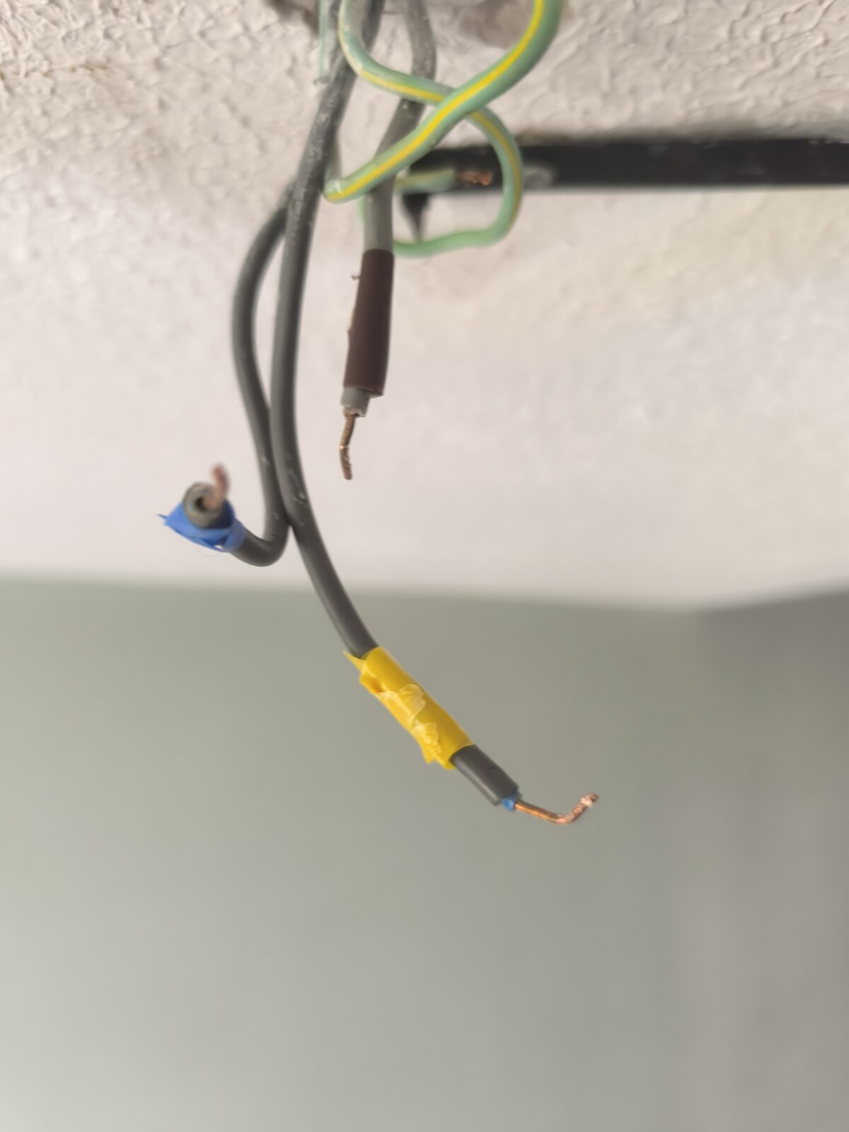

Thanks - Yes, there are two earth wires which I didn't mention.
OK - I managed to get some of the sheathing back, there is one brown (wire 1) and two blues (wires 2 & 3). I've colour coded them with wire 1 as brown, wire 2 as yellow, wire 3 blue.
When I wired the light originally, I had 2 & 3 feeding into the neutral connection and 1 into the live on the new unit on Light C,. As I said before, this meant that lights A-C worked but D to F don't turn on. If I disconnect light C completely, Light A still works but B doesn't. Light A only stops working if I turn off the downstairs lights completely at the switch board.
I tested all of the cables to earth on the Light C connection:
Wire 1 (brown) = 170v
Wire 2 (Yellow) = 66v (unless I turn off light B, in which case it's 0)
Wire 3 (blue) = 114v
Pictures attached of the wires and the connection on the light.

This is what I would expect it to be with 1, brown=switched live - 2, loop out neutral -3, loop in neutral. However it appears you have an issue with you earth(s) which needs investigating.
