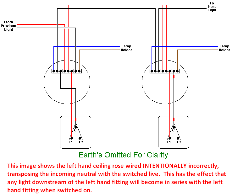

Ceiling rose comes on dimly when other lights switched on!
Wouldn't that open the CPD?
No.
If you mix up the black switched live with the INCOMING neutral, you end up with everything downstream of that light being placed in series with the light. When you switch other lights on, that light will glow dimmly.
It will only blow a fuse if you get the OUTGOING neutral muddled.
Follow the current path on this diagram (which I have adapted to make it incorrect!)
