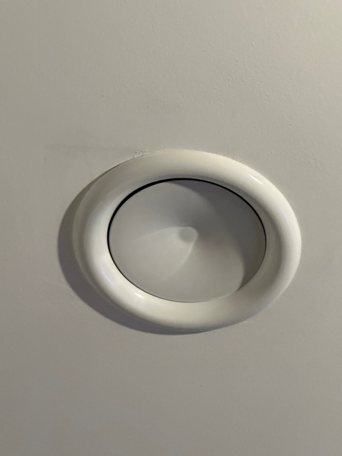

Hi folks,
So I am in a council property with a Vent Axia system at the moment. Having a problem where the vents are spitting out dead insects, flies etc. The council aren't much help.
Do any of you DIY'ers know if such a thing exists as in vent filters? Obviously the flies and insects are managing to get past the filters in the actual main unit or the ducting has a split somewhere.
I've attached a photo of the vents.
Cheers!

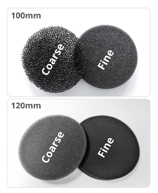

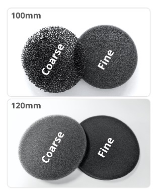

Yes they are available, Vega do a range of foam vents that have washable filters. [Other manufacturers are available :)]

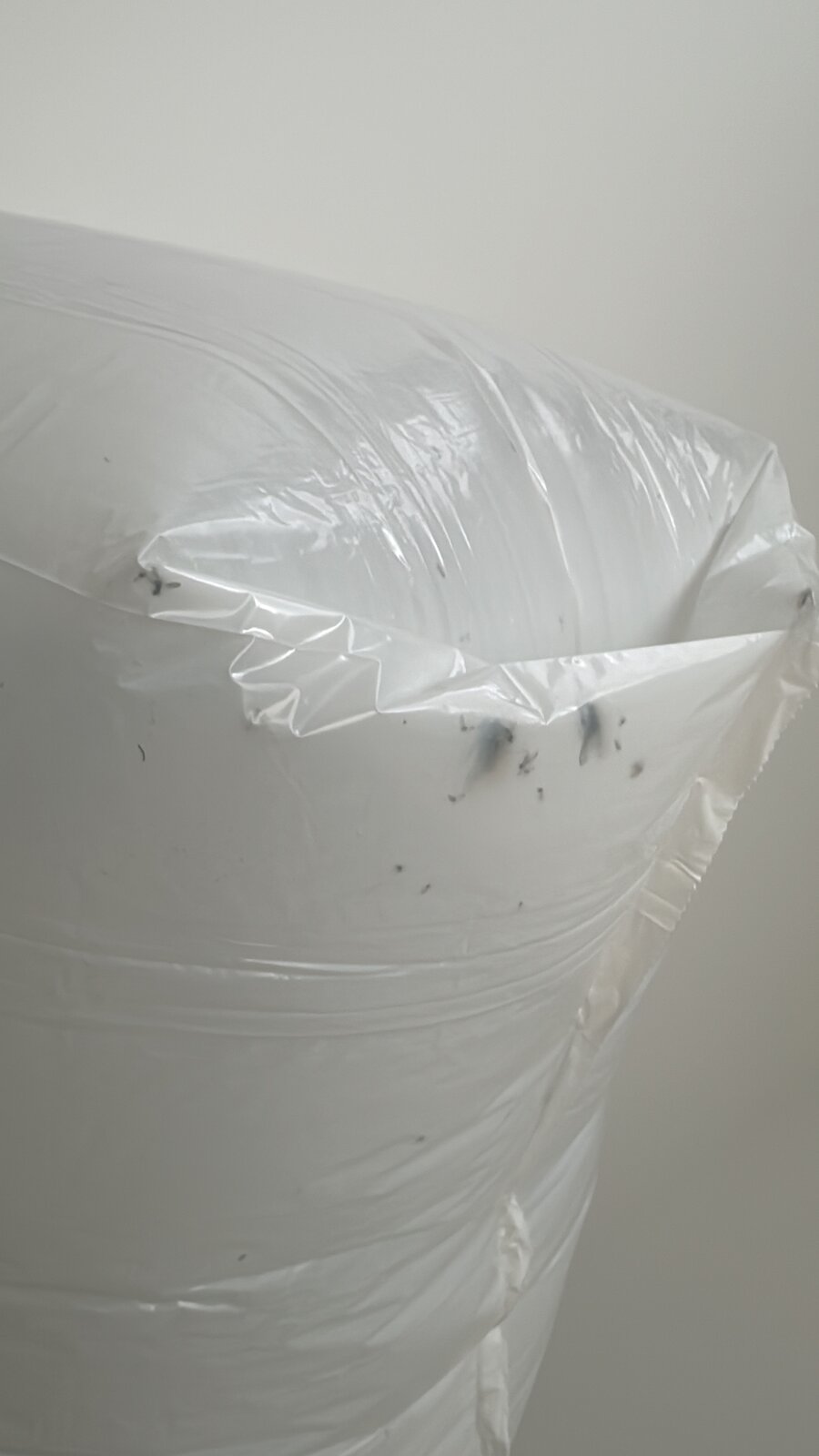

Cheers for going into such detail. So council decided to ask me to purge the system each day for the next week and see if that helps. I very much don’t think it will.
Did my first purge yesterday. I put some bags over the vents to catch the flies etc. It caught quite a bit.

I'd be inclined to pull the mushrooms off and hoover them out.
You wouldn't happen to have a link to these would you?
The ceiling vents? I've taken them off and given them a clean a few times just in case. But hasn't helped.
