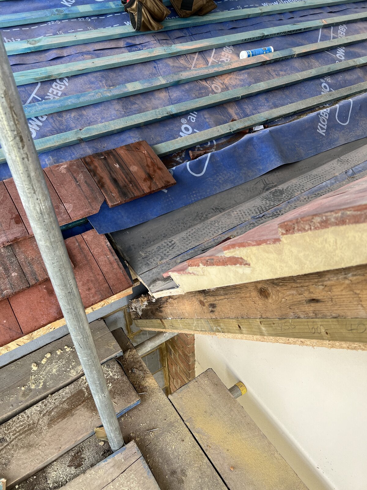

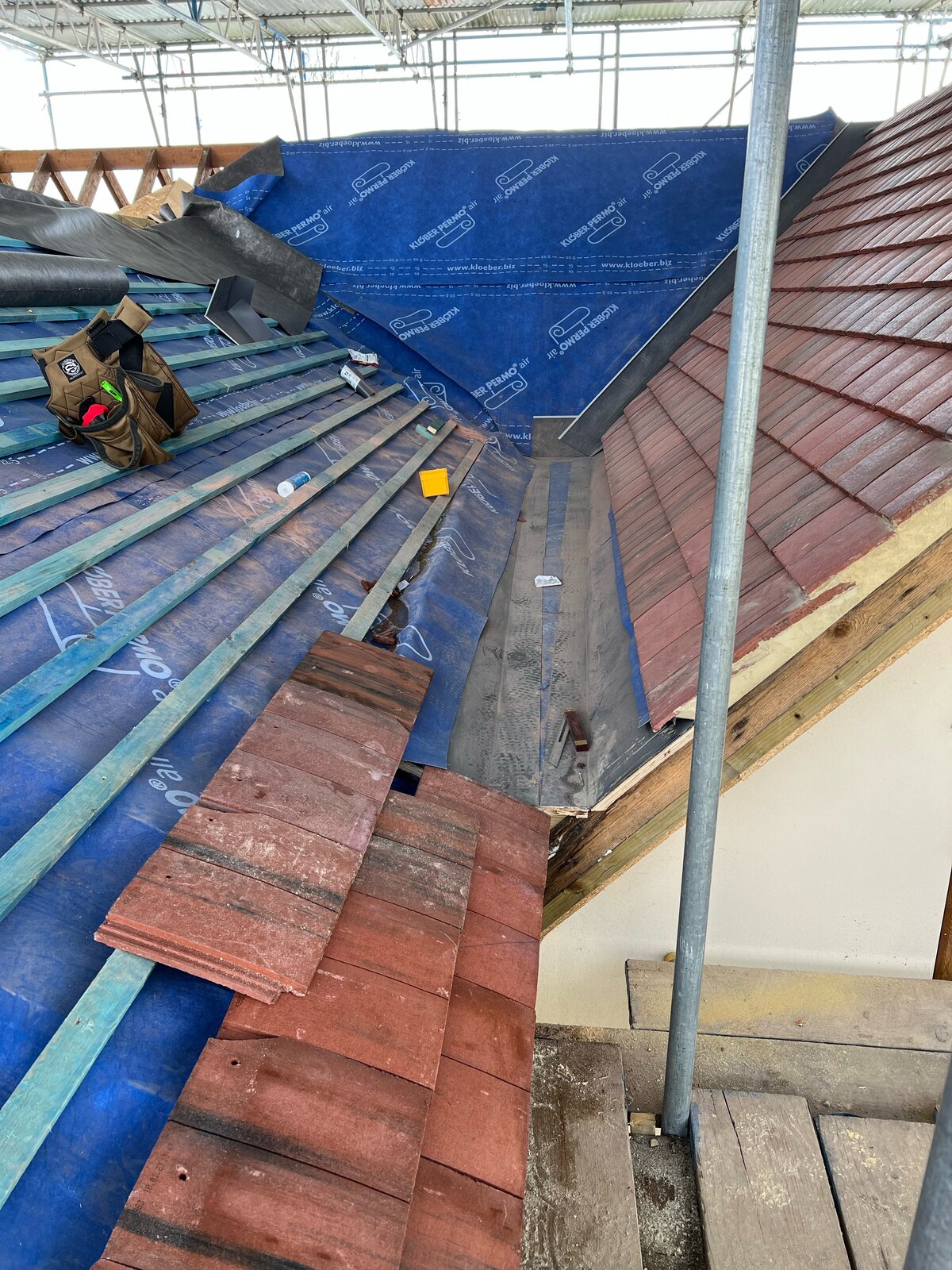

Hi,
I have a double gable roof which falls into a central single ply box gutter. One side of the gable is longer than the opposite site. If the gables were the same length it would simply be a case of placing a hopper fixed to the fascia and dress some lead from the box gutter into the hopper.
However I don’t have this luxury with this roof so my question is - what is the best way (and best aesthetically) to deal with the dispersion of water from the box gutter.
Any suggestions welcome!
Thanks in advance

it needed a diminishing course on the rh side and then a lead saddle at the outer end.
You say single ply, what product is it? it looks a bit un thought out
It’s Sika Trocal single ply system. The metals are in but the membrane hasn’t been fitted yet..it’s an extension as opposed to a new build which is why it’s all been added on along the way.
What do you mean by diminishing course? And right hand side as you look at the photo?
