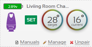

So tried each radiator non have really hot water on return pipes, radiators do get hot some times, but seems hit and miss, all TRV bases change when I moved in 4 years ago, all heads except toilet shower room are electronic all software say batteries OK, three makes of heads, Energenie, Kasa, and eQ-3 latter bluetooth version, main wall thermostat is Nest Gen 3, which is not turning off, so living room now Energenie 17ºC heating to 22ºC radiator cold, Kasa 17.5ºC heating to 23ºC radiator cold but some times the radiators do warm up, tried bleeding no air found, when flat motorised valve opens the main house seems to get warmer, I hear the pipes warming and cooling so water is getting through some where, when we moved in no motorised valves and which ever pump ran the water would flow in reverse through the other pump which is why valves were added.

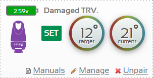

If it did not work, could likely work out fault, but it works some times, and the old smashed TRV head sitting on mantle place is showing 19ºC so living room is heating up, but intermittent.

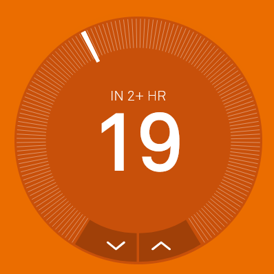

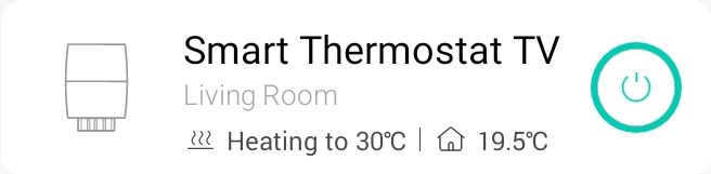

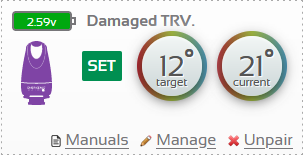

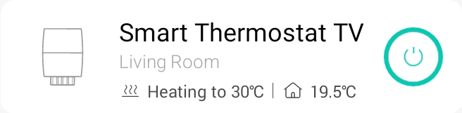

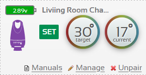

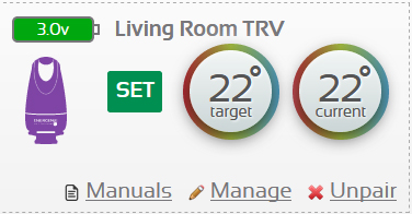

Two hours latter, nothing really changed, and now one radiator one and just about touch, and the other half has warmed up, and nothing has really changed. And this is my problem. 1704834629273.png1704835667954.png1704835953184.png All showing as it should but some times rooms get cold and radiators cold even when all showing as running. The old TRV head is sitting on the mantel piece and is showing 1704836157268.pngnow so room has warmed up as it should now, the showing of 21ºC, 17ºC, and 19.5ºC for same room is normal, it is heights of TRV heads and position, would not normally set to 30ºC but wanted to be sure the TRV was not the problem, over night heating will be off and tomorrow starts over over again, having no idea if room will heat up or not. Any ideas welcome.
Two hours latter, nothing really changed, and now one radiator one and just about touch, and the other half has warmed up, and nothing has really changed. And this is my problem. View attachment 328574View attachment 328575View attachment 328578 All showing as it should but some times rooms get cold and radiators cold even when all showing as running. The old TRV head is sitting on the mantel piece and is showing View attachment 328579now so room has warmed up as it should now, the showing of 21ºC, 17ºC, and 19.5ºC for same room is normal, it is heights of TRV heads and position, would not normally set to 30ºC but wanted to be sure the TRV was not the problem, over night heating will be off and tomorrow starts over over again, having no idea if room will heat up or not. Any ideas welcome.

So I don't expect anyone can remotely work out what is wrong, but they may have ideas of what to test. This morning I set both living room TRV's to 28ºC to ensure they are open.

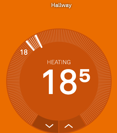

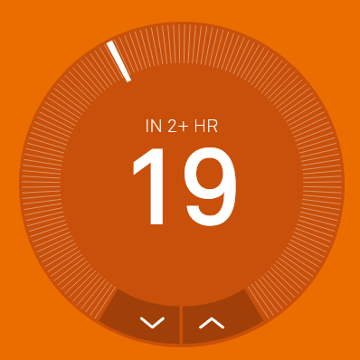

and the main Nest in hall 1704899911672.png. Oh I am wondering if the Nest? On first looking saw 1704900054286.png then went to orange, so maybe Nest Gen 3 is the problem, had problems with Nest before due to EE mast being damaged and it thought I was not home, but walking past the thermostat would turn it on, so every time we walked past it was running, but would then turn off.

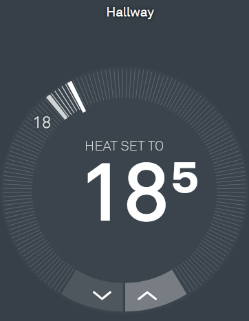

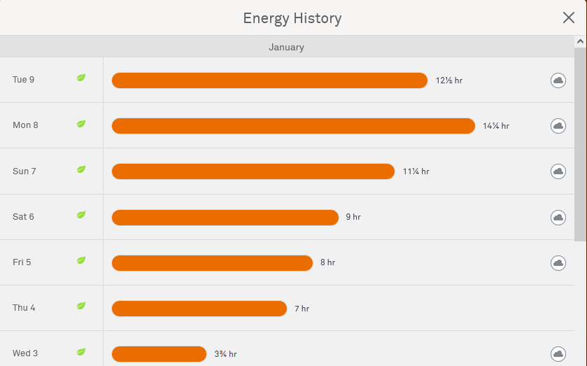

So 1704900350462.png I only get history on the next day, so I have no idea how long it has been running today until tomorrow. So there is a host of settings Sunblock (Off), Leaf (Ready), Auto Schedule (off), Time to temp (Ready), True Radiant (off), Eco Temperatures (Off).
So could the Nest be cause of my problems?

Phone call out of the blue, I get my nails cut, so on their list, may be down to this area having no mains gas? I do not expect they will help that much, but worth a try. The amount of time boiler running seems too short, schedule starts at 8 am, and each 5 hours it raises 0.5ºC until ¼ past midnight when it drops again, and this means it does not over shoot, and we like it a little cooler at night. But the time it has run for does not seem long enough, trying to work out why. Nest records when thermostat asks for heat not when boiler is running, so 12½ hours does not mean boiler ran that long.

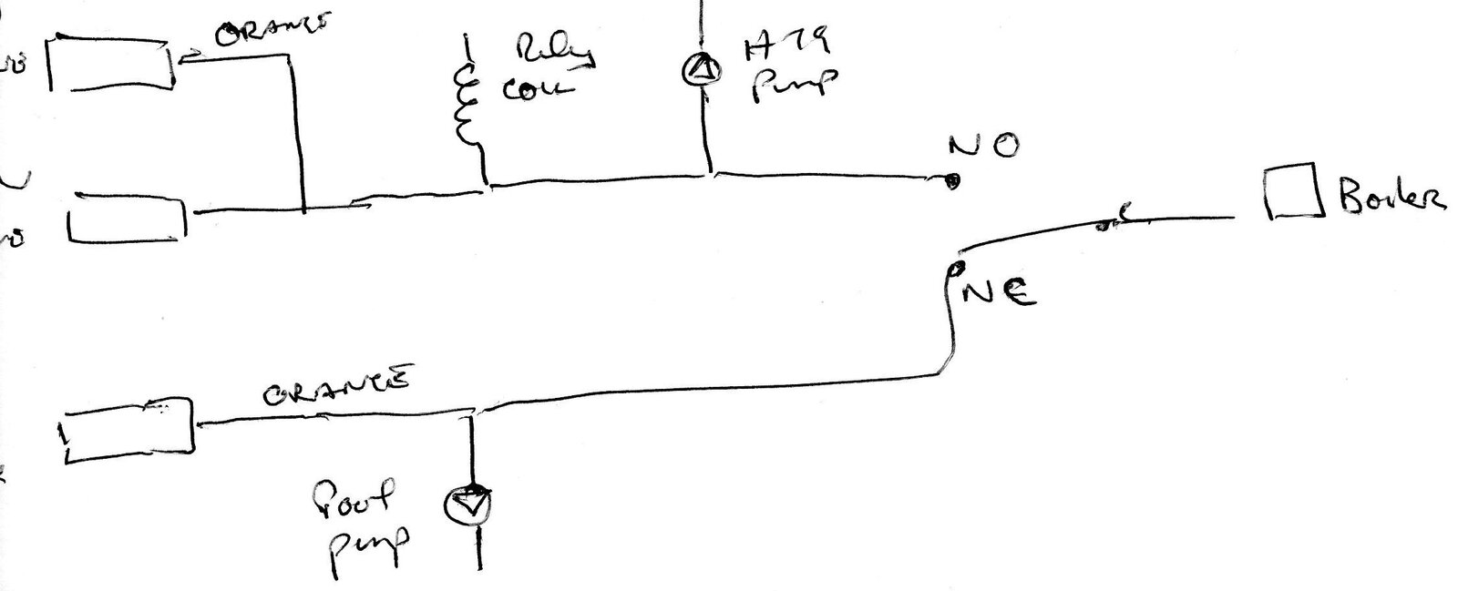

It has never been A1, when I moved in to put it mildly it was a mess, to get CH in main house, I had to switch on boiler with programmer upstairs, then go down stairs into flat and plug in the pump, powered from 3 FCU's and a socket from two independent distribution units, it clearly needed some work doing, and more than simple repair, as there were only two cores up to down stairs and colours turned from red, yellow, blue to brown, black, grey some where in the run, so seemed prudent not to use for low voltage, which is one reason for selecting Nest as the link thermostat to heat link is extra low voltage.

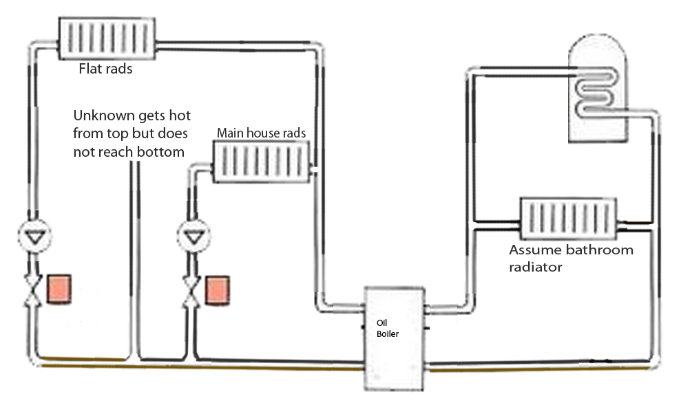

This is the as built now, I know there is a relay missing, really there should be two, it is an 8 pin valve base relay and there is space in the box to fit the second, but it should not matter as house used without flat, but never use flat without house. I had expected the plumber who fitted the motorised valves to go down to one pump, but for some reason he didn't.
There are 4 rooms in the flat, these have mechanical TRV heads, and a mechanical thermostat in the kitchen, works well, but flat not really used.

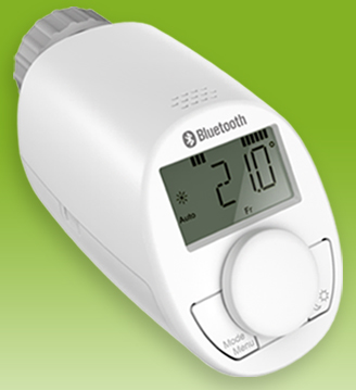

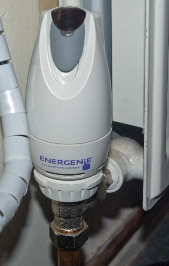

The main house 9 heated areas, the utility room not heated, the upper bathroom radiator thermo syphon, as is DHW, 4 upstairs rooms have 4 eQ-3 61dmtMm13BL.jpg bluetooth TRV heads, also one in kitchen, hall, dinning room, and one living room TRV are Energenie IMGP8035.jpg the odd one in living room is the Kasa (TP-link) as one Energenie killed by carpet fitters. And don't like Energenie as you can't manually alter, have to use the PC.
I think the problem lies behind the plaster board in the flat, I tried to trace pipes, I got this far Pipework.jpgbut you can see the unknown pipe, I could not trace where it went. I tried to balance the lock shield valves as done in last house, last house I would watch the computer read out, TRV_report.jpg if target was higher than current open a little, if target was lower than current close a little, but one oil boiler does not modulated so turns on/off all the time, and the rooms never got warm, so opened most of them up again.
I do wonder if there is some by pass valve hidden behind the plaster board, as can't find out why hot water returning with no radiator hot. Could understand if all going through one radiator, but the micro bore seems to ensure all radiators get their fair share.
