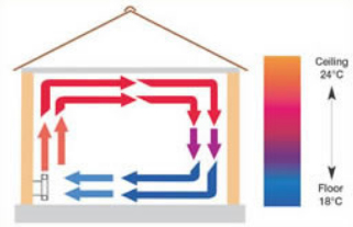

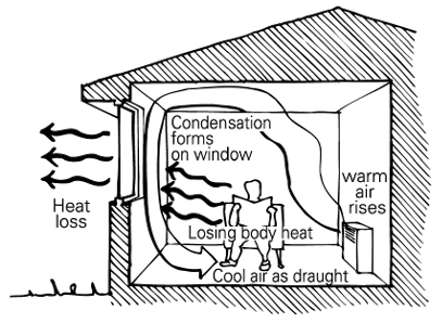

But there is a second problem, we expect the air to circulate, circulation2.jpgso the return air at floor level is the coldest air, so the TRV ideally placed to measure temperature of return air, unless on an outside wall, circulation.jpg once established great, but until then the TRV is colder than the general air in the room, so it turns on the central heating premiturly.

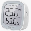

So in some cases we want the TRV to a wall sensor, 1782297435305.png1782297461688.pngwith or without a display, so the TRV better senses the room temperature. So we have two very different linked TRV heads, some link to a sensor, and some link to the boiler.
With the latter, one can have a combined wall thermostat and hub, or they can be independent, the latter can reduce wiring requirements.
So the Drayton Wiser TRV can link to either or both hub and wall thermostat, so is very flexible, others are limited as to what they can link to, so there is no best, just the best for your home, what will work in my home may not work in yours.
