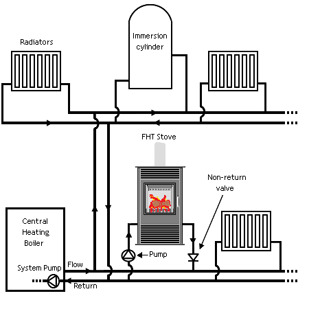

Well look they all look simular to this

That sketch you've linked to is for a very specific brand of woodburner, it would NOT be safe to hook yours up in that fashion.
You have not seen any diagrams for a wood burner on its own by any chance?
