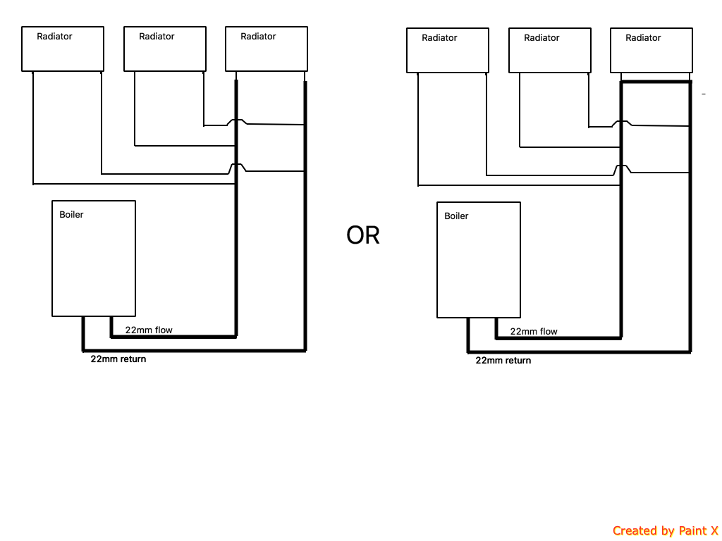

I have another really stupid question if that's ok.
Should the 22mm main circs create a complete circuit back to the boiler with all rads tee-d off in 15mm?
OR
Should the 22mm flow run to a radiator (with a reducer to 15mm) and then the return from this radiator goes into the 22mm return to the boiler, with all other radiators then teed off in 15mm? So essentially this 1 radiator forms part of the main circulation, with all others tee-d off the flow and return?
Does that even make sense? :D
My setup is pressurised with an unvented cylinder.
If you want the radiator to heat up then you need the water to flow through the radiator.
That happens best with option one.
But all other radiators will be teed off the main 22mm pipe so I don't understand why it would make a difference?
The difference is that Option 2 short circuits all of the radiators and will be the path of least resistance - meaning water will always try and flow through that path rather than where you want it to go (i.e. through the radiators).
