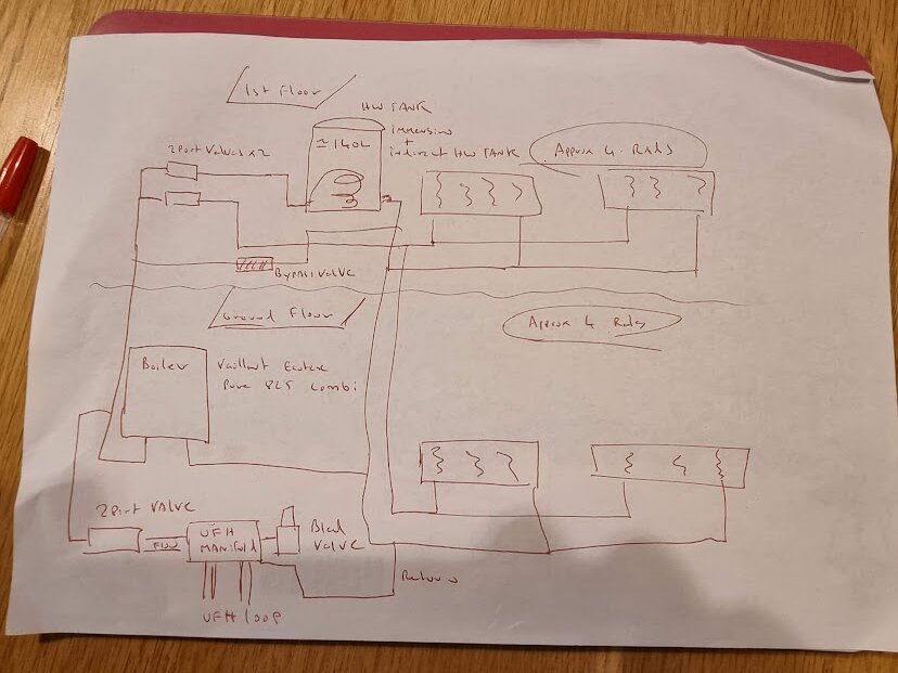

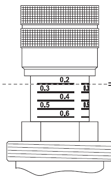

Adaptions - as pump was in airing cupboard in loft with hot water tank, new boiler has self contained pump, UFH manifold under boiler in kitchen cupboard, a bypass valve is fitted as shown in diagram between unzoned flow and Hot Water tank return in loft but set, I assume at default min 0.1bar. Loft header tank removed from boiler pipework as now pressurised.

OK but wouldn't the installers have disconnected the HW cylinder from the hot feed to the taps? Needs some more info from OP.
Sorry. Not a full explanation. The hot water tank supplies only a second shower upstairs. Oh and the basin that's it.
Downstairs bathroom and kitchen sink off combi.
Yes. I will do it was set at 0.1. I didn't change it. But surprisingly, I couldn't feel much supply of heat going through it at any stage. Yes, it warmed up by conduction I suppose. But I could easily tououch it and the bridging pipework at all staged. Thanks for the advice.

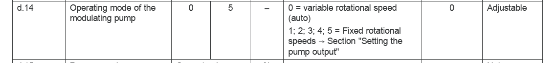

You (if) can access the boiler diagnostics and check the pump status, its default setting is 0( auto) , suggest changing to say 3 or 4.

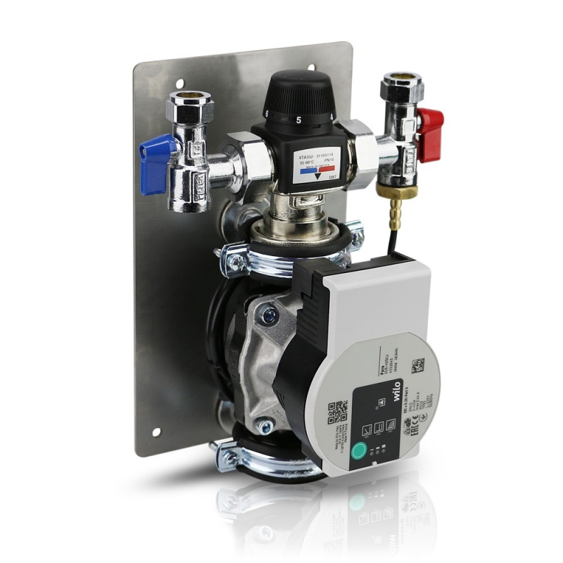

No flow meters!! It's the wilo pump, esbe mix valve backing plate and not much else. Very basic. Pic attached.
The ufh pump only comes on when ufh stat is calling for heat and the zone valve to it opens. As you'd expect.
Yes. I read those config settings. As not used to auto pump settings. It is on zero. If I change to 3 or 4 it said something about needing to change the setting in the bypass inside the boiler to max. Is that necessary as well? Thank you.
Don't know if internal bypass needs adjusting, you can read off the pump speed in d.15, suggest checking this while pump still in auto at different combinations of CH, DHW&UFH, then change d.14 to say 3 and read off the speed, the pump head (a 7M pump?) is then 7 x (speed%)/100) squared, (the pump flow is directly proportional to the speed) and you will get a feel for what is required with the external by pass as well.
Will try that. Thanks. Or maybe suggest to engineer on his revisit. Either way gives me something to work with.
