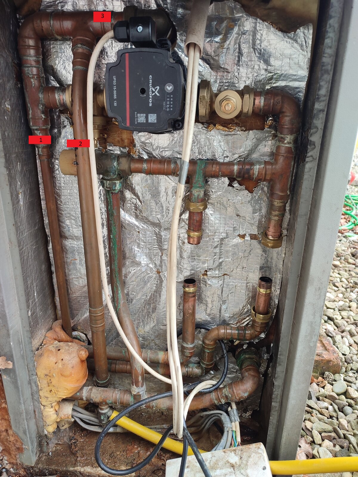

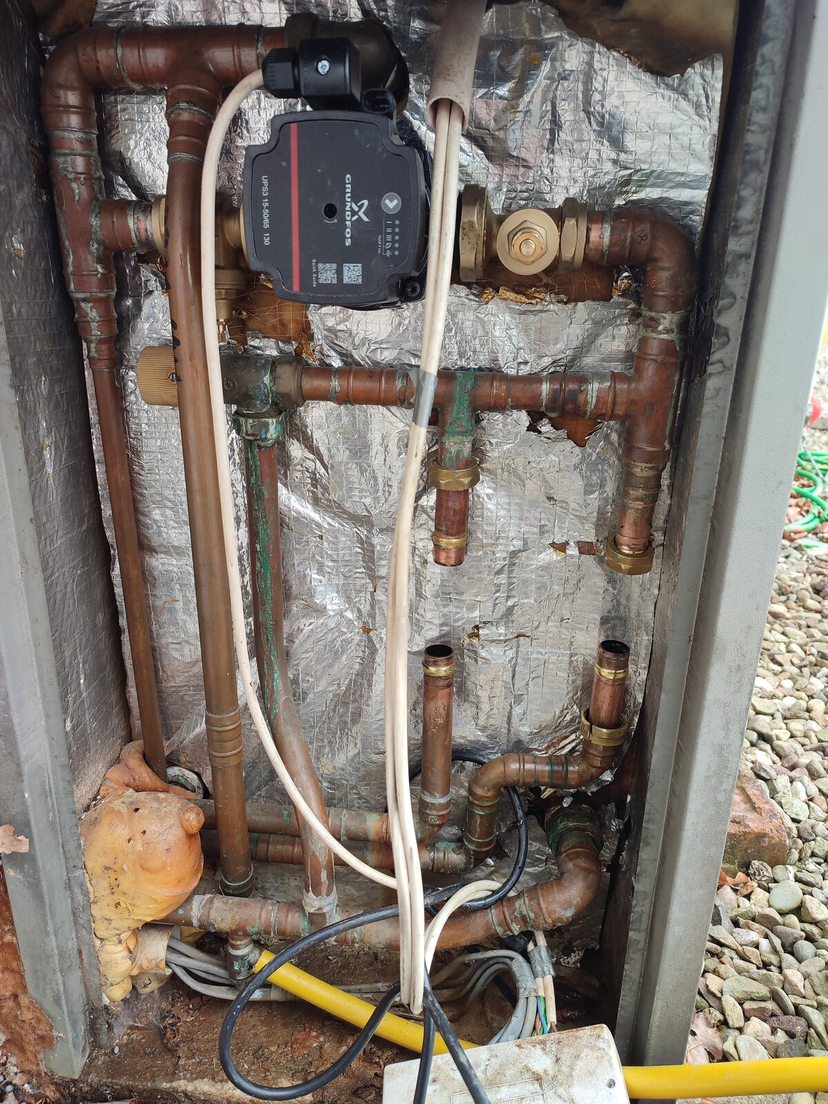

Here's the pump/valve layout, after having removed and tested the valves (heating left, hot water right):
I'm curious if anyone knows what the third pipe from the pump outlet is - it has some kind of valve on it, with a twist head, that I haven't touched. But I'm curious what it is - some kind of thermostatic bypass?

The object with the white twist cap is an automatic bypass valve. It links flow and return if the system pressure gets too high (e.g. hot water off and all radiators have TRVs which are closed) so the pump isn't working against a closed water circuit.

Temp on the inlet of the pump (left) is ~ 47C (too hot to touch)
Temp on outlet of the pump (right) is ~40C (bit hot)
Temp at the open HW mechanical valve (right most valve, removed in pic) ~24C (slightly warm)
Temp at the open CH mechanical valve (centre/left, removed in the pic) ~30C
Temp at the overflow pipe (left, with plastic twist cap) ~23C

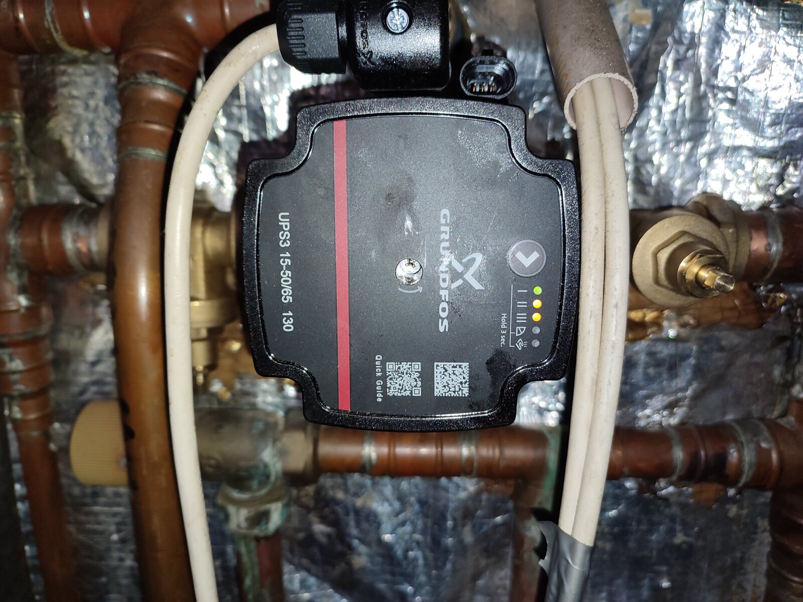

What mode and setting is the UPS3 on?, can you post a photo of the running pump with the LEDs.
You could remove the pump head and inspect the ports and impeller for debris/sludge.
Here's the UPS3 close-up. I've mostly been attempting it on the fixed speed setting at max (the old Grundfos was a constant speed and set to "3").
I did try switching it to constant pressure modes for a bit, but it didn't seem to change anything.

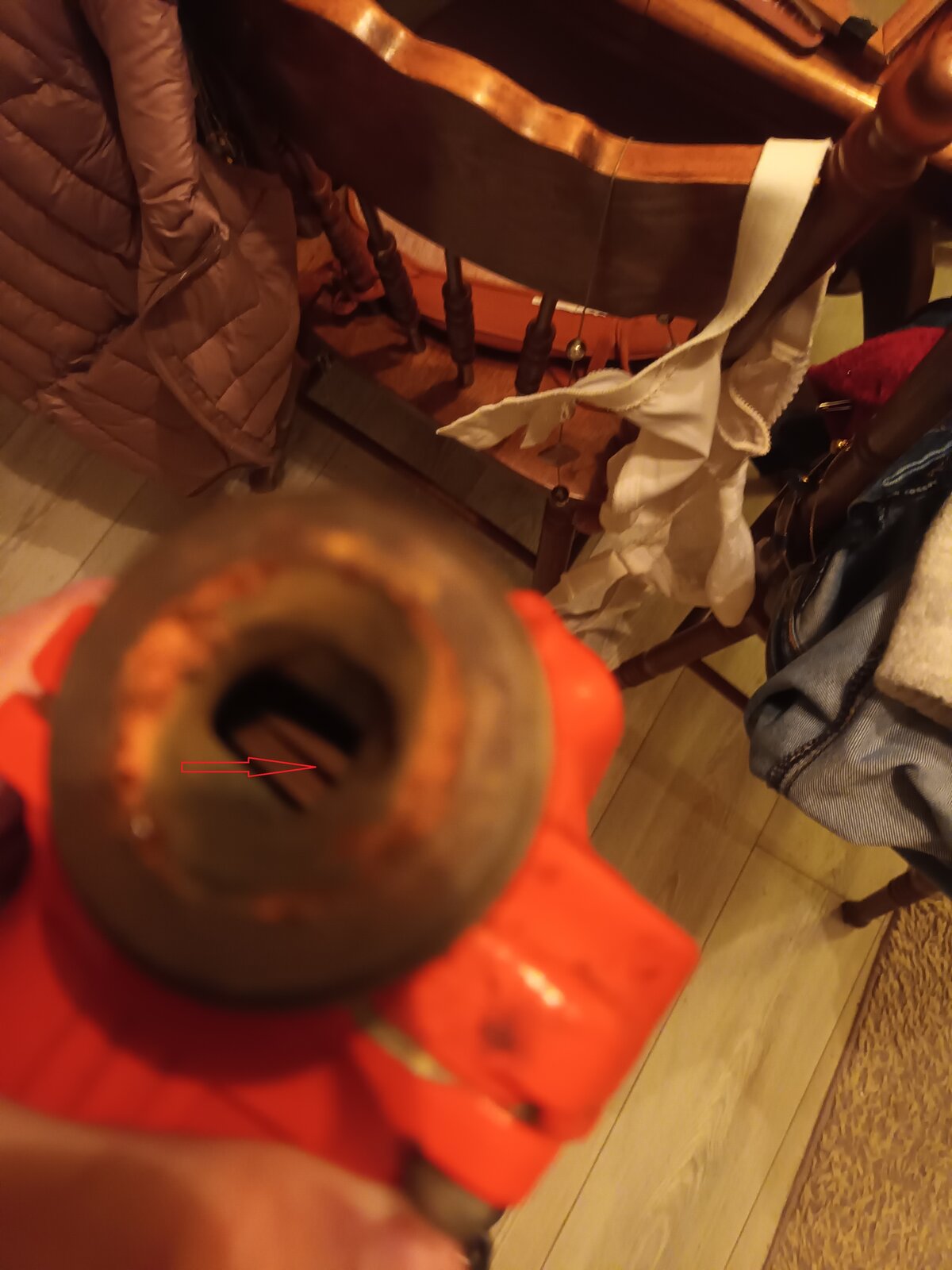

The centre screw seems to push in a bit and spin (turned it off to test that), and the pump feels like it's spinning - gently vibrating away making small tiny-bubble-going-through-pump type noises. It is supposedly self bleeding. There's definitely water to it as the screw leaks if I twist it slightly - a drip, not hiss.
I've ordered a pump spanner (managed to tighten the it on by hand, but I can't get it off!) so will remove it and give it an inspection tomorrow, see if it's stuck.
The UPS3 is a very powerful pump and CC3 at 6.4M will generally lead to air ingress especially when the pump is starting and stopping, CC1 at 4.2M is probably quite adwquate, CC2 at 5.2M certainly should be more than enough as all the UPS3s CC curves are, in effect constant pressure at the sort of flow rates you require. CP2 at 4.5M is also a good choice, I have installed a few UPS3s for friends, set to this, on a clean system, PP2 at 3.8M is often a good choice.
As above.
Didn't know there is/was a vent screw on these pumps.

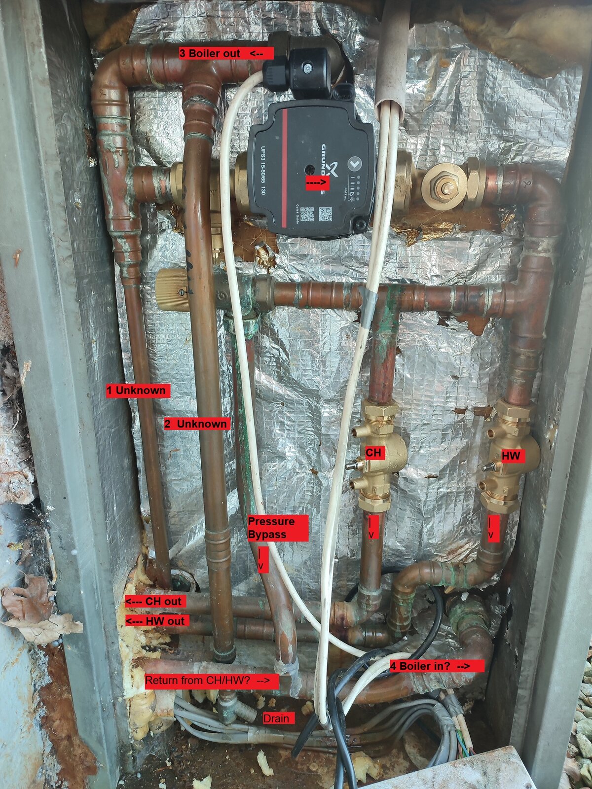

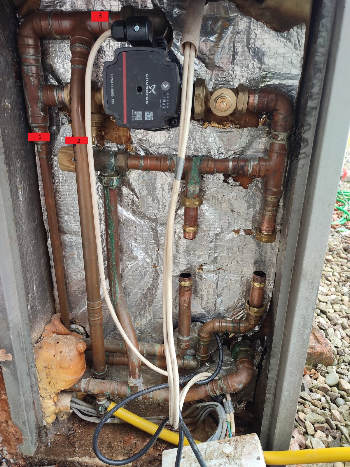

Can you identify 1,2&3 pipe connections. Normal installation is......from the boiler flow, Vent, Cold Feed, Pump, (VCP system) with the vent and cold feed no more than 150mm apart.
When you do remove the pump ensure the pump impeller vanes are clear, stick a tie wrap through them, photo of my 28 year old Salmson, still working perfectly on removal.

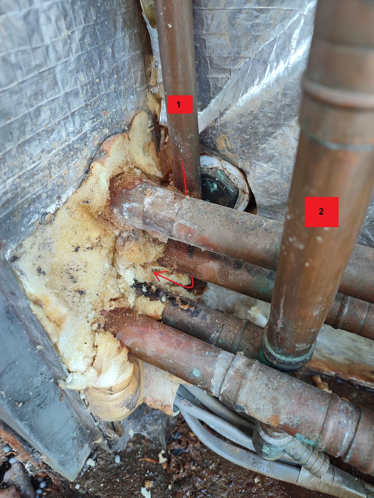

Removed some of the expanding foam to have a look at the thin pipe (1) and see if it joins anything else - but it just angles left and goes into the wall. I wonder if this could be the cold water feed from the loft? That seems to be the only 16mm pipe - but that doesn't seem to make sense with 3 being the output of the burner...
2 similarly, just turns left and goes into the wall along with the hot water and heating outputs.
3 I believe is the output of the boiler. There are only two pipes that go into the boiler, 3 (which was hot) and the very bottom right (which was cool)

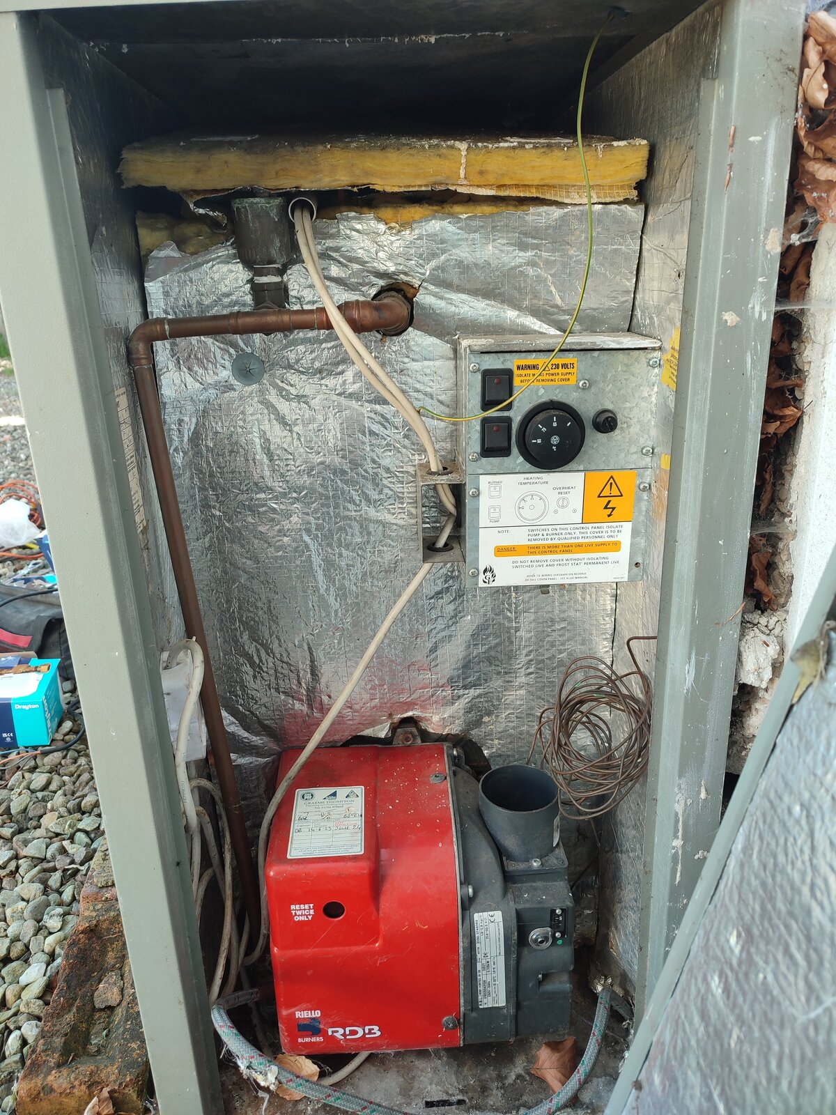

The other side looks like this, if it helps. It's an RDB burner:
In summary, this is my understanding, but I may be mistaken, 1 and 2 I'm unsure about. I'm reasonably confident the boiler output (normally at the top) and boiler return (bottom, and the only other pipe going into the boiler). So from that it makes sense which is the HW and CH out. There are two other pipes, one connects to the boiler in - so presumably is the return from the CH or HW - but there's only one (might they join before coming to the boiler?) The other pipe (2) is a complete mystery to me. Comes out of the wall and connects to the boiler out, but before the pump? And would it make sense for the feed from the loft (16mm, so maybe 1) connect to the boiler out before the pump?
No access on the other side - it's in the subfloor under a fitted wardrobe!
Is the pipework original?
Yes, I would think "2 unknown" is the vent and "1 unknown" is the cold feed, problem is the vent (and boiler flow) is turned down so the vent might be air locked.
If there is a PRV (pressure relief valve) on the boiler, top, if so, even though it may leak afterwards, turn the red knob slowly anticlockwise to vent it until water flows out.
I would then isolate the pump and remove it, slightly (crack) open alternatively the inlet and outlet valves to ensure both sides clear.
Then, maybe, replace the pump, open the valves, tie up the ball cock, ensure any motorized valves manually opened, drain down the system, connect a mains hose to the drain and very slowly refill the system until the feed and expansion cistern is at its normal level. shut off the mains filling, shut the drain , put the pump to CC1, 4.2M and see how you get on.
It is possible that the pump is kaput, these UPS3 do seem to suffer more than their fair share of failures but hard to see it failed straight out of the box.

There was likely no issue with the UPS3, must just have been air.
The Grundfos ups3 has to be the worst pump on the market when trying to get air out & circulate. Had nothing but bother with them on open & sealed systems.
We've actually removed & refitted the old style pumps on boiler installs, removed the manual bleed screw & had systems back up & running within minutes ,
The auto venting just doesn't work.
We've lost multiple hours trying to vent systems , sometimes retuning to the job the following day , hoping that's its managed to clear the air.
worst design ever ,
Just give us back a pump with a manual bleed screw :unsure:
