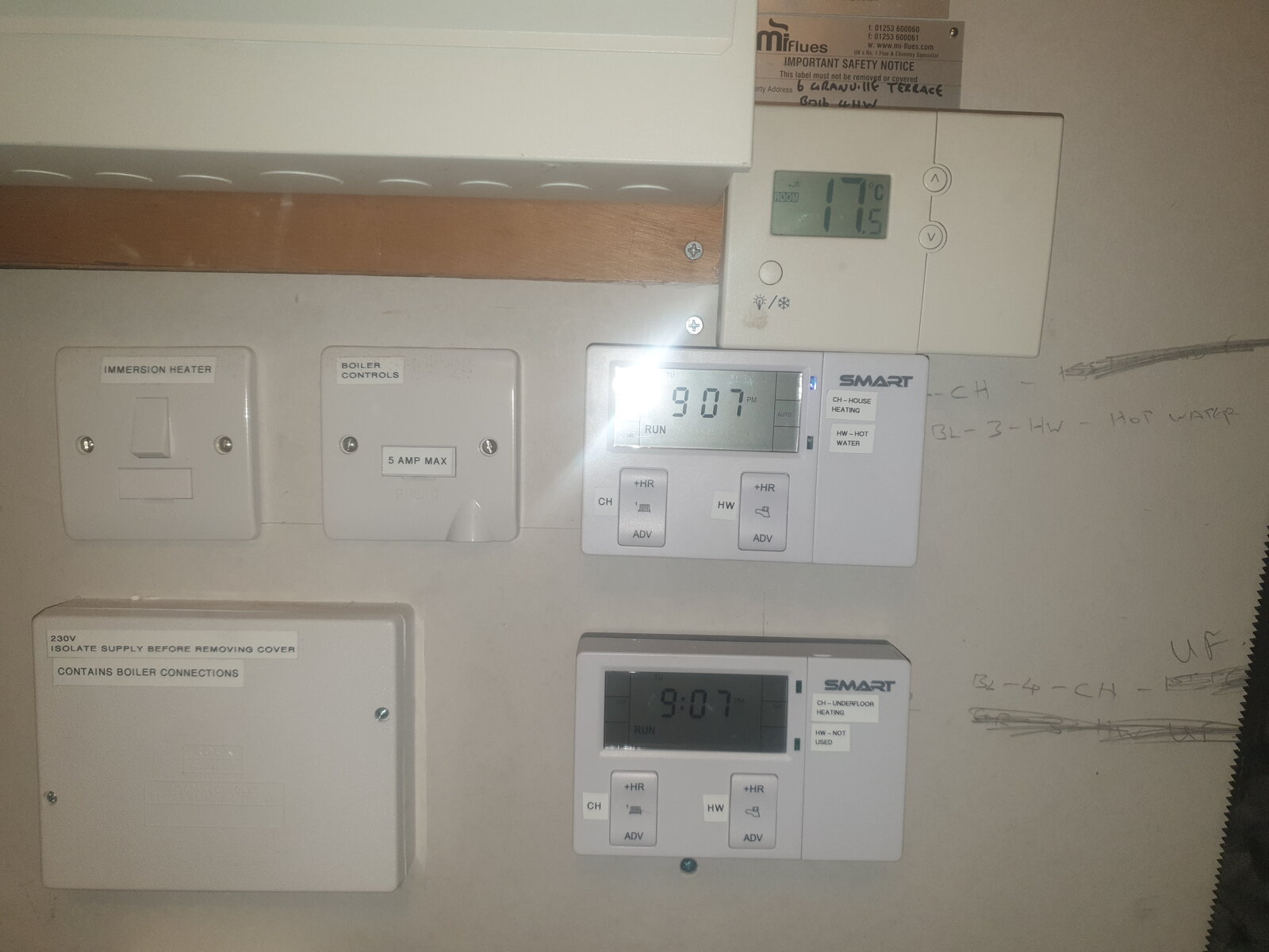

Hi,
I have a Glowworm Flexicom 35hx on a Y plan with separate zone for UFH. 3 motorised valves for water, CH and UFH.
Basic wired on/off controls for water and CH (and RF thermostat) and another wired on/off for UFH (with wired room thermostat).
For the last few months, the CH ONLY has failed to come on when forced via the wired controls, or intermittently come on.
But I figured out it would send a signal to click on when I put the RF thermostat to sleep, then back on again - it would send a signal to click on; only via RF though. This then failed to work, which led me think it was the synchron motor on the motorised valve for the CH..I changed this. But it still wouldn't click on via the wired controls and again only via the RF sleepmode on/off.
It's mega odd. Any ideas?? Please and thank you!

Inside the motorised valve is a microswitch. When the 3-port valve winds fully across to the heating only position it operates the microswitch and starts the boiler. It's not uncommon for the microswitches to become intermittent, sometimes they work and sometimes they don't. In such cases, sometimes deenergising the valve and reenergising it will get it to work.
If you are able to check it safely with a multimeter; when the valve is in the heating only position and under fault conditions, check for a live on the orange wire. No live and there's the problem.

Hi thanks!
Can the microswitch be replaced without replacing the entire head?
Weirdly, I checked the it this morning by turning it on on the wired on/of control and it worked.

Hi again..
I've not changed the microswitch yet but I'm wondering if it really might be that..
Again, the wired control pictured didn't trigger the switch, but then after some fiddling it did. However, when I used the RF to trigger on/off, I could hear the RF receiver click but it wouldn't trigger the valve - again, after fiddling around it did.
It's almost like the controls are being weird. But do you still think it's a microswitch issue?

Hi,
I've had some free time to mess about with the multimeter.
When checking the old synchron motor I changed, I'm getting resistance on it; this tells me it was actually fine.
I checked the microswitch, and when I manually press the switch in with power, it completes the circuit and fires the boiler. The only thing being that the manual latch doesn't reach far enough to keep it pressed in.
I then checked whether there's any voltage being supplied to the synchron motor from the wired controller (blue and brown). Nothing when clicking heating on both wired and RF controller.
I'm wondering if there's a return switch relay on the boiler itself?
If you're not getting any voltage across the brown and blue wires then the problem is with the controls and not the valve.
So, I have a set of wired for ch and hw controls and one for UFH. When I switch the two and click the "heating" switch it still doesn't fire the ch valve.
The RF also doesn't trigger the ch "on".
So, I'm at a loss.. which is why I asked if there's a 240v return to the boiler from the controller/rf to the valve that's not triggering?

Hi thanks,
Sorry, I misspoke - S-Plan(plus?), not Y. I have three two port valves; one for hot water; one for heating and one for underfloor.
I checked the brown and blue coming from the controls (up to the 2 port valve) with a multimeter and wasn't getting anything when switching the heating on both on the wired control, and calling for heat via RF.
However, I switched the UFH wired controller with the CH/HW wired controller, as they're the same (as pictured above) to test if the CH controller was the issue but still wasn't getting anything - which is odd. It's as though something from the controller side leading back is causing a lack of voltage.

Hi,
So I've checked power to the valve, nothing. I've switch the valve with another working valve (from UFH) and still nothing.
I've also switched the wired controls around - UFH with CH and still no trigger voltage to the valve.
Anything else I'm missing? Return voltage/relay from the boiler?

The room thermostat / programmer control the motorised valve and then the microswitch inside the motorised valve controls the boiler. If the valve doesn't open then the boiler will not come on. That's a valve fault not a boiler fault. And after all, you tell us that the boiler is working when it gets a demand from the other valve.
No live present when the heating should be calling for heat, then the controls are not telling the valve to open.
To trace the fault it will be a matter of following / tracing the live wire from the motorised valve that isn't opening, and finding out where the live has dropped out. I suspect that you may have to call a professional to do this for you.
