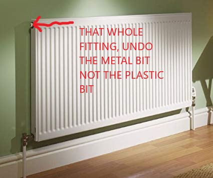

If you have modern radiators (with the largeish fitting holes at the radiator tops as well as at the bottom) then a handy way to do this is;
I think they are not modern radiators, they are barlo radiators - just like this one - https://www.amazon.co.uk/600x1000mm-Quinn-Barlo-Compact-Radiator/dp/B00ADETULI
I must say some of them are really huge like 500 x 2000 DC.
  • Remove one of the inserts at the top of the radiator (they're usually chrome, one will have the bleed valve in, the other will be blank. If you have a spirit level, remove the one at the highest end of the radiator- it should be the bleed valve one but best to check if you can.
  • Insert your pipe assembly, threaded end first, into the hole, wind it all the way in
  • Switch the washing machine tap OFF
  • Fit the washing machine pipe to the washing machine tap, make sure the other end of the pipe is in the bucket (you might want a brick in the bucket on top of the pipe to stop it flying out when you do the next bit)
I mostly understand most of the steps you have listed above. But am bit struggling to understand the bit where I connect pipe with the radiator bleed valve.
One end of the pipe is in bucket, is the other end connected to washing machine tap and the other end of the washing machine tap is connected to radiator valve extension. So is it basically "Radiator bleed valve -> radiator valve extension -> washing machine tap -> washing machine pipe -> bucket"?

Which is a good thing- if the system is up hill and down dale it'll take a while (if ever) for the air to get out, the separator will help (but they can be quite noisy because of the way they work).

Those are modern radiators with the fittings I described (not very well) in the holes at the top of the radiator

To get a good flow of water through the system (which will help shift any air pockets in convoluted sections) you need to remove the large hex fitting in the top of your radiator and replace it with the assembly you've built. The washing machine tap then becomes the bleed valve but instead of only allowing a tiny flow it can pass up to 15 or 20 litres per minute- that sort of flow rate will often provide enough momentum to the water/air pocket to overcome gravity (ie the water will push the air downhill and hopefully to a radiator where you can bleed it out). See attached pic
To get a good flow of water through the system (which will help shift any air pockets in convoluted sections) you need to remove the large hex fitting in the top of your radiator and replace it with the assembly you've built. The washing machine tap then becomes the bleed valve but instead of only allowing a tiny flow it can pass up to 15 or 20 litres per minute- that sort of flow rate will often provide enough momentum to the water/air pocket to overcome gravity (ie the water will push the air downhill and hopefully to a radiator where you can bleed it out). See attached picView attachment 159593
