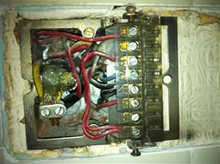

I need to change over my Central Heating Programmer, as my Sangamo M5 is knackered. I've purchased a Horstmann 425, which is a replacement, but could use some advice on the wiring, if anyone can help please.
I think I have it almost figured out, but I just want to be sure.
Here is the wiring for my Sangamo M5 at the moment:
Now, the Horstmann has a comparison wiring diagram which is located here:
http://www.horstmann.co.uk/downloads/ElectronicDocuments/Central-Heating/WiringGuide.pdf
So, as I understand it, I should do the following:
Sangamo M5 ---------------------------------- Horstmann 425
Earth--------------------------------------------Earth
Terminal 4 and 5-------------------------------Neutral
Terminal 3--------------------------------------Live
Terminal 1--------------------------------------Terminal 1 (HW On)
None--------------------------------------------Terminal 2
None--------------------------------------------Terminal 3 (HW Off)
Terminal 8--------------------------------------Terminal 4 (CH On)
None--------------------------------------------Terminal 5
None--------------------------------------------Terminal 6 (CH Off)
As you'll notice in the picture attached, there's a link to Terminal 6, which goes to Terminal 1, can this just be removed now?
Any help appreciated.
Many thanks,
Callum
