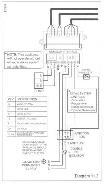

I'm not too familiar with BG re-badged products, but I think your boiler will be wired as below, and if so, the boiler is responsible for controlling the pump, and the pump is wired directly to it. When the boiler runs, so should the pump and it should continue to run for a short time after the boiler goes off.
So, if the boiler is running, thus showing it is getting power from the controls / motorised valve etc, and the pump isn't running; then either the boiler's control of the pump, the pump itself, or the wiring between the two has failed. When you check the power supply to the pump that will give you a pointer.
Fault code 22 doesn't only indicate a problem with the pump, but as you suspect it, it's a good place to start.

Checked the terminals for the pump at the wiring centre and there's no power being supplied to the pump when the boiler is firing up (either in HW or CH). There's 230v coming into the wiring centre, continuity between wiring centre and pump and when I tested the contacts on the pump I was getting 230ohm.

Checked the terminals for the pump at the wiring centre and there's no power being supplied to the pump.
Isn't that contradictory? Either there is 230V to the pump or there isn't.
Unless by that you have tested other terminals at the wiring centre that aren't pump related. But I don't understand why you would do that. The pump should only be connected to the boiler and nothing else, what is connected to the other terminals is irrelevant.​

I tested the wiring centre pump terminals - no power. I then tested the incoming power terminals in the wiring centre and there's power (if nothing else to make sure my meter was working)
I couldn't test the other end of the cable as mattylad suggested as its within a plastic cartridge in the boiler - I thought best left alone. I've called vaillant back to see what they say.

OK understood, the 230V has nothing to do with the pump then.
In which case, it would be unusual for wiring between the boiler and pump to physically fail, but it could happen especially if it goes via a junction box or wiring centre; but is rare if nothing has been disturbed. Most likely the boiler control / PCB isn't switching the pump on when it should be. Anyway it's a simple test for a Vaillant engineer, he can check to see if there is 230v at the boilers pump terminals.
