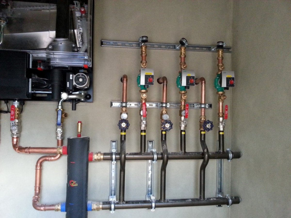

Low loss headers and close coupled tees are becoming more common as a result....
Like this one we did a few years ago now....

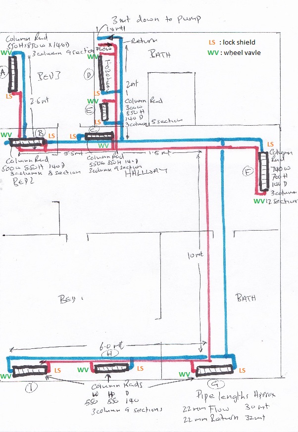

I had a bit of a row with the engineer regarding the placement of the valves as he said it didn't matter.
My feeling is that the gate valve should be fitted on the flow side nearest the direction it is coming from, i.e nearest the pump, is that right or is there some other way of configuring?
It's not the valve placement that matters -with bidirectional TRVs this is optional ( although I prefer TRVs on flow). With some column rads, Acovas being one, the direction of flow through the radiator is critical.
Thanks polesapart, what determines the direction of flow, is t based on the radiator position in relation to the pump or are there other factors that need to be considered.
I've updated the sketch to show the current position of the valves which are the original wheel valves with traditional lock shilds on the other side all sited on the bottom entry/exit ports, should any of them be changed around?
