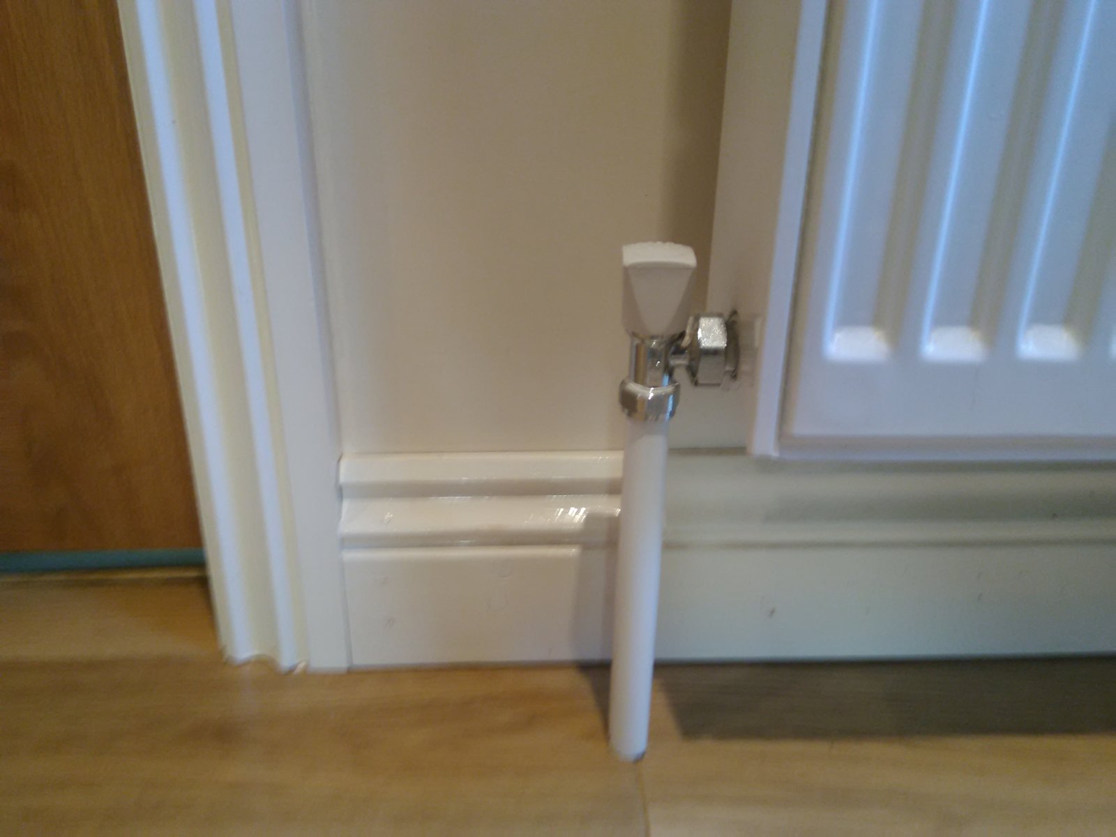

Hi everyone quick question I've been adjusting my radiator valves to balance the heating all's ok but the 1 rad in the hallway doesn't have a control valve on it can you please advise on how to do it & by how much.
Yes it does.
Please post a photo of both ends of the radiator.
A pic would help but it may be there are no controls on it because its been designed as the bypass for the heating circuit.
Instead of fitting a bypass valve some plumbers design the system so that one of the rads has no valves/TRV's.
Should the boiler over heat and not shut down heat can still flow round the system through this rad.
Thanks JohnD IMG_20200120_133845.jpg hope pics are ok both valves same
Hi SJS building the plumber did say at the time he was leaving that rad with no valve
Those are the valves that you use for balancing your heating, what have you been using on the other radiators? Thermostatic radiator valves ?

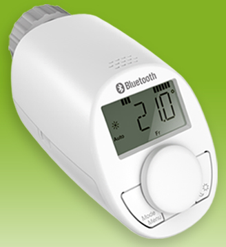

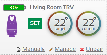

There is however a problem with TRV heads, they are slow, so if the lock shield valve is wide open, the radiator will get very hot, and continue to heat the room even when room has reached the target temperature, with the new electronic wifi TRV heads it is easy, we see TRV_report.jpg both target and current temperature, if current over shoots target then close the lock shield valve, and if current below target after it has had time to reach it, then open the lock shield valve. However with cheaper valves it only shows target, 61dmtMm13BL.jpg so you need some other means to find out the current and you also have to consider that thermometer may not be exactly matched to the TRV head, so a little harder to set, some TRV.jpg do not even show the target temperature in °C, so we tend to set radiators with the same temperature drop incoming to outgoing throughout the house, and cross our fingers that the TRV head can control the radiator fast enough.

ericmark very well explained how a bypass valve works.
digger5560 So unless you know that your boiler has a bypass fitted, or you can see a bypass valve on your system always keep these valves open. Have one fully open and the other adjust to about halfway
Many thanks for great replys guys yes I have thermostatic valves in the rest of the house ,I don't know if I have a bypass fitted so I will do as you suggest SJ . again many thanks to you all .
