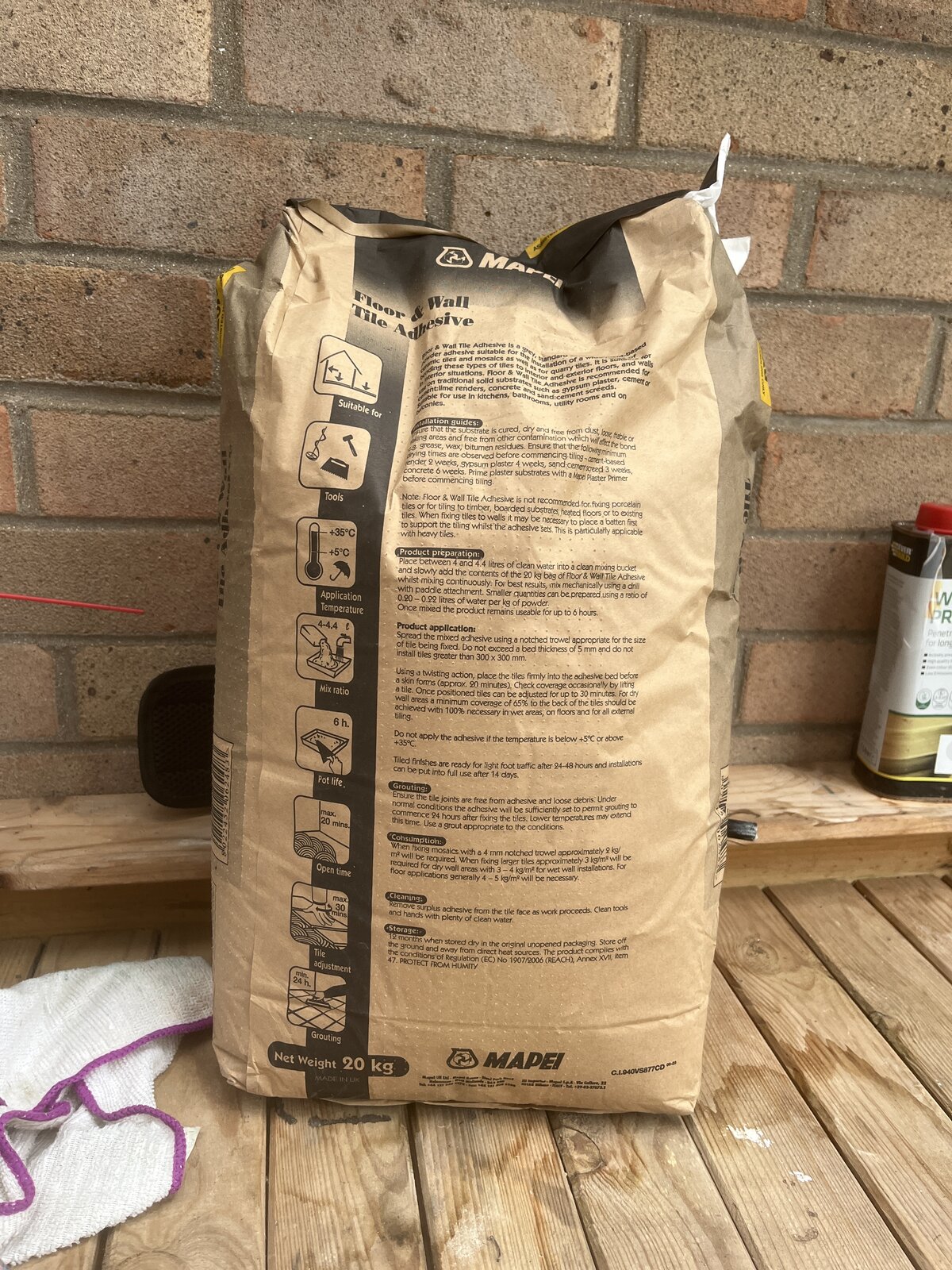

Hi all
I am laying new porcelain floor tiles in my toilet, and have a spare bag of Mapei floor and wall tile adhesive.
It says this is suitable for ceramic and quarry tiles, is this a dead no no to use for porcelain?
Many thanks
OP,
Its, as you say, a no no - your not supposed to use it. Mapei make a white porcelain adhesive - white is often best for porcelain but why not check with Mapei, tell them what porcelain you have.
However, if your porcelain is not see-thro then, for a toilet floor, why not just go ahead and use it?
Follow the instructions on the bag for mixing.
Don't use it.
My friend did thinking that it was only for 2 tiles and after a year or so they fell off.
Porcelain adhesive dries chemically a far as I understand and it's different from ceramic adhesive.

The OP's Mapei powdered adhesive is a cementitious thin set adhesive - it will stick porcelain or ceramic just about anywhere.

It says not suitable for porcelain on the back of the bag (third paragraph)...
Poster #3. See post #9.
I have no idea why they don't recommend it for porcelain. I suspect that it might be something to do with porcelain not being porous (whereas ceramic and stone tiles are).
I tend to trust the manufacturer rather than someone on the internet who ignores the manufacturer's advice.
