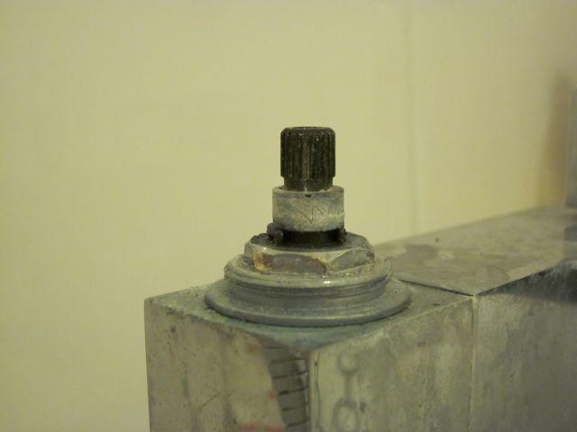

I have a leaky bath tap which was bought from the bathstore about 3 years ago. Unfortunately can't remember the name or any details of the manufacturer so wonder if anyone on here could help identify the ceramic valve so I can get it replaced. I've counted and it is an 18 spline valve but looked on Lunns and can't see a similar one. Any help would be appreciated.
Many thanks in advance
Can't identify it from just the top half I'm afraid, as the bottom halves vary from tap to tap as well. You'll have to take it out, and even then the chances of being able to ID it from photos are virtually nil.
Your best bet is to take it, and the head that goes on it, around all the plumbers merchants in your area until you happen to strike lucky with a matching one they've got kicking around under the counter in a box of random CD inserts they keep for just such occasions. In my experience the independents are better at this than the big nationals, but either way it's going to be like trying to find a needle in a haystack without knowing the make or model of the tap. It *might* help to take a photograph of the entire tap with you (printed out, not on your phone...) in the hope that one of them recognises it. You could even take the photo to Bathstore to see if they know what it is, but I wouldn't count on it, this is rather the problem with buying from this kind of establishment, the backup is often quite poor when things wear out.
If all the above fails it's new tap time I'm afraid, unless you convert it to run off old-style washers which can sometimes be done, but probably not with the heads you have now.
Send photo of complete tap and if possible a photo of the cartridge removed from the tap to a company called Lunns - lunns.net
They have been a great help to me in the past.

Yes - very similar except that mine has a shower attachment as well - but otherwise identical. Any info on the make or where I could get the valves would be a life saver. Girlfriend on my case to get it fixed and tap location is difficult to change
All i know is it is called blade deck mounted shower mixer.
I know sagittarius made the blade but theirs has the spout in the middle of the cross bar bathstores is at the top.
If you ring bathstore tech dept and tell them the situation they will tell you who made their version.
then you can contact them direct.
08000 23 23 23
Thanks - that's nailed it and have managed to order it from BathStore. Really appreciate your help - top notch for identifying it

They said it was designed only for them - were adamant that there no other manufacturers of the Blade Deck Taps.
Stupidly I couldn't find them originally in their range as the picture for their blade range is of a slightly different style. A closer look showed they are still on sale.
Their support department was good and located the part easily - in stock at under £13 + vat + postage
