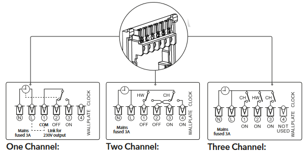

The back plate does seem reasonably universal, however even within on make the wiring can change.
I have always thought this is asking for problems, the single channel is volt free, but the twin and triple channel versions are not, and with the Drayton you can also have an OpenTherm module as well
so one has to read model by model, but a two channel should swap with another two channel.
