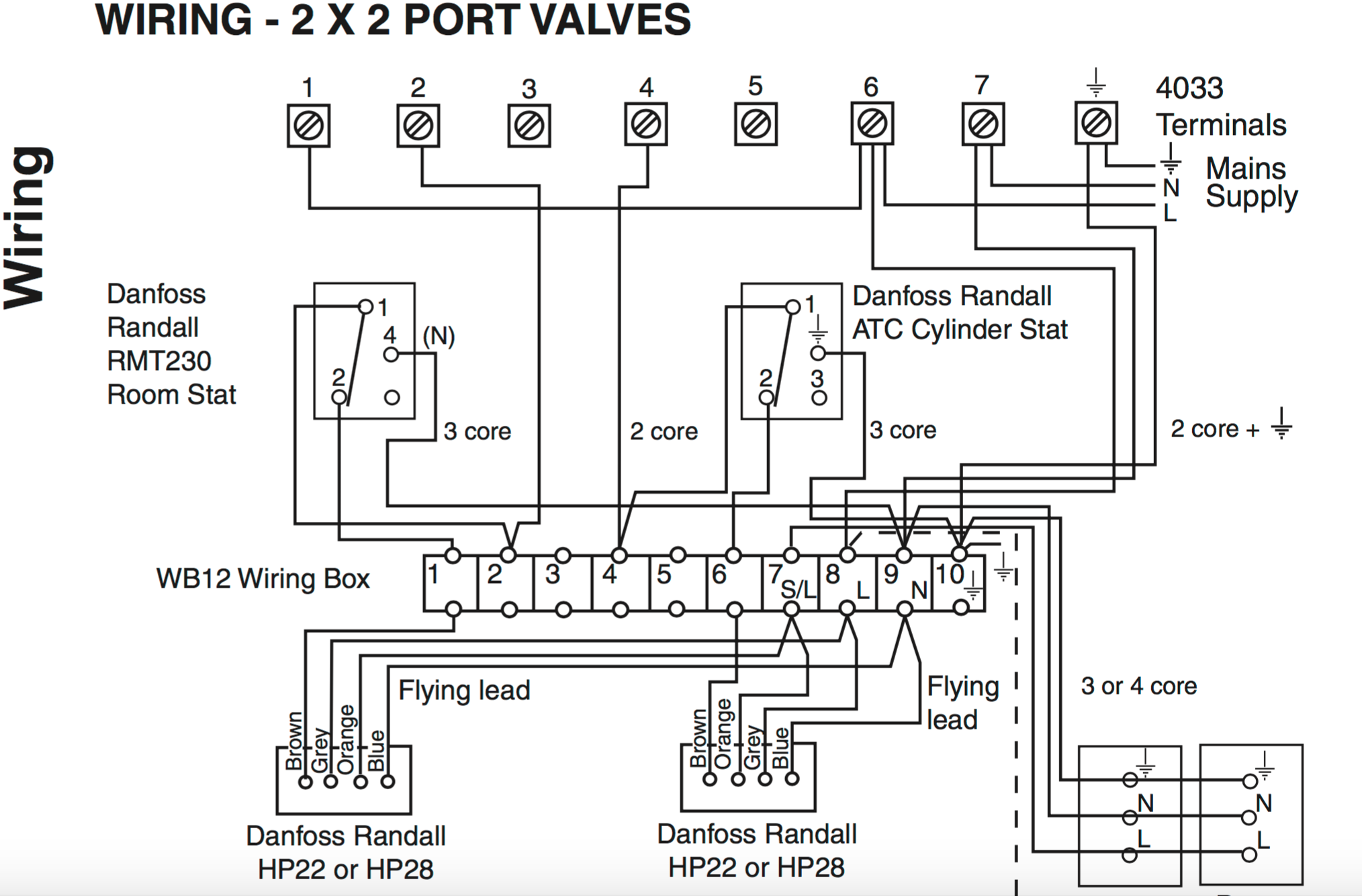

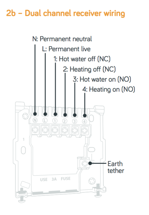

Just got an hive v1 to replace my current ch & hw controls. Anyone none the same replace before, I plan to cap off the stat and replace with wireless stat included which should be straight forward, issue is confirming wiring from 4033 to hive receiver
Please help if poss, cheers.
