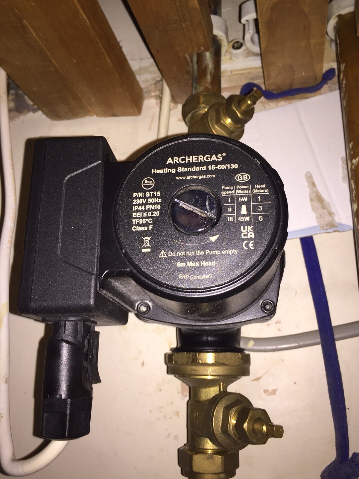

Where do you change or see what settings the pump is on?. I have a feeling there might not be a Eco setting on that model.
"On CH the Pump gets quite noisy with a gurgling/gargling/bubbling sound which increases over time."

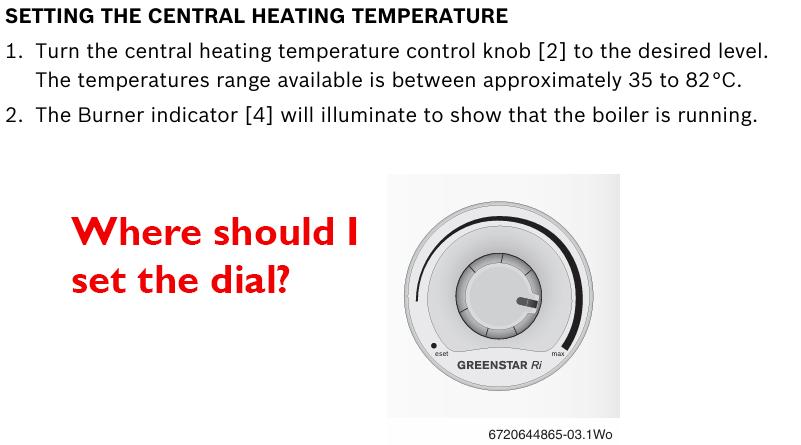

Boiler Thermostat set approx halfway

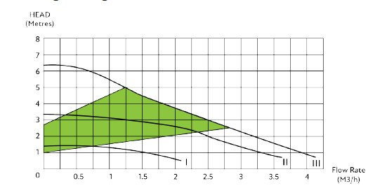

You certainly have a circulation problem, with a assumed minimum boiler output of 5kW and a firing time of 15/25, 60%, means the rad outputs are only ~ 3.0kW.
Even though a 3M head should be quite adequate for your system, (normally) just change the pump speed to 3, this should increase the flowrate by over 40% but may result in excessive noise, if so, just return to speed 2.

Did the rads heat up properly just after the circ pump was replaced, why was the pump replaced?.
As suggested, you might, just, even briefly. change to speed3, if noise increases, return to speed2

- Pump replaced approx 1 year ago because (very) old Grundfos pump spindle was getting jammed frequently.

- During CH Test Post #17 I did switch pump to 3 speed at approx 10:50am. Burner cut off slightly sooner than on 2 speed. Returned pump to 2 speed.

Is the pump installed the correct way around?
- Even though Pump is inverted (upside down) I'd have to go with yes, as it was inverted previously when all working and presume HW would have issues if new pump incorrectly fitted?
