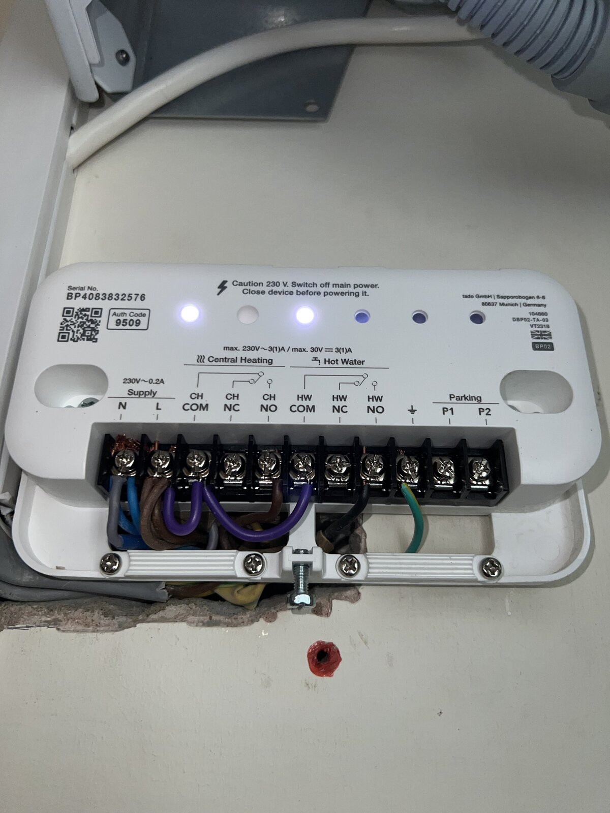

Afternoon All,
Moved home recently and installed Tado V3 to replace EMP2 timer and a WR1 / thermostat.
HW worked okay but CH didn't until I realised the WR1 receiver next to the tank was still controlling the call for heat, so from searching I've joined terminals 1+3 together in the WR1 and Tado now controls CH and boiler fires as expected when heat is called for.
However I can now hear and feel cold water flowing through rads 24/7.
I wanted to check if this is normal? Having only been here less than two weeks I am certain before joining 1+3 on the WR1 I could not hear cold flow through the rads and wonder if perhaps at the time 1 + 3 were joined (prior to switching power off) a valve has been left permanently open?
I have some basic plumbing experience, have worked on my partners combi system before and my previous property was a new build with sealed system which I never needed to touch.
This is an old Edwardian property with presumably a vented system.

How have you wired the Tado in?

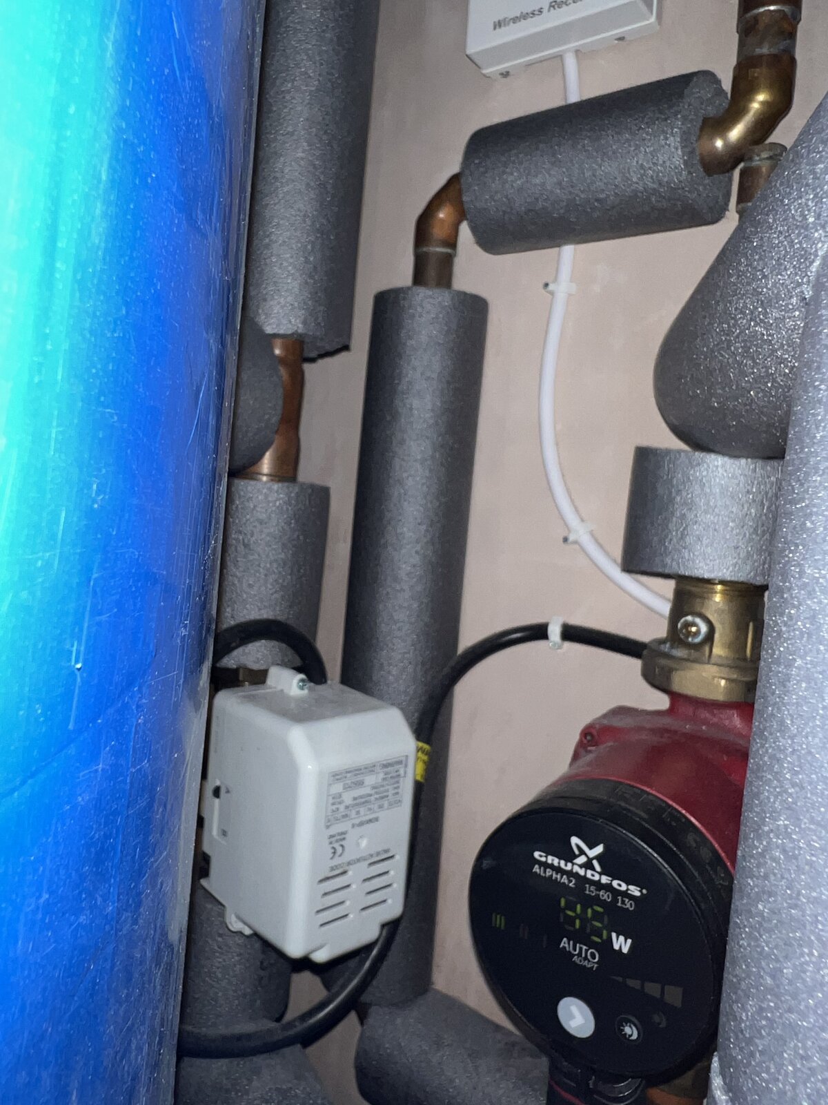

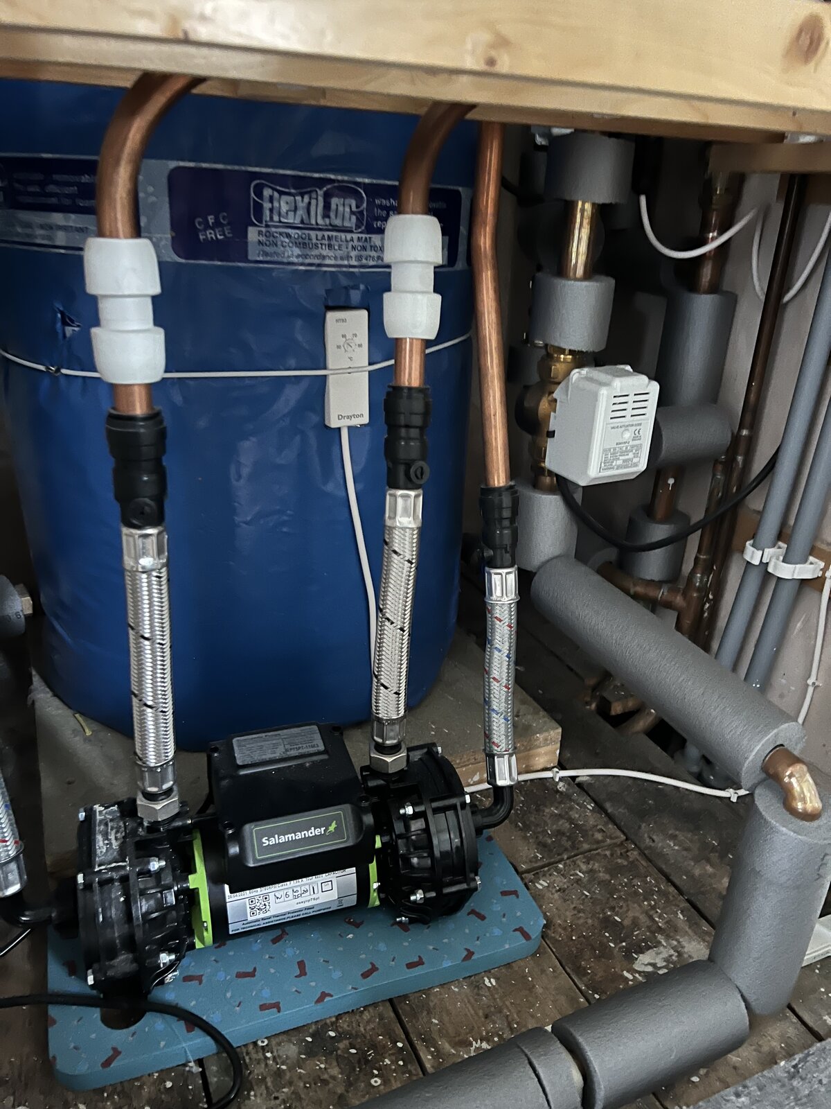

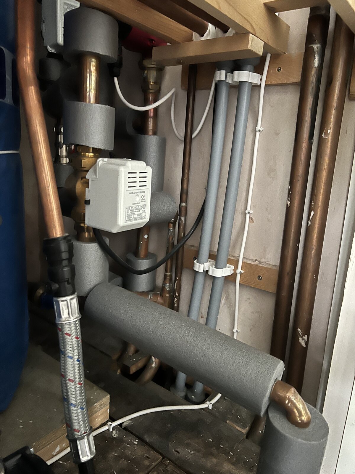

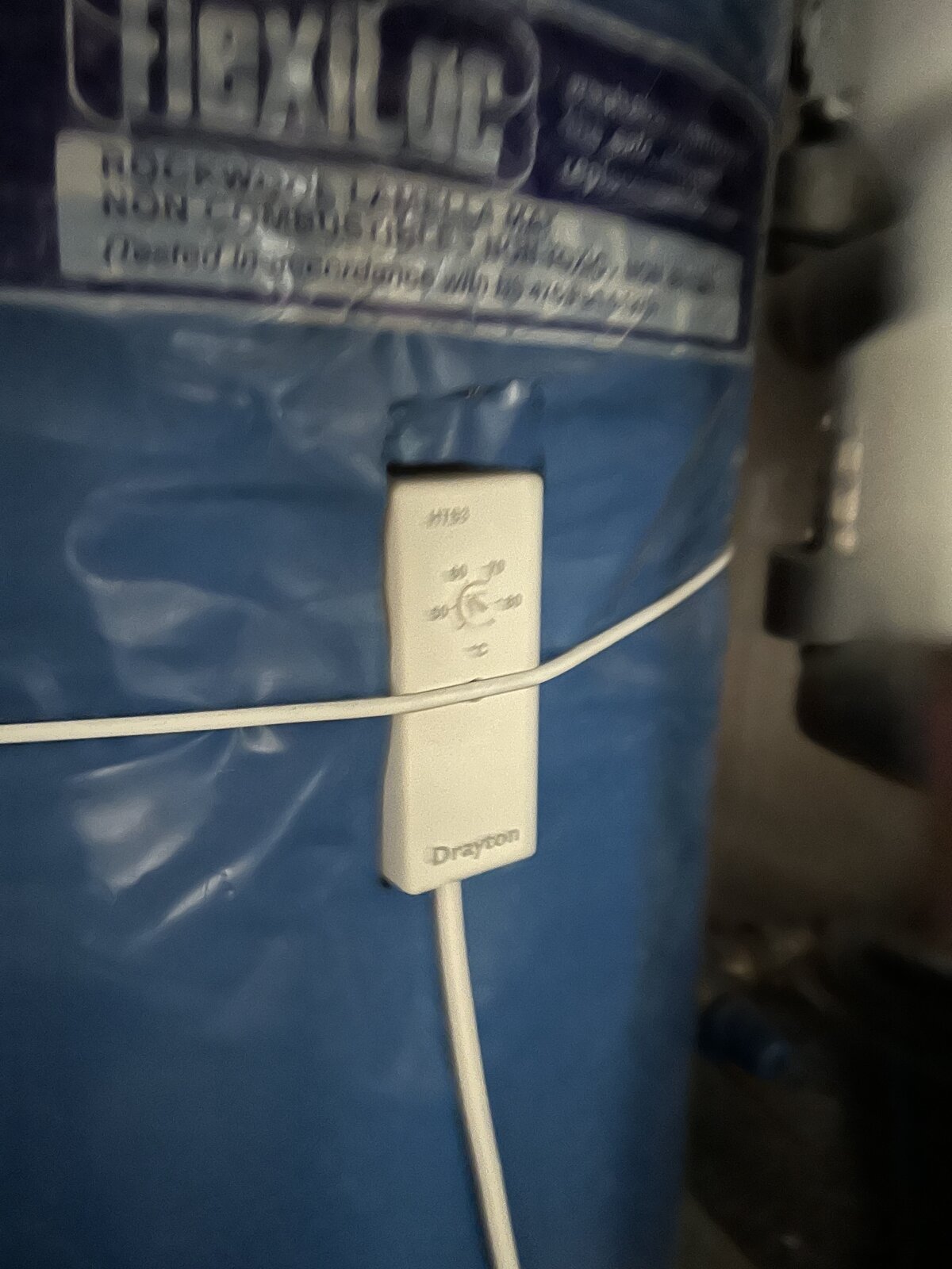

I’m unsure but the original controller had separate CH and HW ‘once/twice/off’ sliders.
Do these images help identify the type of system I have?
I haven’t modified any wiring in the airing cupboard, only on the controller for the new receiver.

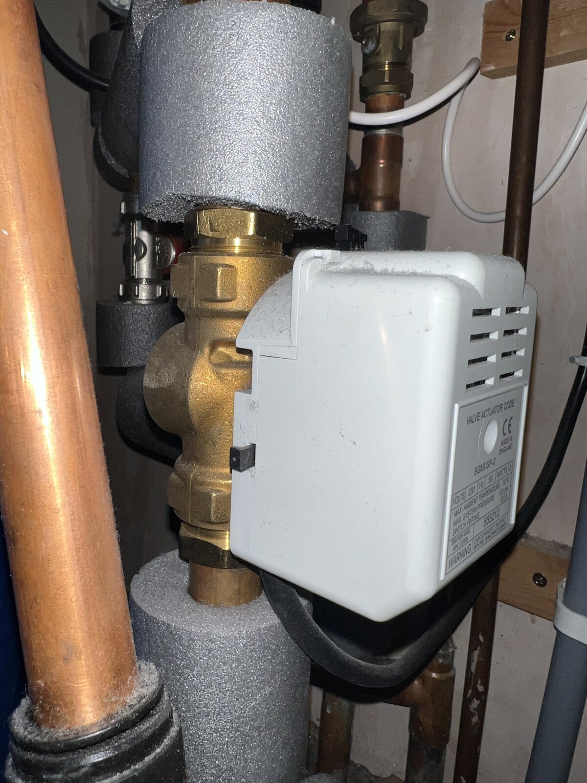

Thanks for the pictures, very helpful. It appears to have a 3-port motorised valve, so all good there. In which case it's most likely to be what is known as a Y-Plan with a mid position valve. However, I can't read what's printed on its head to be 100% sure. I suspect that it's a Drayton 27101SX / MA1
The Tado should have replaced the original programmer, so the wires that went to the old programmer should now go to the Tado receiver instead. The wires in your Tado Receiver are pretty much what I would expect to see, except that with a mid position valve, there should also be a wire in the HW NC terminal as below, which appears to be missing in your photo.

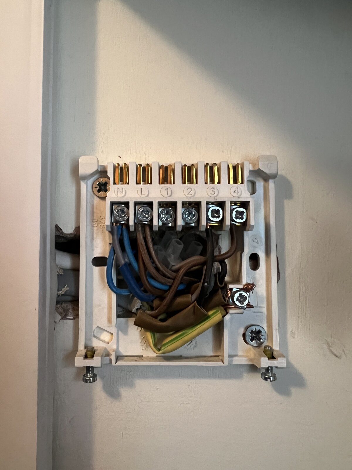

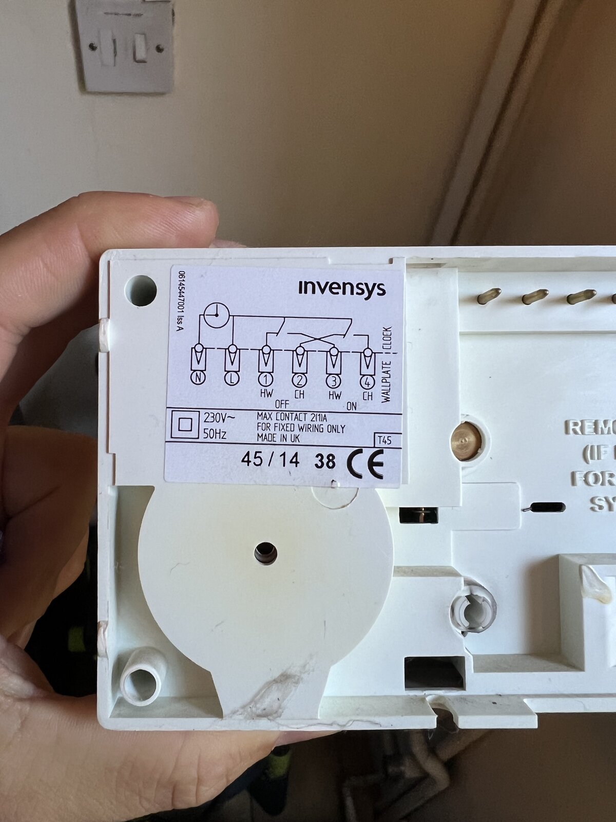

Here’s how the original controller was wired, I’m wondering if the HW NC wire you mention is actually somewhere in the receiver in the airing cupboard by the tank / WR1.
For the time being I have reinstated terminals 1 & 3 in the WR1 and left the old wired thermostat set to 30 degrees / permanently calling for heat. This has stopped the pump being permanently on.
I’ve yet to test the CH however this worked before, with the pump activating and boiler firing when the Tado calls for CH heat.

There doesn't appear to be a wire originally in terminal 1 of the original programmer [HW Off] so there's a mystery.
Can you confirm that the valve is a 3-port (3 pipe connections) and not a 2-port (2 pipe connections)? 2-port valves don't need the HW off connection, but with 2-port valves I would expect there to be at least two of them.
Bridging 1 & 3 at the WR1 would normally be the right thing to do and would take the old wireless thermostat out of service allowing the Tado to take over full control of both time and temperature functions.
However, WR1 is designed to work with a wireless [RF] thermostat, but you also mention a wired thermostat!! If the Drayton RF thermostat with WR1 was supposed to have replaced the wired thermostat in the past, the wired thermostat should have been removed, or at least its switching terminals linked [as you have done at the WR1]
This all seems a bit ad-hoc. Might be time to re-wire it all up again from scratch.

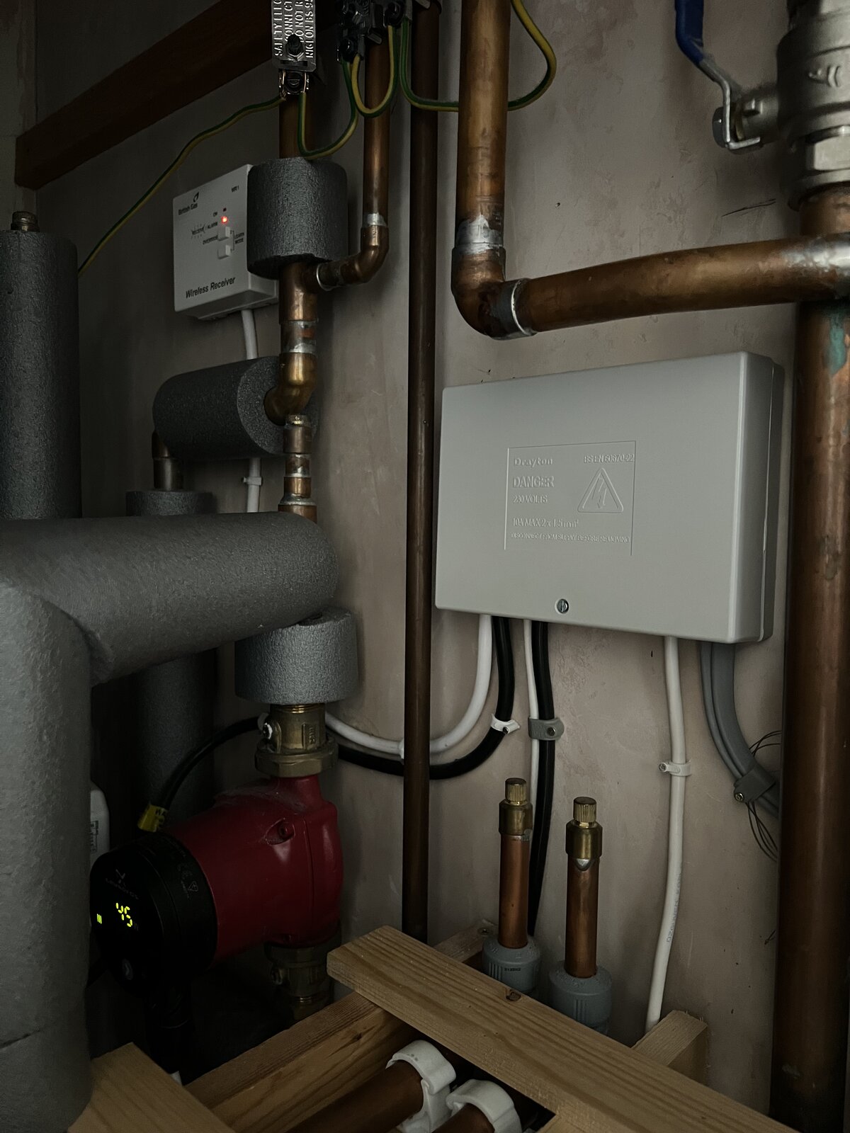

It looks like there are 2 x 2 port.
Sorry, I should have said wireless (not wired!) thermostat!

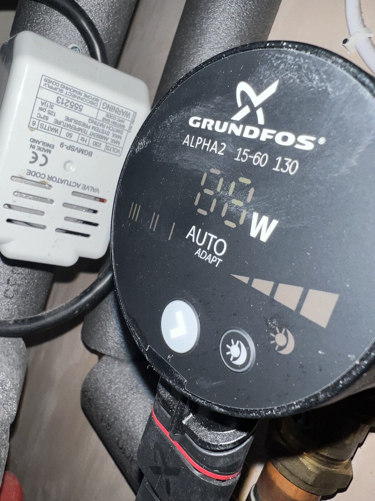

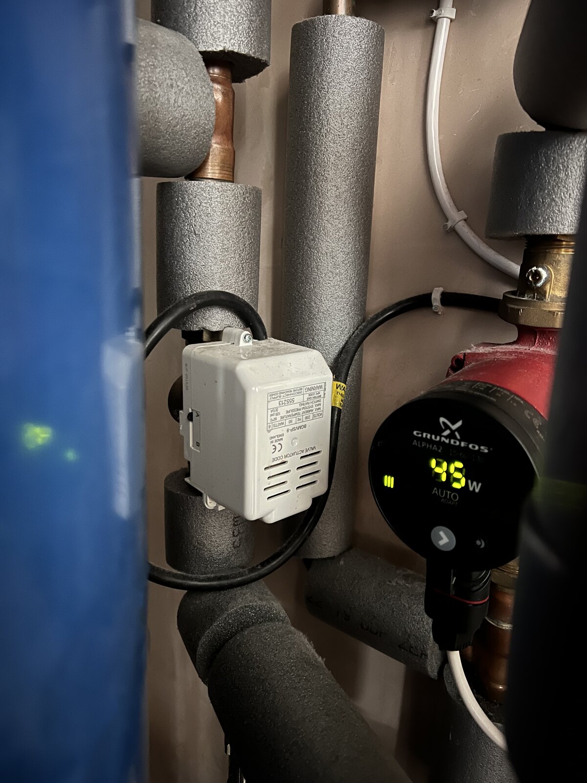

Strangely now this morning the pump for CH seems to be running, with the display showing ‘45’. Yesterday evening having returned wiring on the WR1 to its original state it was not.
When using Tado to call for heat I can hear the actuators moving and valve clicking, the airing cupboard then becomes much more quiet!
My HW schedule is for an hour between 7-8AM.

That makes sense, so you don't need the extra wire then. (y) And the link between WR1 terminals 1 & 3 is correct. Inside the WR1 is a switch that when the room thermostat calls for heat, terminals 1 and 3 are linked together electronically inside the unit. The external wire link just copies what happens inside the unit, so the WR1 being a problem is most likely a red herring.
It sounds to me like you may have a faulty motorised valve. Inside each valve is a microswitch that controls the boiler and pump. The external controls (Tado et al) will simply open and close the two motorised valves (one for HW, and one for CH) as required. Then the small switches inside are operated by the valve when it winds to its fully open position. This is the 'click' you hear. Over time these switches can become intermittent and can stick in the 'on' position even when the valve has closed. Sometimes they work, sometimes they don't. I suspect this is what is happening in your case. The switch is sometimes sticking in the 'on' position and the pump is continuing to run, but because the valve has closed, hot water from the boiler won't be going anywhere. So the boiler will heat up and shut down.

To update this, a local plumber diagnosed a wiring fault. Both 2 port valves are fine.
Must have been historic or at some point something somewhere has been changed creating a permanent live to the pump.
Easiest to re-wire than to try to trace and reverse engineer.

To update this to help anyone else in the future, having also tried replacing the thermistors to no avail I actually removed the L / N from the controls, the boiler then sat in its 'heat' mode completely idle which helped isolate a wiring issue.
I managed to suss out that the feed from the spur and boiler were joined to what I think was the switched live and pump live - either way this is what was creating the demand under the diagnostic menu D.8.
I now find that if I manually open my 2 Port valves correctly the pump does not run which was not the case previously.
There is a slightly longer delay between demand and the boiler firing but *touch wood* it's resolved and now all I'm left with is a genuine air in the system issue.
