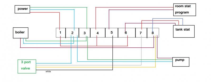

Hi all got a question i need an answer for :)
just moved in to a house that has a hot water tank heated by a boiler with central heating run off it too
there is no programmer for the hot water side of things and would like to fit one as theres no point heating water whilst my and the missus are at work all day
there is a program and a room stat for the central heating but my plan is to replace it with a room stat with a 2ch program to control the CW and HW
the question is how do i wire it in
i have done a diagram of whats in the system and what whires go where
so any help would be great :D
thanks stu

Chances are that to do what you want you'd need to update the plumbing as well as the wiring.
That pic you posted hasn't worked so first things first, take some more of the timer, boiler and any pipework in the airing cupboard and post back.

going by your wiring you have 5 terminals my programmer has 6 :confused:
and also going by your pic there is two wires one on 4 and one on 7 that seem to go nowhere :confused: are they to the room stat?

Ignore the wires on 4 and 7, I just forgot to erase them, you only use hw on, hw off and ch on terminals on the programmer, the wiring diagram on the back of the programmer tells you what wires to put where.
1=HW OFF
2= not used
3= HW ON
4= CH ON
