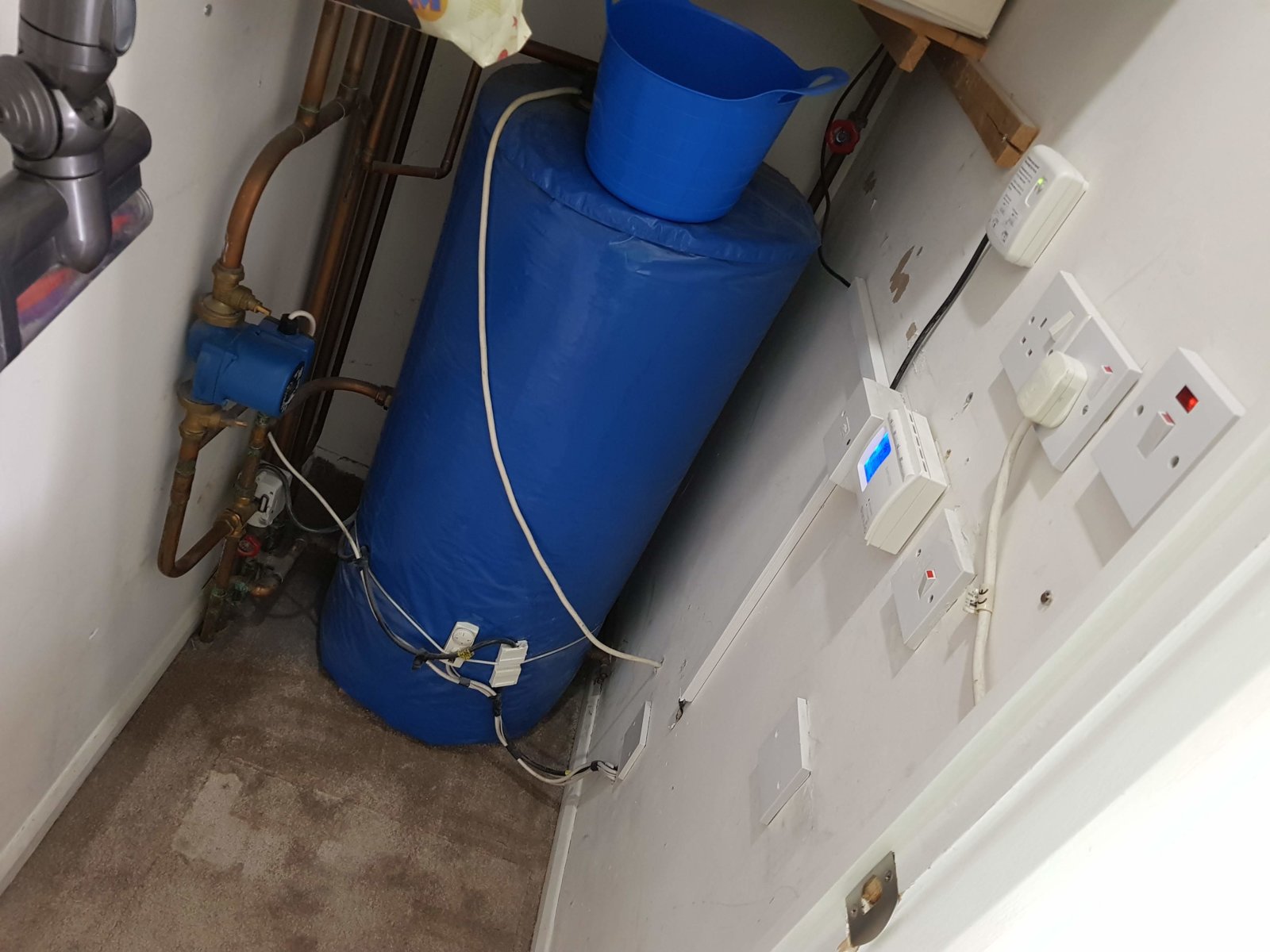

It looks like you have a Dryaton valve, these have a small indicator which shows roughly what position the valve is in, it should be in the W position the same as the one in the photo:
I0310_228408_00
Another test you can do here is to unplug the white 5 pin connector that feeds the valve that is currently strapped to the right of the cylinder thermostat and run the hot water only again. If the radiators are still getting hot either the valve or its motorised actuator are jammed.
The motor head can be removed by pressing in the black button that is currently between the valve and the wall and the head will come away from the valve. The now exposed brass spindle should be reasonably free to rotate, though it only rotates back and forth about 30-45 degrees. If it won't move at all the brass valve body will likely need replacement. If it does move freely it is likely the motorised actuator is jammed or broken internally, quite a common fault.

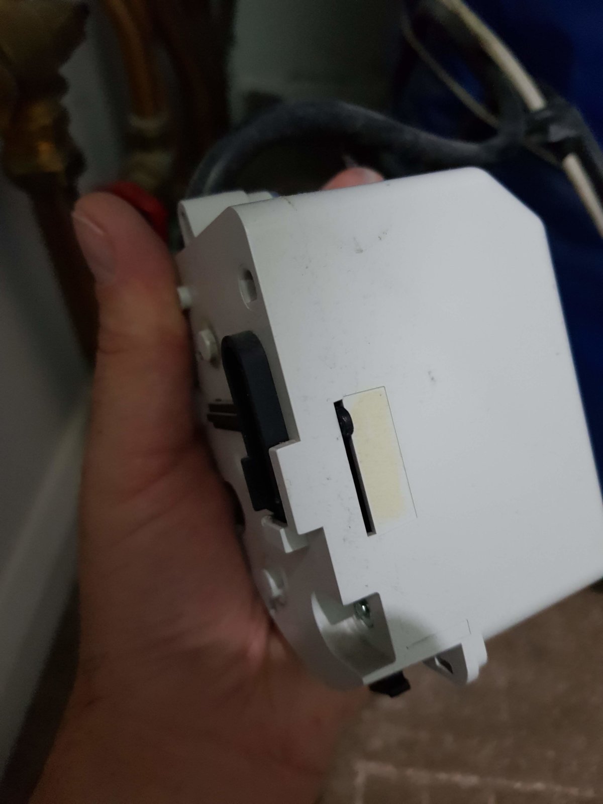

thanks again for a great support and help! here is the picture of the actuator and indicator position
I have unplugged the 5 pin connector and ran HW only, - still rads where getting worm, however I had that actuator removed from the valve.maybe I should have left it on the valve
I tried playing with actuator and rotate the black plastic lever and did see the inside rotated and was coming back to its position itself, at once it felt that it had been stuck but little fiddle and was ok, hope that makes sense
I think(not 100%) that when I tried to rotate the brass spindle, I could not with my hand.
So can I use pliers to rotate brass spindle?
Im away for a week so will follow further instructions and advise on my return, so brass valve body could be a culprit?
or shall I try new actuator?
also what actuator I have
Zone Replacement Valve Actuator Mid-Position Valve Actuator
or
Mid-Position Valve Actuator?
