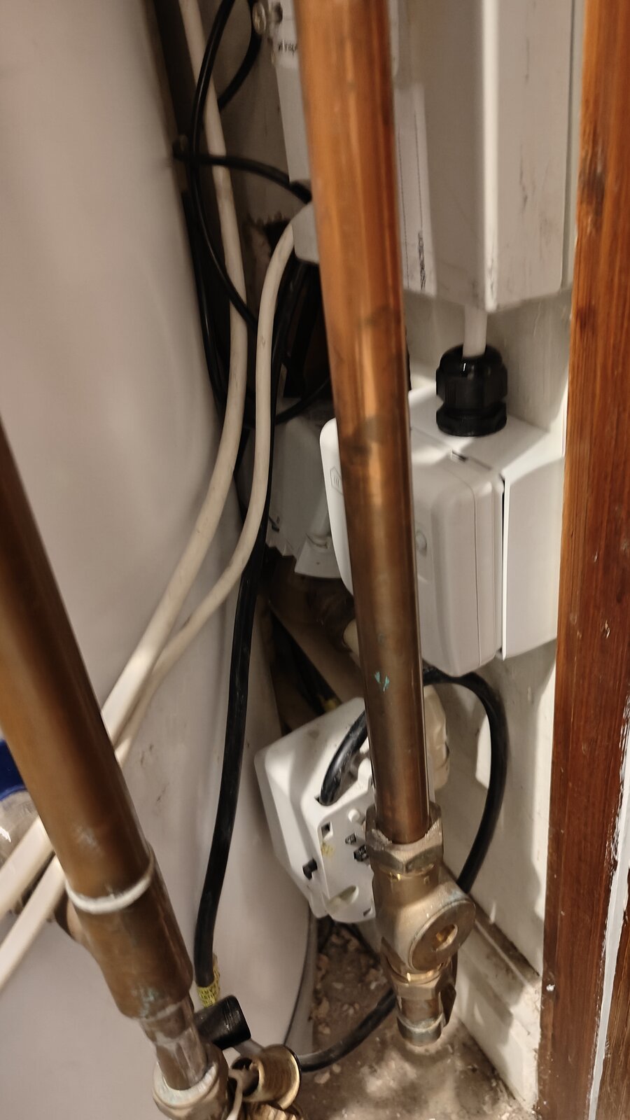

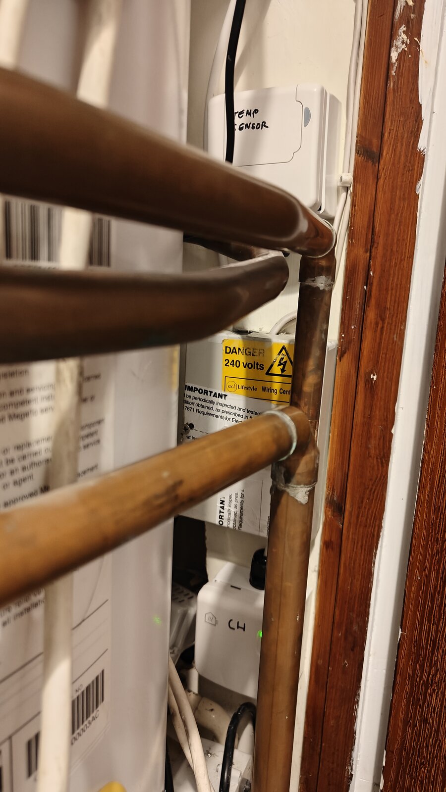

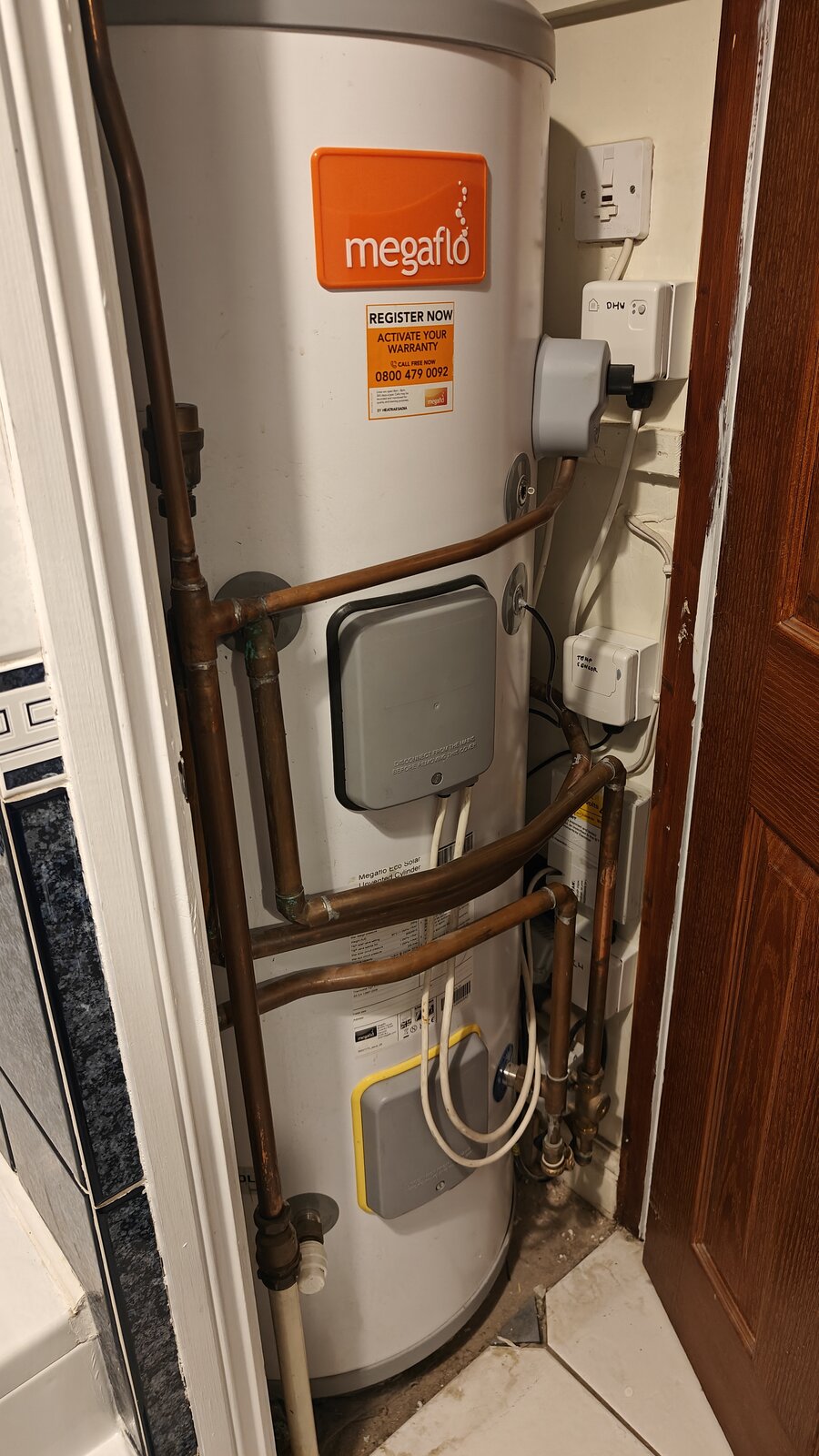

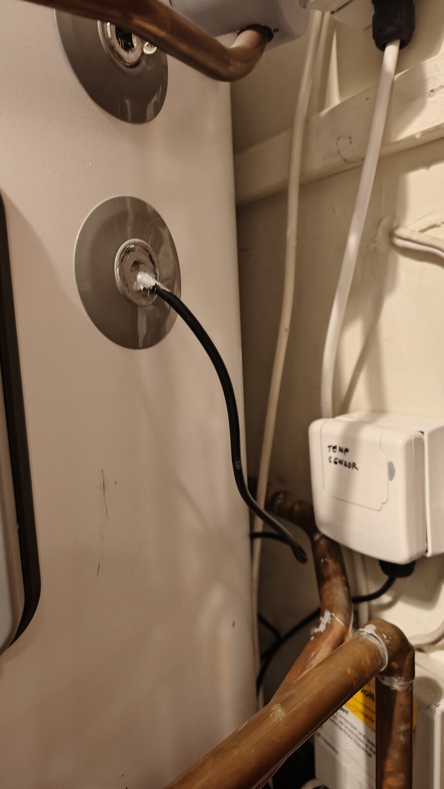

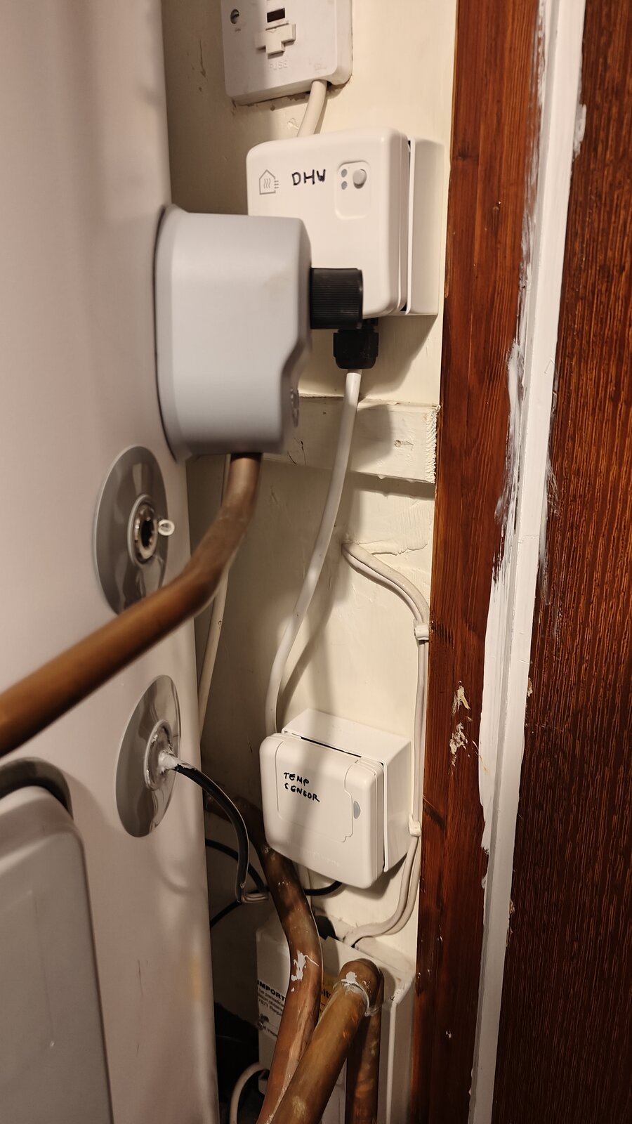

Photos of install below – the BDR91s and the temp sensor are about 300mm apart, the amount of metal in the way could be better but I don’t seem to be getting any comms errors.
People who are lucky enough to have a HW cylinder can have the plumbing arranged so that heated towel-rails, and sometimes bathroom radiators, are heated whenever the cylinder is heated, typically during and after a bath or shower, which is the ideal time. This is a superior design.
You can identify such an arrangement by inspecting the pipework, or by experiment and feeling the pipe warm up.
Worn-out motorised valves can also let hot water leak through when they ought to be shut. You can identify this by feeling the pipes next to the valves.

You would have to inspect the plumbing to see if it is by design or due to leaky valves or other fault.

On mine the take-off is just before the 3 port valve, and visible. I do like to add descriptive labels.

I have a very similar version as your described. It is a new house and has been plumbed so that the 2 bathroom towel rails are across the flow and return of the boiler. This means that whenever the boiler is ON then so are these towel rails even if the CH or HW valves are closed. They effectively provide a bypass across the boiler. I have manual TRVs on these so that I can turn them off in the summer if necessary. To change the arrangement you would need to change the pipework.

Possibly reverse circulation through the 2 rads when DHW is running. Check that cylinder is final connection on return pipe to boiler.
