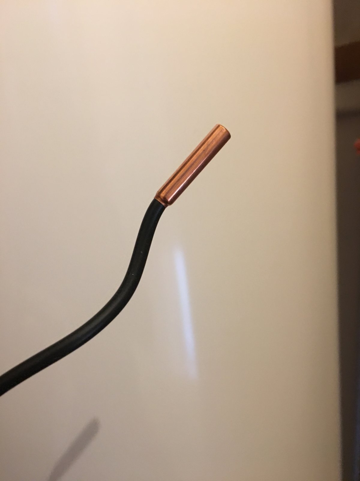

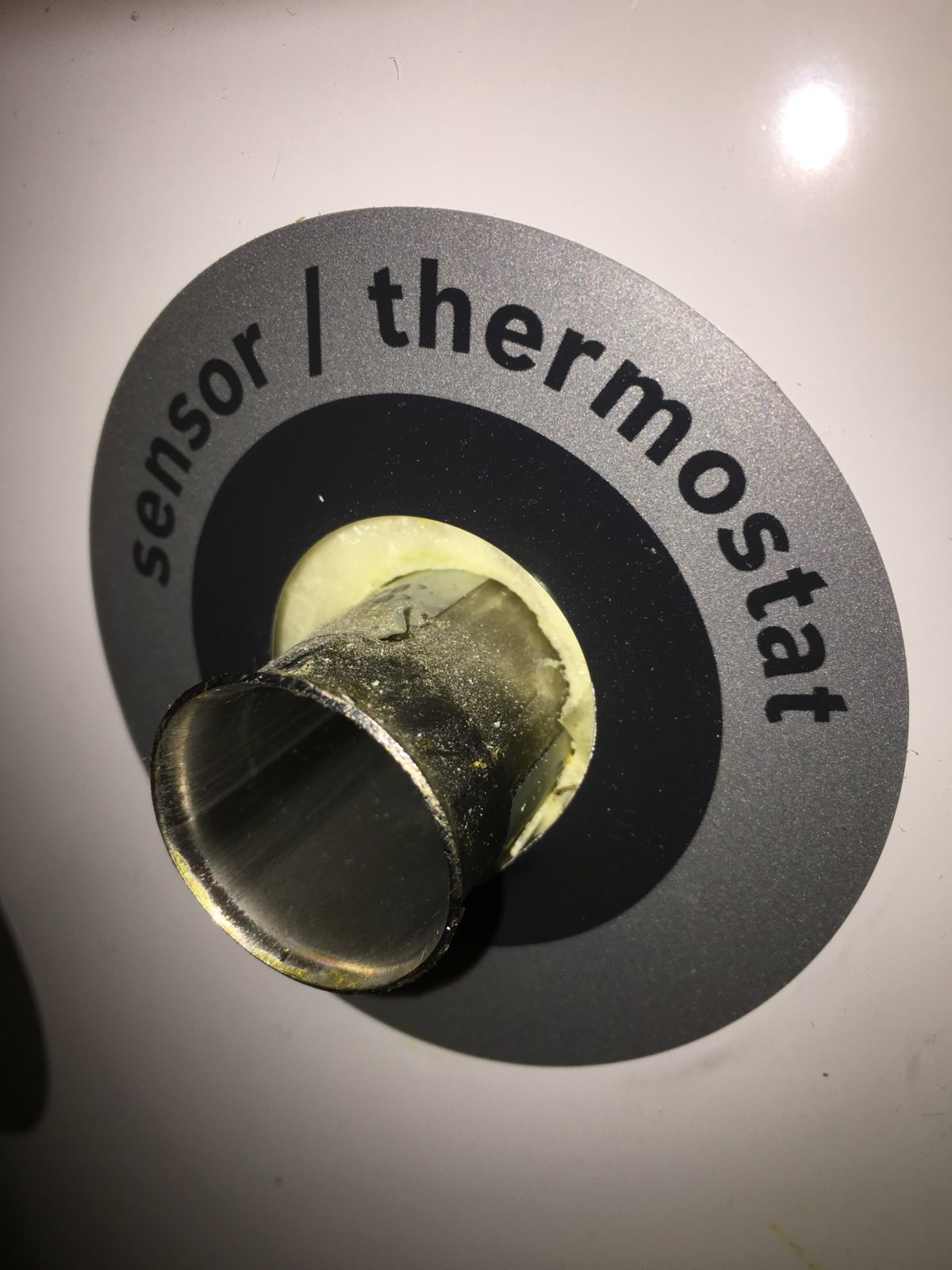

Hi all,
Hoping you can offer some advice.
My heating system consists of a Worcester Greenstar 24ri and a Worcester Greenstore unvented DHW cylinder in a S Plan system.
I have recently installed an Evohome system, so am controlling both zone valves via wireless relays (BDR91s) and using a wireless thermostat to report the hot water temperature to the evohome controller.
Please note, I have retained the original duel stat. This has been wired in series with the evohome stat to ensure the duel stat relay must be closed for power to be supplied to the zone valve. Temperature settings are 65 degC on the duel stat and 60 degC on the evohome. This has been tested and functioning, reducing the temperature set point on both stats cuts power to the zone valve.
The system is functioning perfectly and as expected, but I would like to get some advice on the best method to secure the evohome stat in the sensor pocket of my Greenstore cylinder (this model has both an upper and lower sensor pocket).
Many thanks in advance,
Craig

Hi not at home at the moment so no can’t do on the photo.
The cylinder is completely as installed with the duel stat in the lower pocket. I have temporarily secured the evo stat in the upper sensor pocket (obviously will read a higher temp in this location - ideally if this is the control stat it should be in the lower pocket). Duel stat is in control as I am not comfortable with this fixing.
With respect to the wiring, I had to trace all the connections as the system was wired in a completely non standard fashion I.e neutrals in 1, CPC in 10, boiler SL from the zone valves in 5 etc. Etc.
I’ve left this mostly alone as I didn’t feel the need to ‘fiddle’ overly.
For the DHW circuit, SL from the programmer originally came in at 7, duel stat at 7 and 6 for the BR to the DHW zone valve. I have moved the live from the programmer to a spare connection at 8 and connected my wireless relay at 8 and 7, so stats wired in series and no electrics or hardware for the UV cylinder touched at all.
Please find attached photos of he sensor well and evo stat.
Thabks
