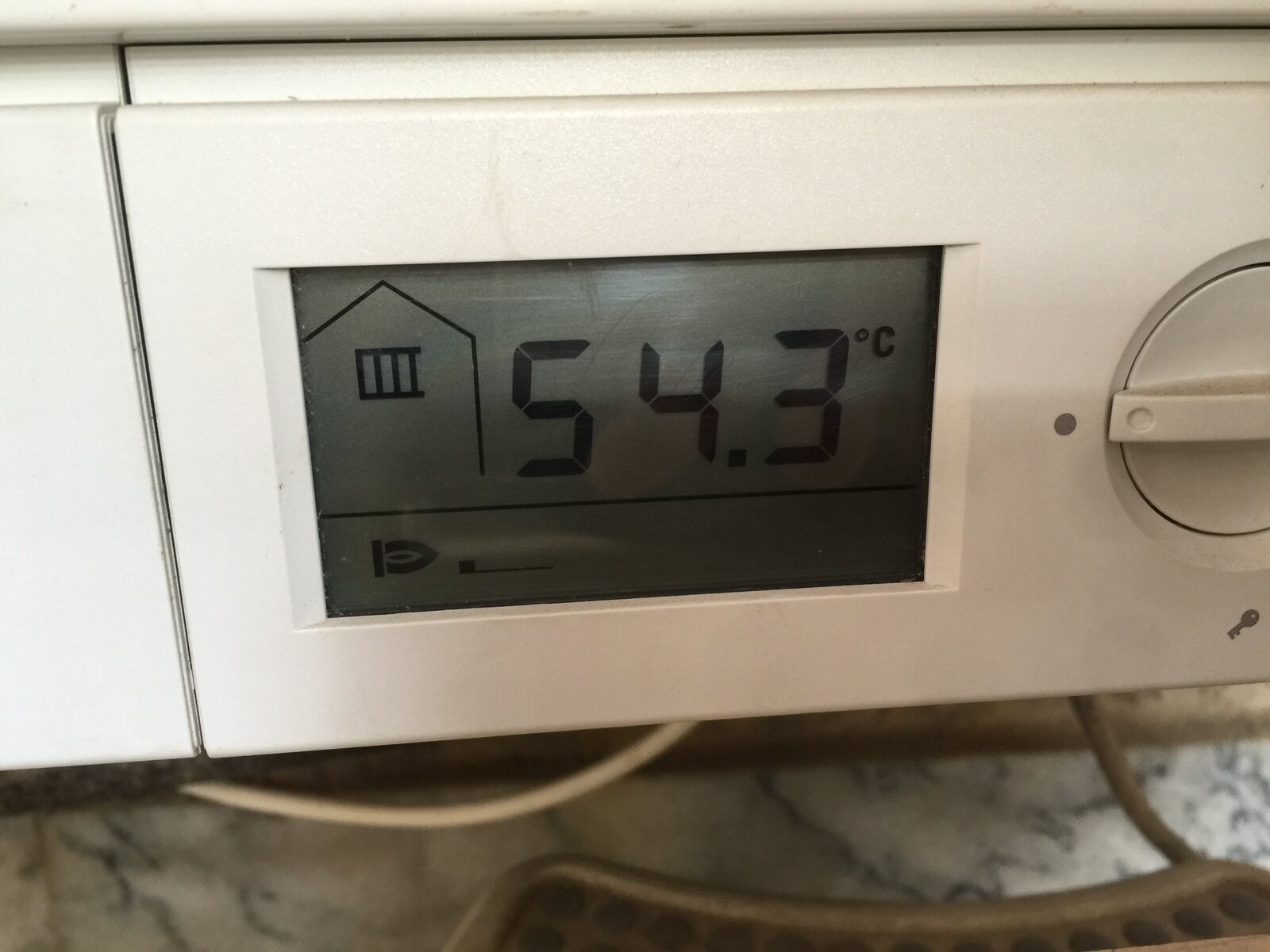

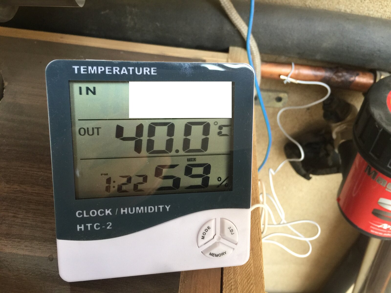

Hi,
My viessmann heat only boiler 13kw (OV) is running at flow temp of 54.5DegC and a return temperature of 40DegC. I know it is a crude way of getting the return temperature on boiler. In the 2nd picture showing the return temperature you can spot the sensor attached to return pipe next to filter.

Flow temperature on boiler was 54.3 DegC and a return temperature of 40DegC.
I am running boiler at 54.3+40=94.3/2. Thermostat is set at 19 DegC (and is installed in the coldest area of the property; lounge which was not heated during this time) so my radiators are effectively rated at 28.5DegC, Correct?
This means my boiler is only 55% efficient, I don't understand, there must be something wrong somehere, Could someone please advise what am I doing wrong.
Flow temperature dial is set just below the delivered condition (pic 3). It used to get to 49.5-50DegC at this setting and would turn off at that temperature. Outside temperature has dropped couple of degrees due to a cold wave during the last couple of days (where I live).

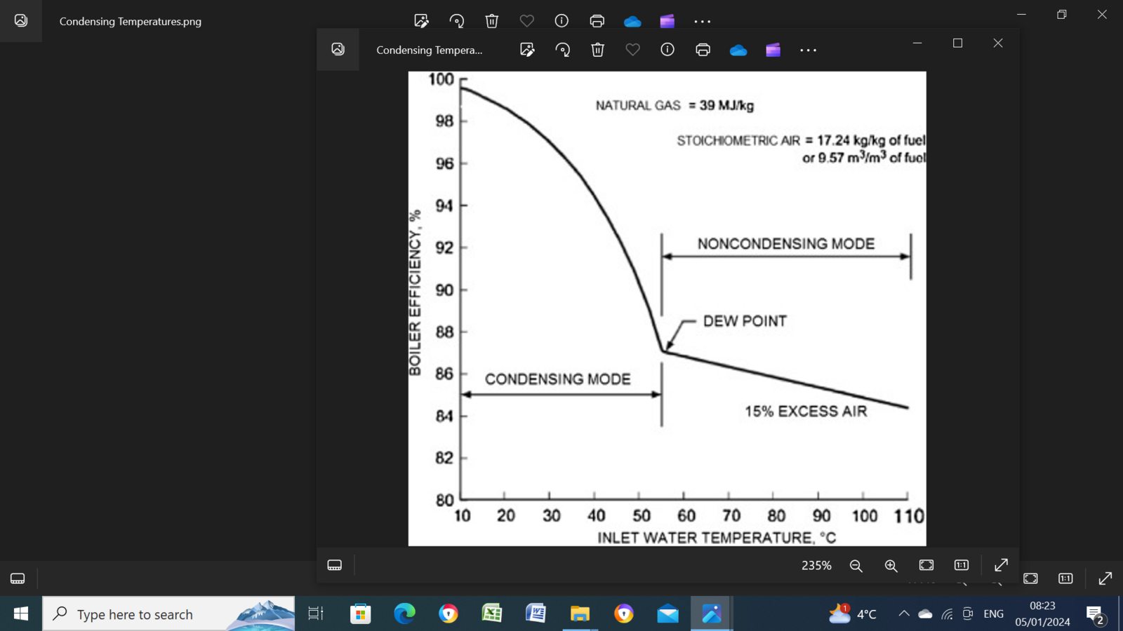

Its almost impossible IMO to measure boiler efficiency using the rads as a accurate indication of load due to flow temperatures, different flowrates through each rad unless perfectly balanced etc.
Your best bet is definitely using the boilers own data and as I stated above, the flue gas temperature which alone will be quite enough to enable the efficiency to be determined even using the simple graph, below, even though this doesn't use the fluegas temperature, measuring the condensate flow is also very helpful and of course the natgas consumption.
At 40C return temp, the boiler is ~ 95% efficient.
