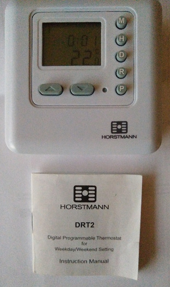

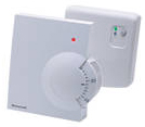

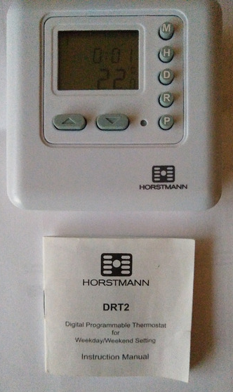

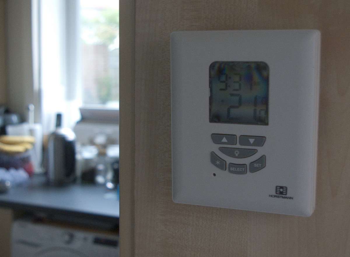

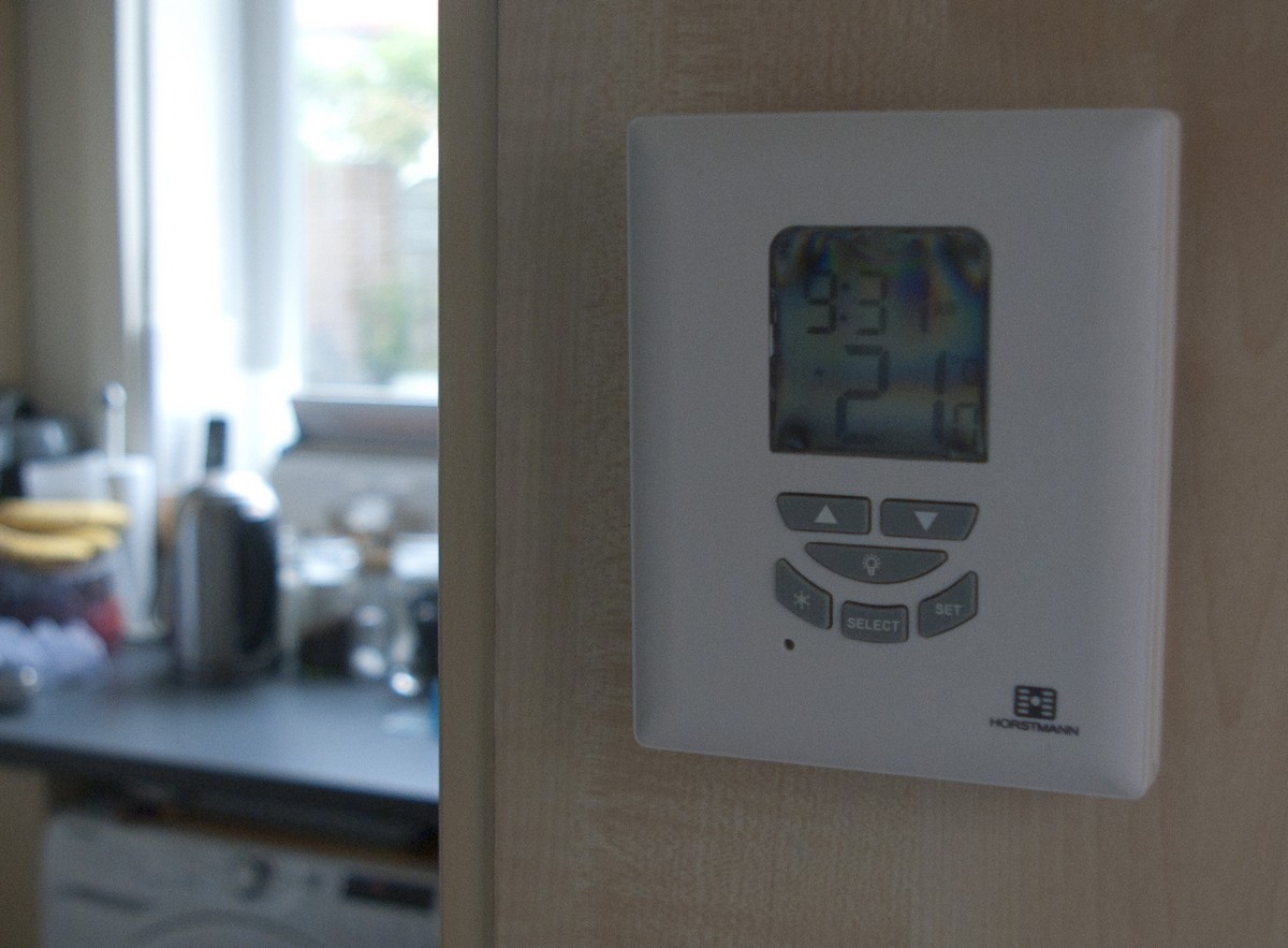

I found the Horstmann IMGP8037.jpg lost its RF link, also sold under many other names, the DT2 hard wired Horstmann upload_2021-6-24_23-24-52.png was however very good until battery contacts went after 10 years replaced with ae235.jpg which technically is better but I had to refer to manual each time I wanted to alter it, not intuitive like Horstmann.

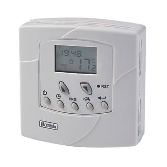

But all depends on boiler, this 84067_P.jpg thermostat was very good, it had a auto shut down if RF link lost and also used a mark/space switching to stop over shooting, so as it approached target temperature it would start switching off and on.
