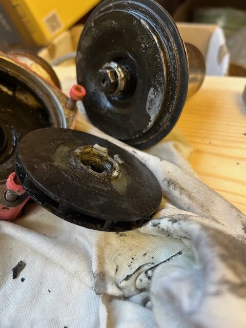

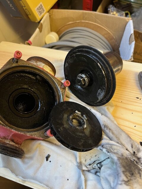

I dug further, removed the fan and got the bottom of the issue, broken plastic bits from fan which cause the grinding noises on its last day of operation, assume wear and tear of the material after 23 years plus. The whole impeller is free of sludge or curd which is good news. On the plate there are numbers, 9913 so possibly manufactured in week 13 of 1999

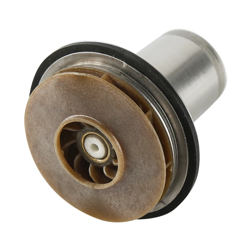

Interesting. It looks as if the impeller fell off without undoing the bolt. Not surprising it was noisy! It's clearly beyond repair apart from replacing the complete rotor. That looks a bit Chinese but might be OK. I assume you're not considering that now the pump has been replaced.
BTW it's not a fan, it doesn't have one.

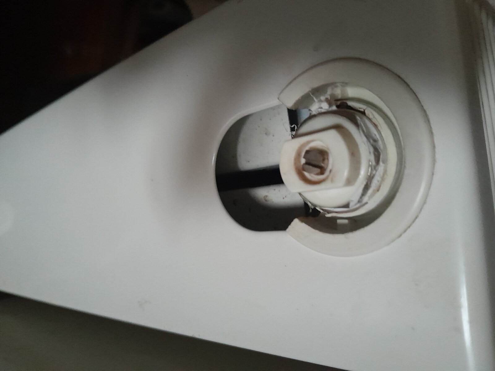

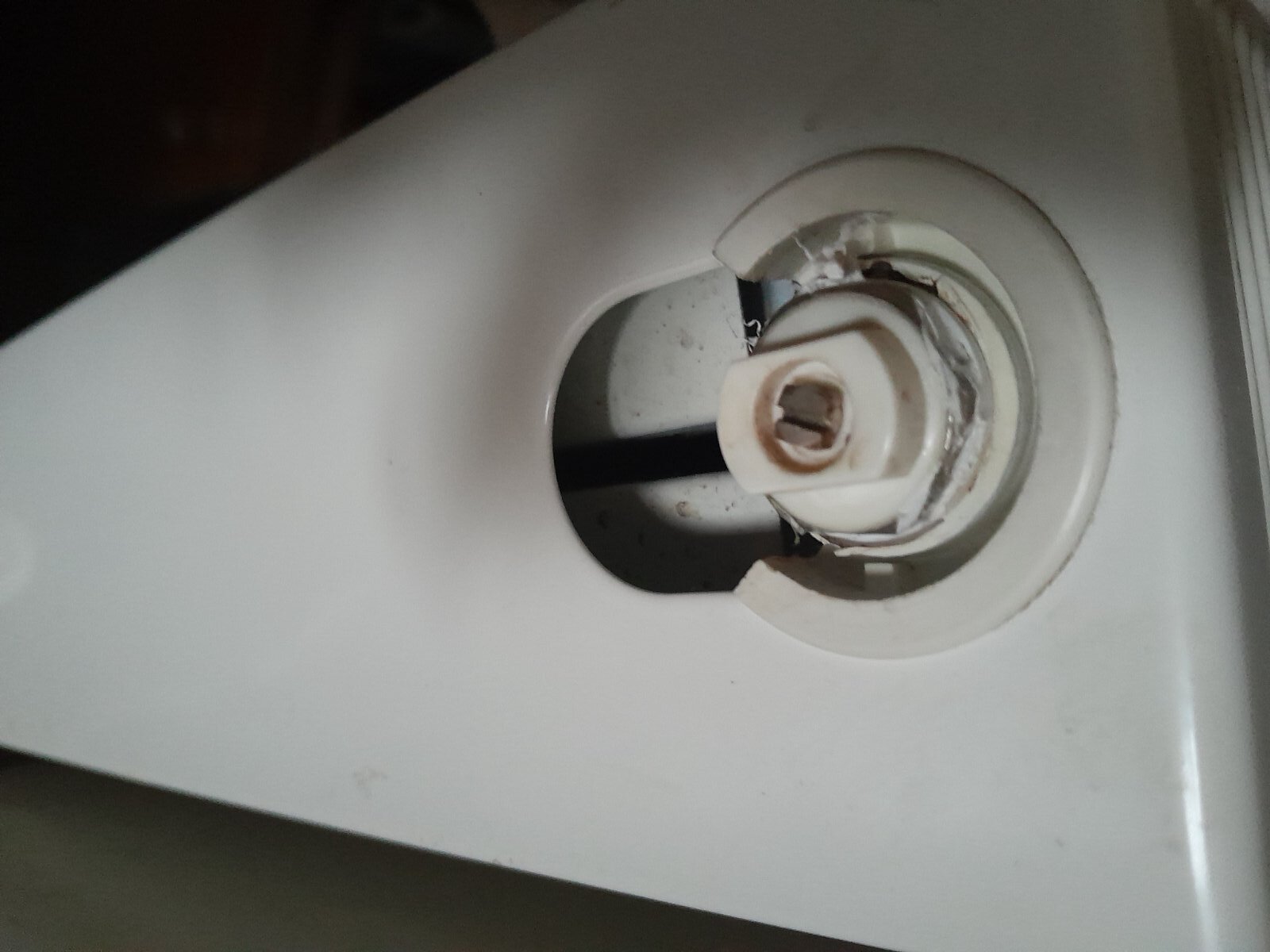

If you have a double rad like the one shown with a air vent at (the top) on one end and a blank 15mm plug on the other end, the most economical way of adding inhibitor is to close both rad valves, open the air vent to ensure valves are tight, then slacken one of the nuts a few turns where one of the valves is attached to the rad, pull back a bit on the pipe and drainn off slightly more than the container of inhibitor, then retighten that nut, remove both 15mm vents (one a blank) where they screw into the rad, get a 15mm elbow, wrap a few turns of PTFE tape around one end, screw it in by hand at one end, get a small funnel or if a steady hand just pour the inhibitor into the rad, replace both vent plugs, open one rad valve a little to vent the tiny amount of air, shut the vent, open both valves and you're back in business.
Your system is quite clean, much like my > 50 year old open vent system, can you see sometime what vent and (cold) feed arrangement you've got.
