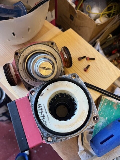

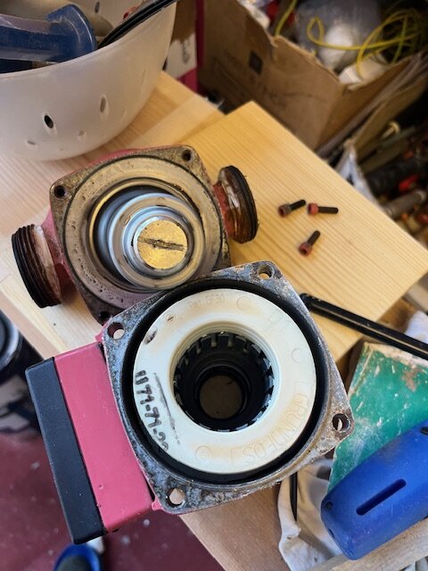

I hope you've kept the old pump. If so why not dismantle it, easy to do on the bench, and tell us if there are any obvious faults, eg blocked impeller.
Yes I have kept the old, will dismantle may be in the weekend, will post photos.
According the installer, implied it was dead, 240v was getting boiler kicking but nothing happening, will find out hopefully when dismantled.

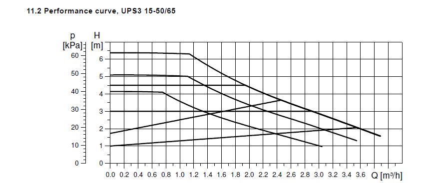

A ABV will only work to a fashion in these A Rated pumps because as is well known, none have true fixedspeed/constantcurve modes, the UPS3 is the very "worst" one in this regard, see below. On the choosen fixed speed II, the head only falls by ~ 0.15M between no flow and almost 0.8m3/hr, 13.3LPM which will satisfy the full flow demand of a 14kW system at a dT of 15C. You are as well off IMO with that throttled service valve if you set it up as I suggested. A constant bypass of say 2.5LPM will only raise the boiler return temperature by 2 to 4C. But first, check, again as suggested, that the pump does overrun for a short period when the boiler shuts down.

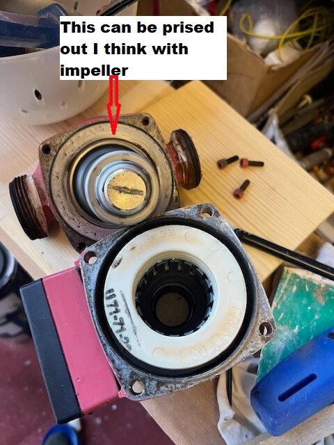

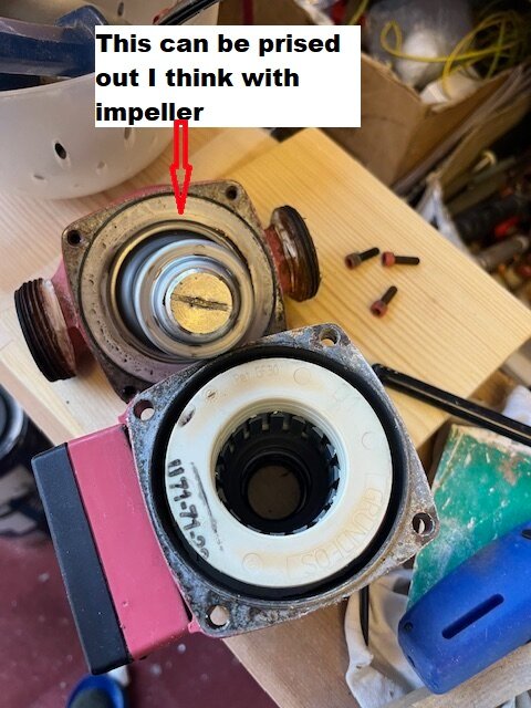

You should be able I think, to remove the impeller assy. where arrowed.
I took off the 4 hex keys, what to look for?

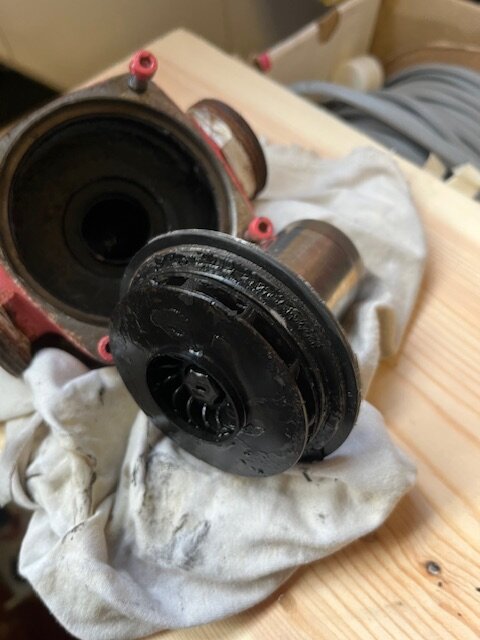

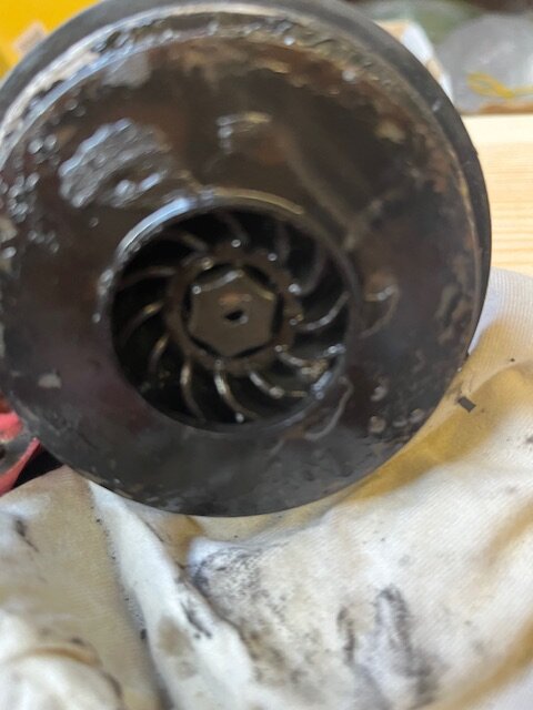

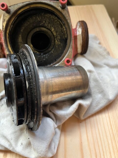

I managed to remove the impeller, there is no blockage in the veins BUT the fan is not turning freely meaning the grinding noise I heard last time was working was when internal components got damaged?! photo below, it is repairable with new impeller from Ali express for under £40.
