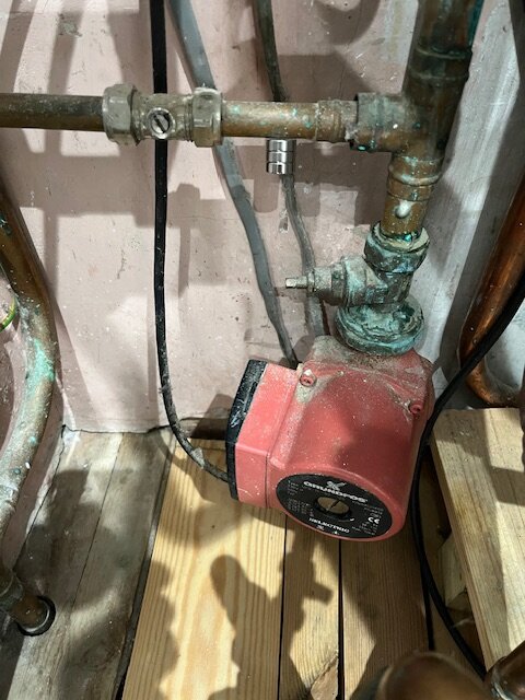

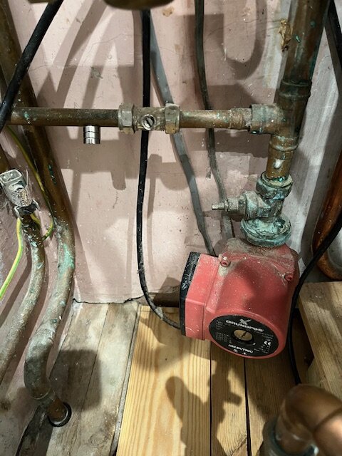

Thanks I will do it on Saturday. Two observations, re photos attached:
1. The magnet is sticking to the copper pipes, does it mean anything?
2. There is a service valve open only half way from day one, does it matter?

Magnet sticking to pipework = crud than needs to be removed.
The valve appears to be a bypass don't touch it will leak for fun.
magnets sticking to more than one pipe, 15mm and 22m pipes, how to remove crud, manual flush?

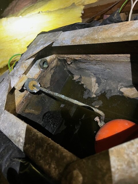

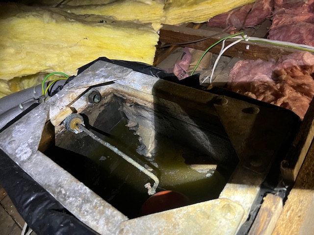

Update:
I turned off the cold feed to the header F&E tank, drain from ground floor drain valve for good 5 mins, went to the loft, water level in header tank down to third; pls see pic below.
Verdict?

Assuming the level was higher than that before you did it, it shows the cold feed pipe isn't blocked
