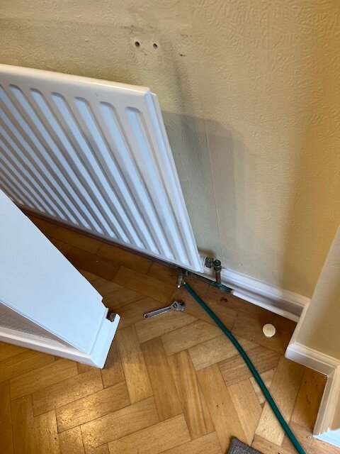

did you look at the level before draining ? 5 minutes would drop the tank by more than a third
The tank was full, by the dry line. The flow rate of drained water as per photo above.

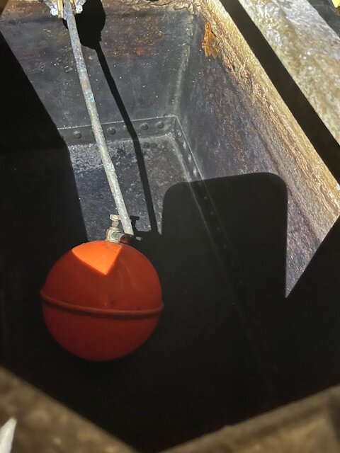

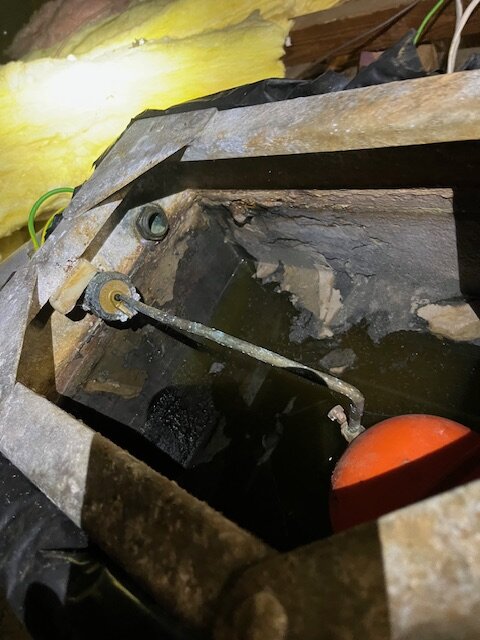

Update:
I turned off the cold feed to the header F&E tank, drain from ground floor drain valve for good 5 mins, went to the loft, water level in header tank down to third; pls see pic below.
Verdict?

The tank was emptied from same rad drain point as before, the remaining water removed and cleaned thoroughly; there were metal bits at the bottom.

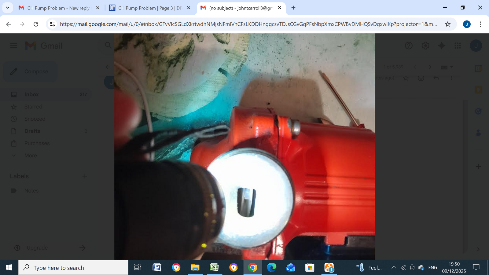

I haven't done anything since; few questions:
1. With hot water or central heating selected, would the pump turn if boiler not firing? IE: does the pump turn only when boiler is firing?
2. Can I test the operation of the pump without taking it apart? ie: by taking the middle silver screw and see if pump turning?

The pump should run anytime there is a call for heat from the boiler, the pump may or may not continue running if the boiler cuts/trips out,..
You can see if the pump impeller is rotating by taking out that centre screw, just hold a cloth underneath it when you remove the screw, you might be able to see the end of the pump shaft, may require a torch of stick something like a reversed pencil into the pump to feel the shaft rotating (or not).
