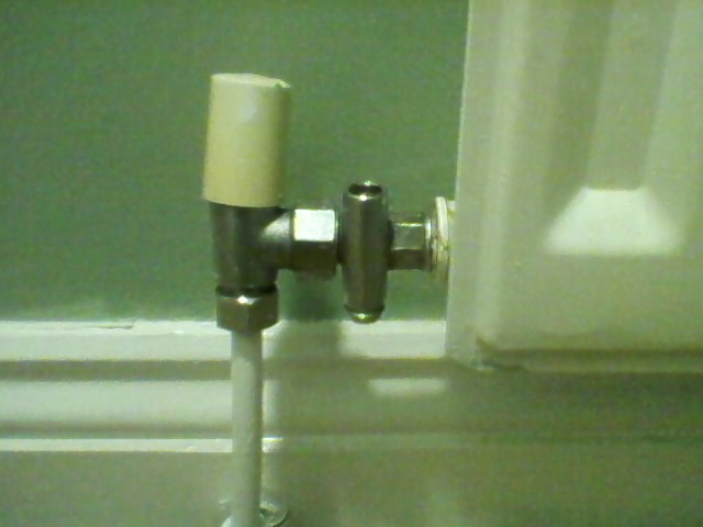

This is the type of connector on the rads, the copper pipe being 15mm. The other side of the rads have Thermostat valves.
full
It would be wise to change those valves for the type that have a drain cock incorporated
That's my intention. Will need to fit x2, one for the solo fed rad and one to the two rads connected by pipework.
