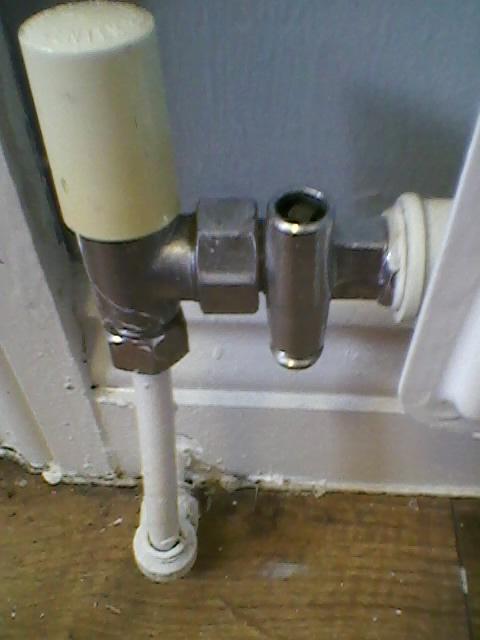

I'm on draining the system and it seems the downstairs rads are all fed from vertical pipes from above since the all have drain valves fitted. I got a radiator key from Screwfix buts its a slack on the drain valves and can't loosen one valve. Is there a better key to be had?

They usually need a Lockshield valve key -

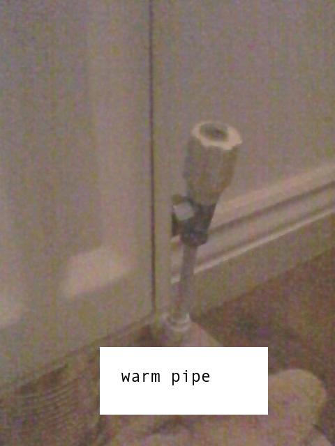

One rad is getting lukewarm but one pipe connection is cold while the other side is warm. The bother is, that's the one I put the cleaner in so it ain't going to circulate till I get the stuck shut valve open.

TRV's sometimes get stuck in closed position. Remove the actuator head ,and check the pin in the valve body moves freely up and down a few millimetres.

The rad getting lukewarm is the only one without a TRV.

Close every other radiator down ,by their TRV ,see if the one without TRV now heats up fully.

I now have heat at radiators that were cold but I'm going to fit a TRV to the rad, shown above, that hasn't got one. I presume the 10mm versions sold at SF are suitable. Its a Myson rad.

There may be a reason that one radiator was not fitted with a TRV , may be best left as it is.

I've looked into this and it seems it could be a by-pass rad. If all other rads are closed, the boiler pump doesn't burn out if the CH is switched on.

Really depends on the boiler and whether it has an internal bypass, that being said never a bad idea to have a rad that allows flow through the boiler, as long as it's never turned off, that's why there should really be 2 lockshields to make it tamper resistant.
